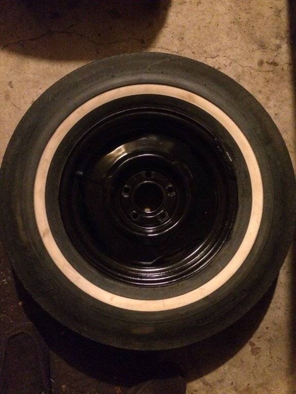

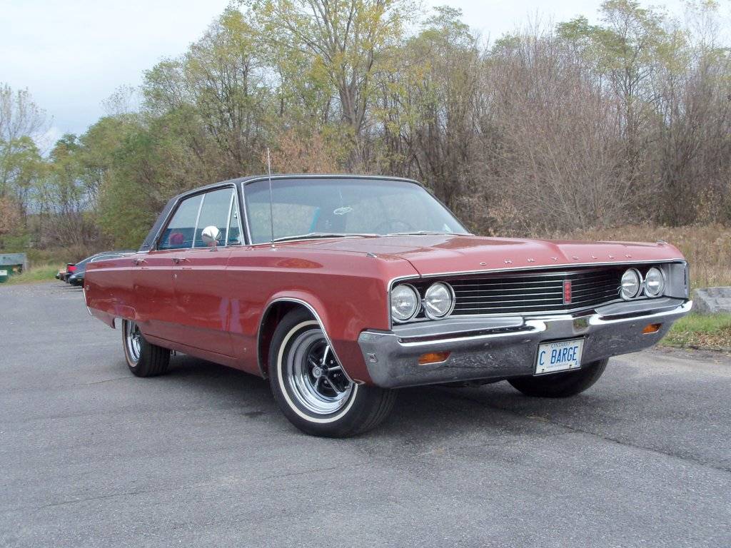

If you're looking for improved handling and steering response, stay with the P215/75R-15 tires and get some 7" rims for the car. I have that combination on my '80 Newport (using Magnum GT wheels) and it surprised me. What happens is that the sidewalls are more vertical when installed on that wider rim width and that relates to quicker steering response, as there is less flex in the sidewall. With the wider rim width, that also opens up the possibility of using P225/70R-15 tires (some are still in WW, most in RWL), if desired. But after I discovered the benefits of the wider rim on my '80 Newport and the stock spec P215s, I saw no need to get the wider tires later on. Saving money and enjoyint the ride more!

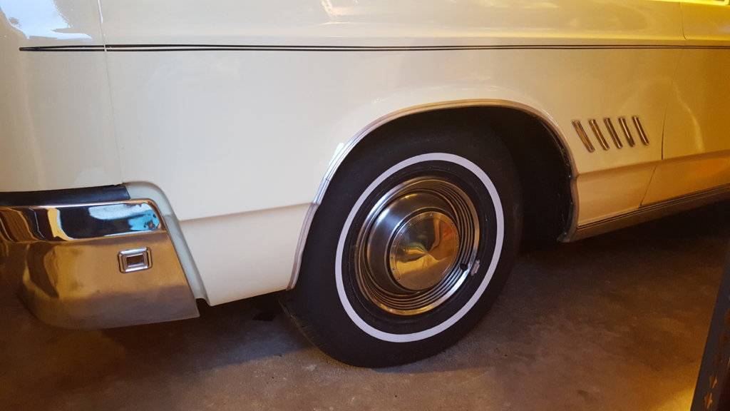

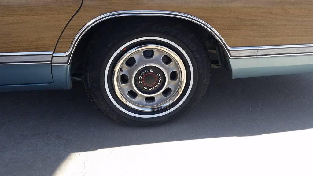

Just like these
I thought C-Fusies usually had 225/75 while Imperials and Town & Country of the same era sported 235/75....or am I mistaken? Thanks
I decided to go original with the white walls so I'm going with the Hankook Optimo 724. I couldn't resist the pricing.
