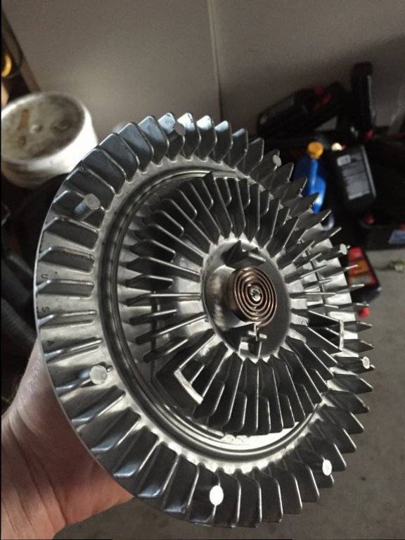

As for the operating temp/ cooling system I have a 26 in radiator with a shroud on a 7 blade fan with a fan clutch. Increased temp happening on highway not in traffic. Fan clutch replacement ?
OK, you got plenty fan and its heating up on the highway. Do you have a thermal fan clutch or one which is just speed activated? Normally, if you have a weak fan, the motor would cool off when rolling into some air at speed. I wonder if the water pump is going south on you.
Old fan clutch
New fan clutch that is thermal. Can't tell if the original is though I see no spring
