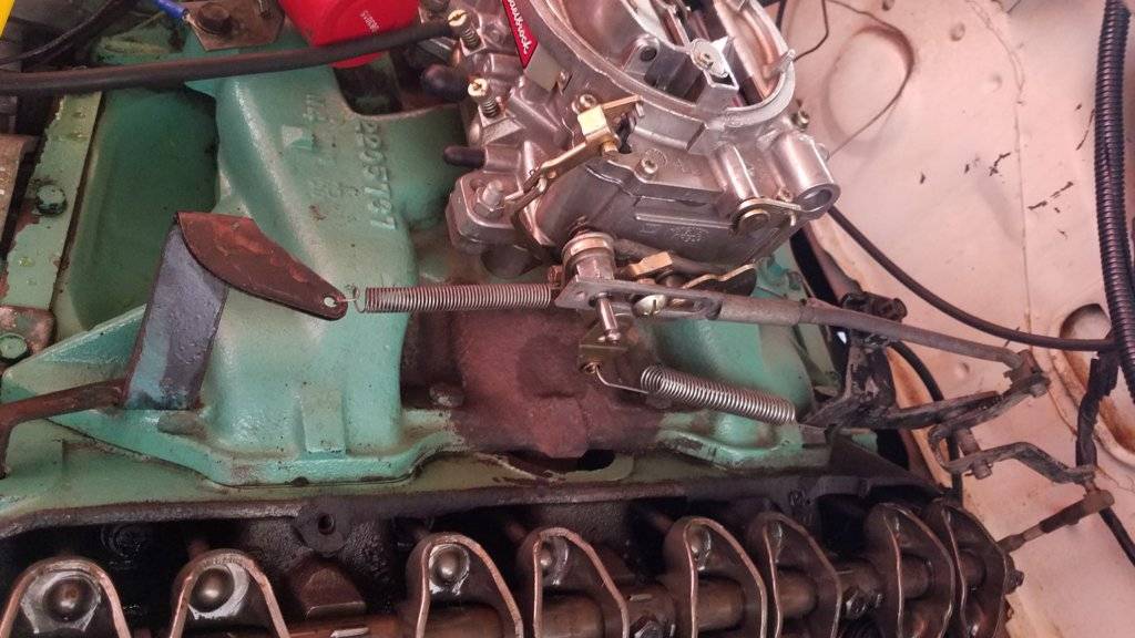

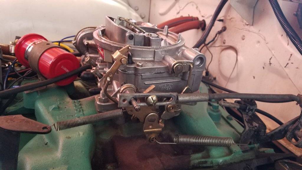

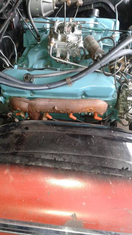

This was my 2bb setup

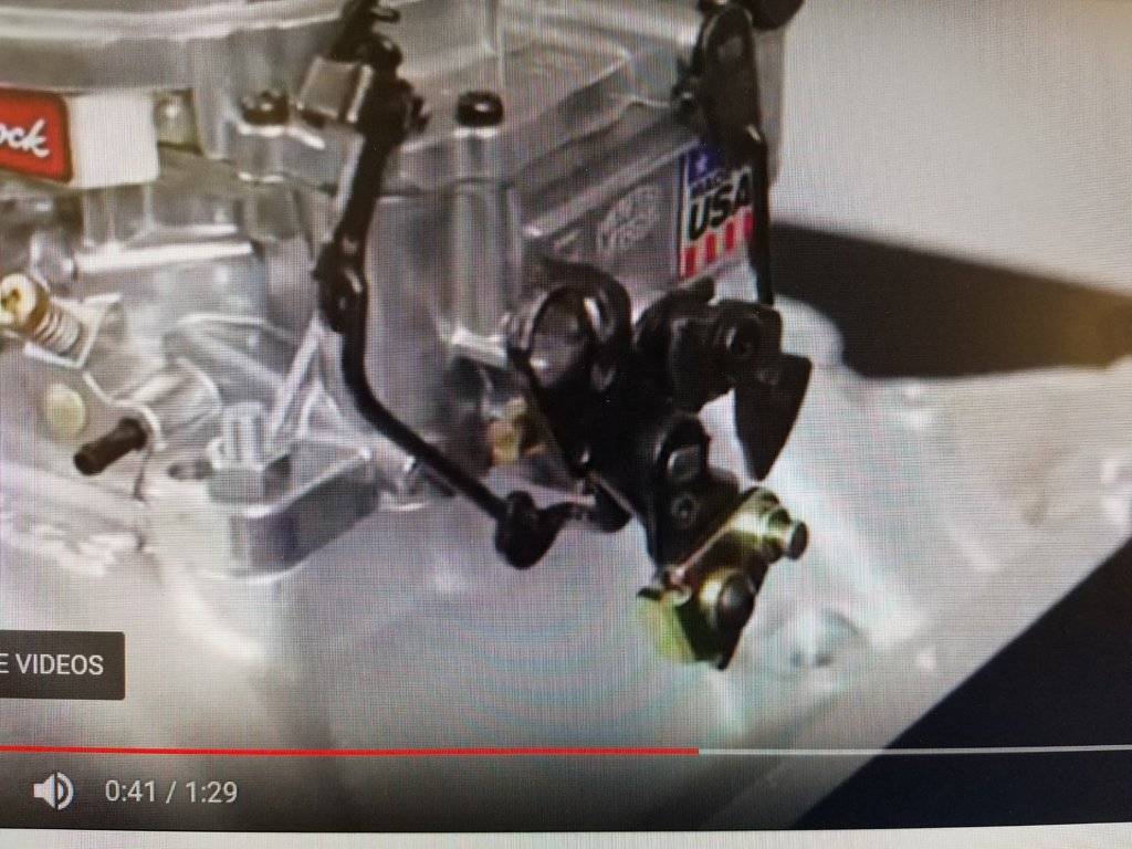

Really shoot, I haven't a clue what to do. Traintech do you have a photo of what it should look like? Yes the car came that away and it's a 4 barrel carb on a 2 barrels intake. I did buy the big block mopar book and will look through that as well

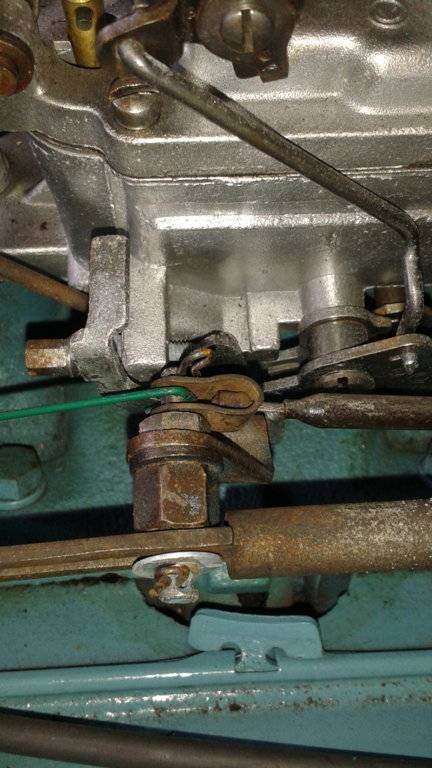

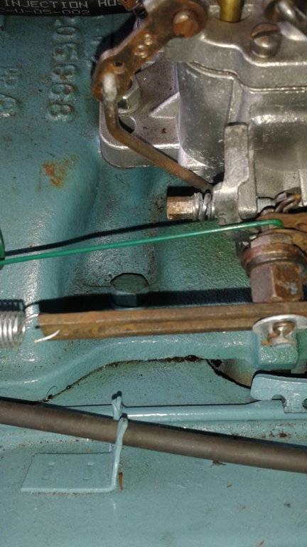

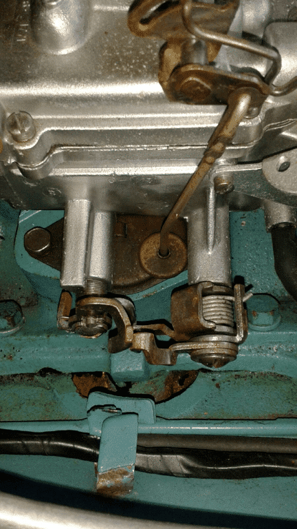

Here are some pics of my 1966 300, factory 383 4bbl. The adapter bolts on to the carb and puts the linkage in the correct place.

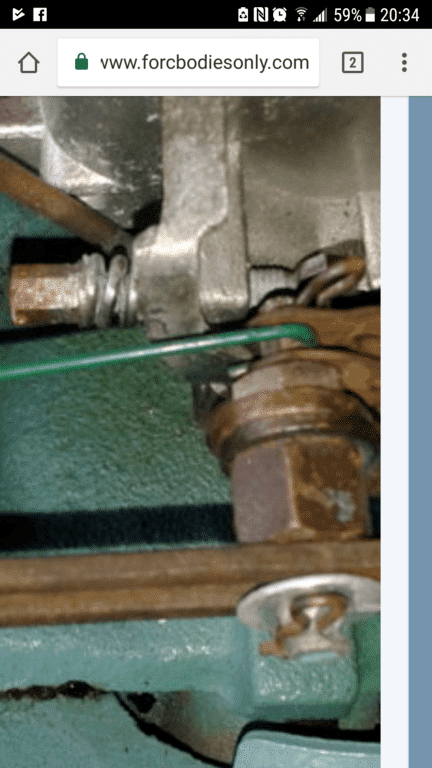

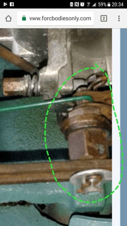

Thanks I'll have to study the photos more bc I'm somewhat still loss. Is this the part your referring to in the pic?
This is the part you take off, and then put back on to the adapter after you install it.
Ok thanks I'll order one to day, just out of curiosity how could this cause my transmission burn up I know it may sound like a dumb question I'm just curious
So this was setup and this part is what's incorrect . I'll order that part and as always guys thanks a lot
