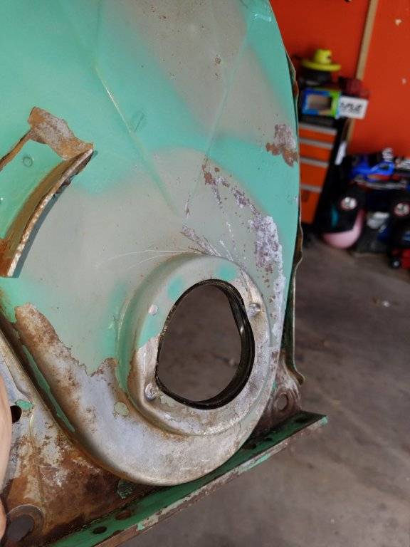

So far as I dig deeper into my 383
The only way you're gonna straighten that is with a hammer and appropriate punches/supports etc. unless you should happen to have access to a hydraulic press - and given what I've seen of your efforts so far, that would surprise me.

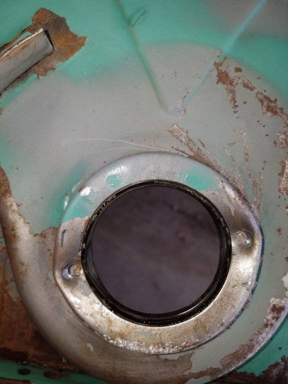

Ok that's what I was thinking, I tried bending it but she just wouldn't move anymore than that. I think the photos I posted last night didn't show as much of the damage lol
Remove the old seal, turn the cover over, and on a flat surface use a drift and a hammer work the damage out. It does not have to be perfect, just back enough to get the seal installed.
For $38.97 (including a new seal already installed), I would not fool with the old cover.
It's only Dan's money, so I say get a new cover, seal included is a plus.
F-that get.a chrome one definitely needs a chrome one.
You still need the oil pan front section and the cover gasket and the WP housing to block gaskets, which comes as a kit with wow imagine that another seal now you have 2 seals. One to lose, and one in a Chinese cover.
If you are insistent on a new one spend the extra $5 on the Milodon one so you can be reasonably sure the timing tab and vibration dampener will not be occupying the same real estate.
I would fix it. But I am really cheap. You wound the bolts for the puller in too far. Knock the seal out from the front then turn the cover over on a block of wood so you do not bend them out the front. Smack those bolt divits back toward the front using a screwdriver or long bolt and a hammer, you just want to push them back into place not into next week. Steel has a very good memory and will want to go back like it was. If you get it close it will be fine, those seals hardly ever leak, and a little black ultra RTV is your friend. You will need some at the corners of the valley pan anyway.

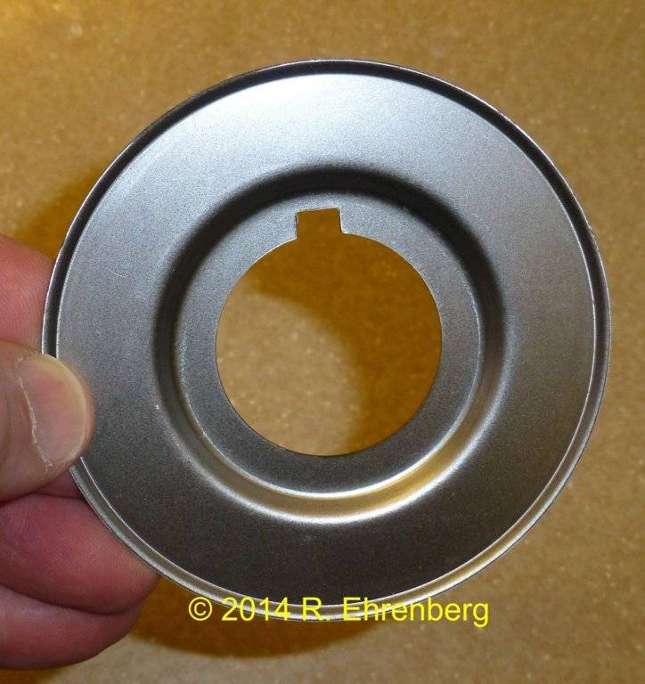

Even if you try putting it on the other way (dish inwards) you'll discover that it will rub against the T chain before it bottoms against the T gear. Only goes one way.
