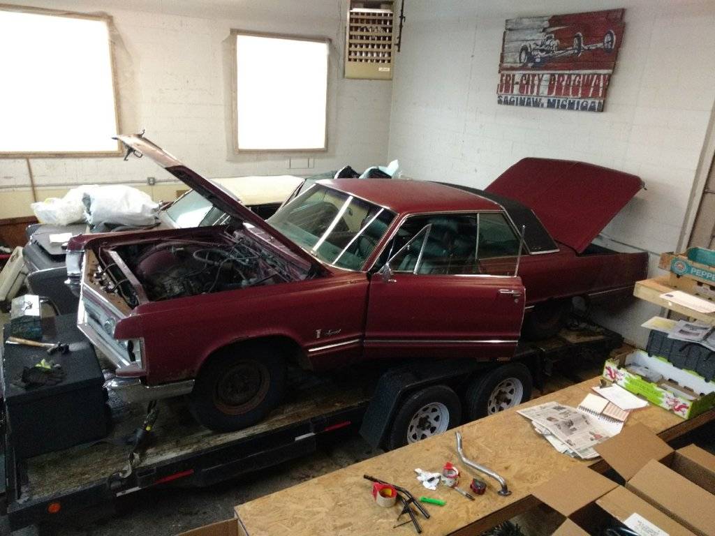

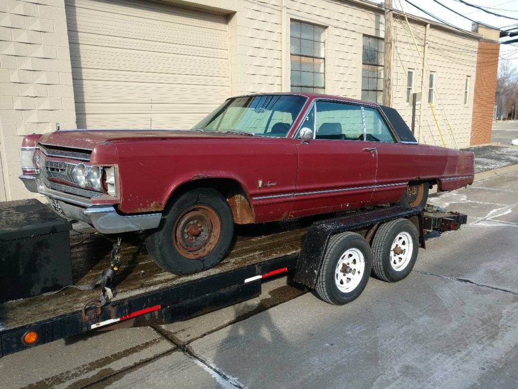

Well it’s inside from now on at least!:thumbsup: Spent 10 bucks at the quarter car wash but I’m going to leave it on the trailer as I think it needs more.​
That’s it for now. It took all afternoon to get it out of that back yard.

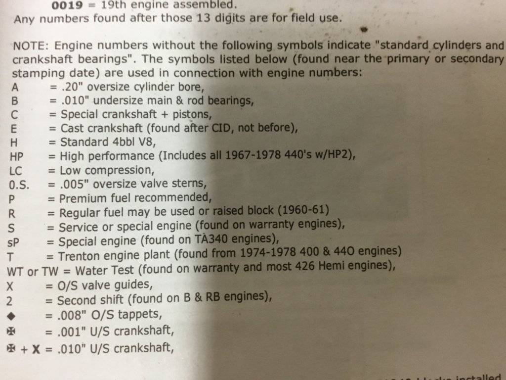

The stamp on the pad by the distributor has an assembly date of 4-18 while both the tag and the sheet have 5-26 on them.
It is also stamped for .020 oversized cylinder bore and .010 undersize main and rod bearings which explains why they had to go .060 in order to clean it up past the pitting from being stuck.

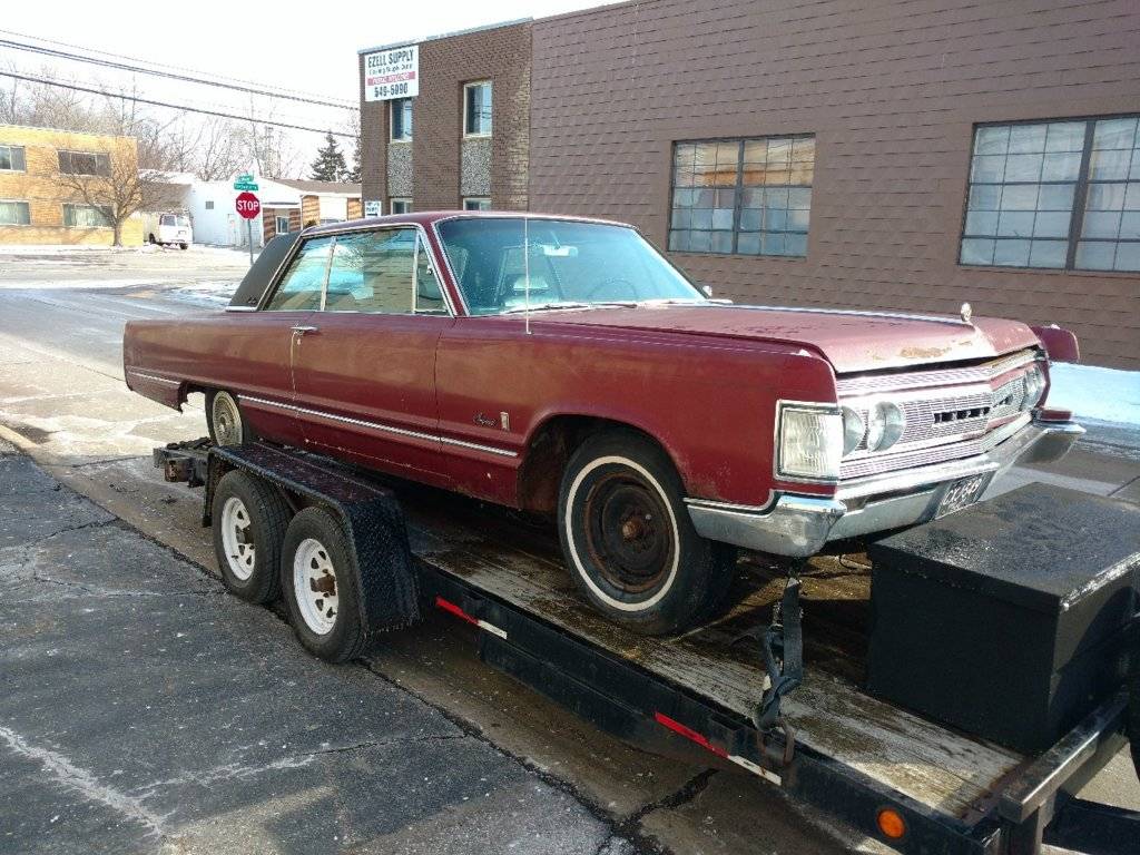

Take some detail pics of the rust, I'm curious to see how much work is in it.
Me too, I worked on more parts removal from the engine room for my about an hour last night. When The engine was pulled the exhaust manifolds, starter, power steering pump and ac was left hanging there.:BangHead: Hopefully I have time to get the trans out from underneath it today:BangHead:, pull the gas tank and really take inventory of the rust.
Excuse my ignorance, so was this done from the factory on a brand new engine, or later as a warranty repair, just curious?
How common is it, if it was done on a new engine?
Some shops stamp machine work on block. This could be from the factory.

Early 440s had some problems being the largest bore Chrysler had ever done up to that point. You would think they would have it sorted by over a year into production.
It was factory or at least the stamps stating these facts are in the factory index.
Mother used to have special stamps she used to mark over sized+under sized Cranks, Main Bearing Saddles, so that the whole world knew it left the factory with those modified parts. 4 sided diamond was one of those stamps. The others? the memory fadez, Jer
I think there was a Maltese Cross in there too, Jer.
