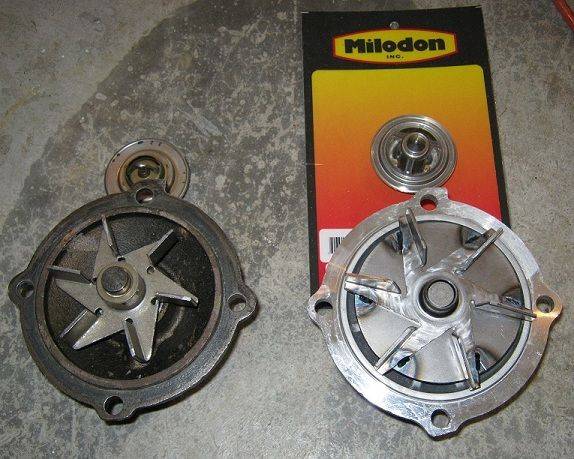

I did gain another 5-10 degree drop when I removed the mudguard. Water pump is a Milodon unit with anti-caviation plate. Car goes in for body and paint this weekend, thinking about having rad pulled to have it flow checked and cleaned if needed.
Cavitation is usually a high rpm thing are you sure it's not impeding flow at lower rpm?
The low pressure area at the center of the impeller makes such a low pressure area that steam or water vapor form and the flow is lost usually they would fill in this area to eliminate it, if you never spin the pump high rpm it might be blocking some flow. I am not familiar with this pump and can't find a picture of this anti cavitation plate. Milodon products are good so I doubt it is a problem. I would still look at radiator.
My pump would be the one on the right with the anti-cavitation plate.
