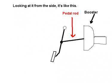

I hear ya. I'm going to give the pads a shot before I do anything else. I have the feeling this should do it since the fluid pressure is where it should be. Plus, I was looking at the brake pedal rod and it is on a slight angle and not going straight into the booster. I will need to adjust this so it's straight.
I can't understand how the pedal assembly would be crooked.
Maybe you reattached the push rod to the wrong side of the pedal?
I can't understand how the pedal assembly would be crooked. Maybe you reattached the push rod to the wrong side of the pedal?

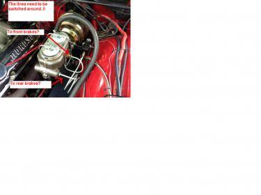

Check out the picture below. This is what I got going on with the push rod. I also found out the PO has the lines going into the master Cly backward..! WTF..!! The rear and front lines need to be switched around.!!
Is the booster upside down ?
No, it can only go in one way. I have to slot the mounting bracket more so the push rod will be straighter. OR,.It's possible that the brackets are in upside down. I'm not at the car right now, but I will check on that.
No, it can only go iwrong in the first place. Don't slot them. one way. I have to slot the mounting bracket more so the push rod will be straighter. OR,.It's possible that the brackets are in upside down. I'm not at the car right now, but I will check on that.
A disc brake master cylinder has a big resevoir For the front brakes and a smaller resevoir for the rears. The front resevoir is closest to the master cylindar. The front brake line goes to the larger resevoir closest to the m/c.
If you have to slot the bracket, something is wrong. Don't slot them.
Posted via Topify using Android
My setup uses a Corvette MC. Both reservoirs are the same size. SSBC pointed out from a picture I sent that the lines are crossed. The way it is in my car now,is the closest port (back side of the MC) to the power booster is going to the front brakes and the other is going to the rear brakes,..front side of the MC. It should be the other way around since this is a Corvette master cylinder. They work the other way around compared to a Mopar MC.
