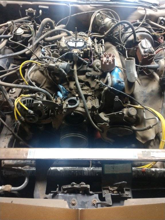

Started tearing into the motor in my NYB tonight. Planning on swapping out the steel intake for a aluminum
edelbrock and a hei disburtor.

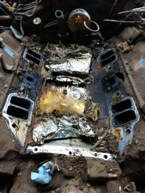

Strongly suggest that you put the distributor back in it, tape of the top of the carb and pressure wash the top end so you don't drop lots of dirt/debris into the valley.

Thank you was gonna use shop vac and get alot of it off as well.
Wire brush the top of the intake pots and then vacuum. Crap falling in the ports is hard to get out and can leave you with intake valves that do not seat. Leave the end cap bolts in place on the valley cover as this will catch crap from falling in the valley. After you have removed all the debris, you can then remove the valley cover.

You are going to have a lot of vacuum tubing and port switches that are no longer going to be relevant. You need to keep the branch fitting for the power brake unit, it should have a small port to operate the in-dash A/C heater control. If it does not have one, you will need to figure out a way to run that accessory off of manifold vacuum the 70-71 manifold port for power brakes will work for that. Are you going to retain the EGR valve (not recommended)? If so, you will need a ported vacuum switch that is temperature controlled and runs off of throttle plate vacuum. Be sure your manifold has the proper ports if you are going to use this option. Some cruise control units also require a vacuum input, if so run it appropriately. Run the PVC valve off of the provided port on the base of your aftermarket carb.

You also appear to have an emission control carbon canister port. These can be run thru the same intake port as the PCV valve but controlled by a temp switch so that fuel vapors do not collect in the engine.

Are you putting the ac compressor back on? If you are.....take a grinder and grind off enough metal on the bracket next to the left side thermostat bolt enough so you can get a socket on the bolt. Believe me.....you'll have to remove the compressor in the future if you plan on replacing the thermostat down the road for any reason. Grind that bracket a little and the thermostat replacement will be a 15 minute job instead of hours because you'll have to take the compressor off to get to the left side bolt.
FYI At the Chrysler dealership, we put a crow bar under the bracket, it has enough give to get the thermostat housing to clear.
