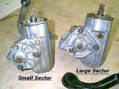

I intentionally omitted any reference to years because in passenger vehicles there were only two designs: large sector and small sector and there is interchangeably.

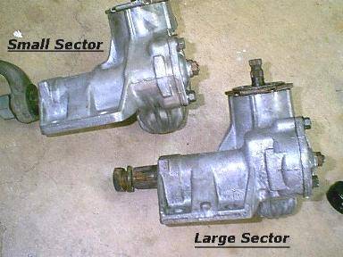

Can you ID your box to which of the two as shown below?
