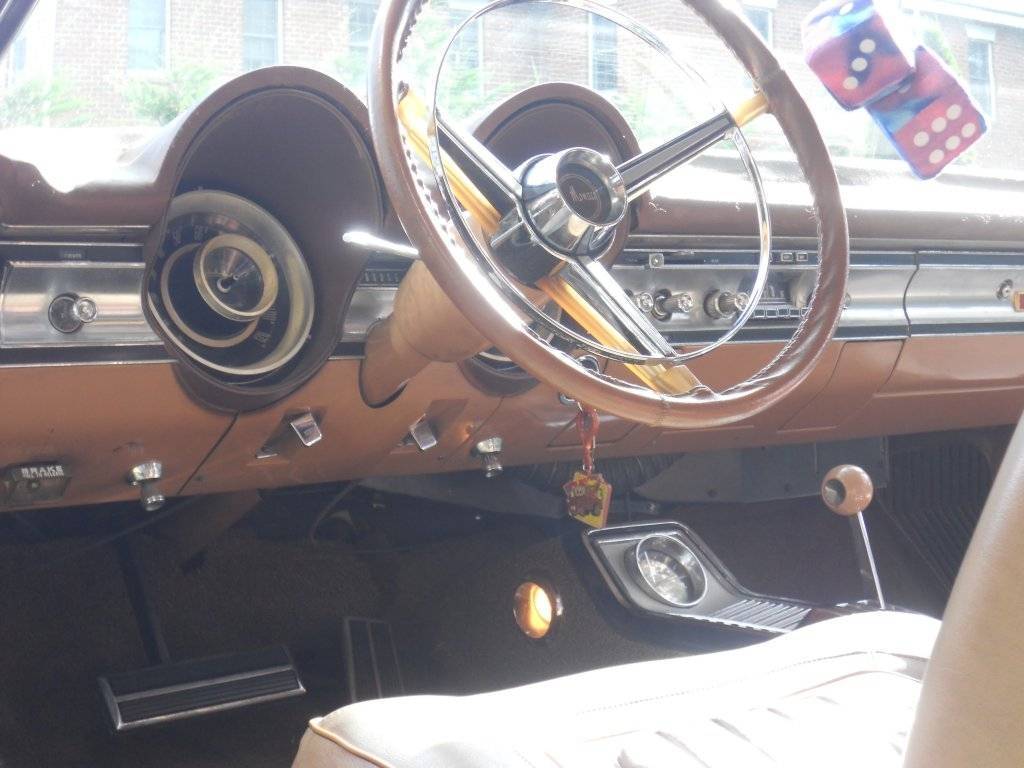

I'd just put a cover over the wheel 'till i have the money to have it restored.
This one has been on my car for years. Fortunately it has protected the wheel from sun damage. It matches the car so well i'll probably leave it on.
Put one of these on my Barracuda in the 80's and it is still there even after the restoration.
