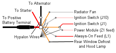

If your vehicle is an 1989 or earlier model, then you probably have hypalon wire fusible links. These look just like regular wires, except the insulation is made out of a special, flame-proof material. The easiest way to test them is to tug on them. A blown link will stretch like a rubber band. The diagram below shows a typical A1 distribution (using hypalon wires, based off of 1987 configuration).

Fusible link wire may be purchased at most auto parts stores. The correct gauge and length of wire must be used in order to achieve the correct current rating. The following table lists the Chrysler color coding on its hypalon fusible links. Be sure to cut the new link to match the length of the original.

Selecting the correctly-rated fuse is not straight forward, as the hypalon link current capacity is a function of its size and length. They are generally selected to protect a particular size circuit wire and the general rule of thumb is the fusible link gauge should be 4 less than the circuit it's protecting (thus a 12 gauge circuit will be protected by a 16 gauge fusible link). The chart below uses the Maxi fuse ratings of later model (1989 and up) electrical systems as a guide for Maxi fuse size selection. This is possible because the power distribution did not really change electically on vehicles with the power distribution center, thus the circuit rating could be deduced from this.
