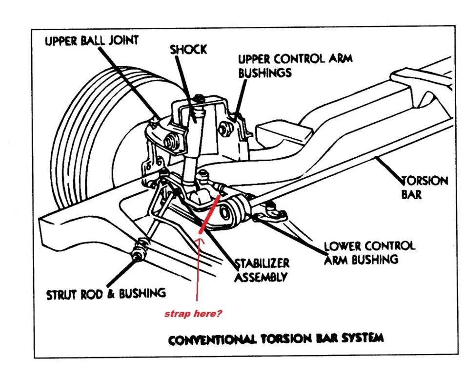

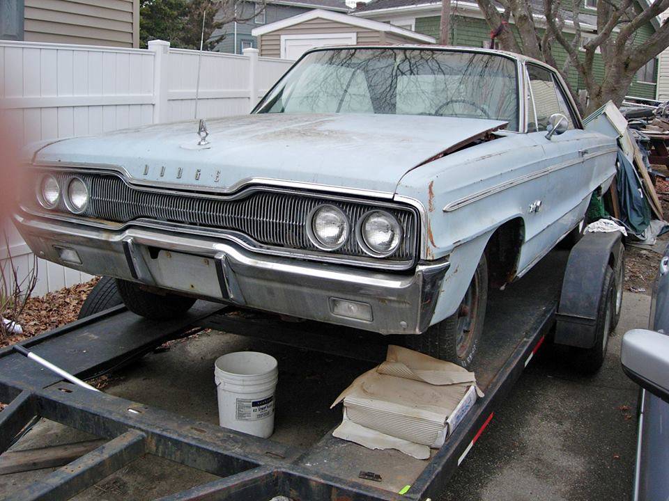

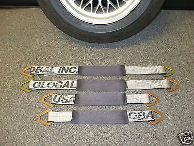

Good morning all, It looks like I am going to Massachusetts to pick up a 66 Polara 500 2dr hardtop next Friday.I very much would like to get some advice on strapping it down to a flatbed trailer safely without damaging the front end specifically.The rear of the car is simple...around the axle tube outboard of the springs and cross the straps.I ordered a set of axle straps and have plenty of chains and binders.Just not sure about where or how to strap the front. Most cases say the lower A arms but I don't think that is a good idea on a C body Mopar.Don't want to bend anything if possible. Car has no engine and transmission so it is a lot lighter than normal. Any advice is very much appreciated!

Front lower control arms are good to attach to. Just not the strut rods they will bend.

I've never pulled a car without an engine in it so this is coming from no actual experience, but I would think you could simply wrap around the cross member. Just do't put any pressure near the strut rods.
Lower control arms will work just fine.
With no engine, be sure to pull the car farther forward to keep the trailer tongue weight correct. I've even loaded cars with no engines backwards on trailers to keep the weight right.
I always run a strap from each control arm to the front of the trailer and I leave the winch hooked up to the front cross member. Rear is just around the axle.

You see that big crossmember that the engine bolts to? Why not use that? Your not going to bend it or damage it. Easy to tie onto it with no engine.
Do not use the strut rods or the sway bar.

I use the axle straps if I use a regular car trailer, put them over the control arm, and a large rachet strap to the trailer. I have a long chain I use over the rear axle, and tighten with a chain binder. Never had any issues, just remember to check the time downs after a few miles, and every time you stop.

Seriously, it sounds like you have it covered. Axle straps around the lower arms to a ratchet strap going straight forward. Rear, Axle straps around the shock mount & and axle, to ratchet straps crossing side to side in the rear . (this prevents side to side hop). I don't recommend using chains. Aside from the damage they can cause a twisted link may work loose.

My very good and generous friend Paul is lending me his Cummins Dodge quad cab and 5 ton beavertail equipment trailer for the journey.Making up a mount for my new Harbor Freight 5K winch tomorrow.I think I will leave the winch chained up to the crossmember, axle straps and ratchet straps straight forward and the same crossed out back,,,should be fine.Many thanks to everybody for their answers to my question.Wish me luck!
