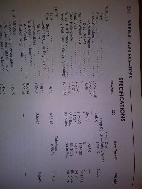

Direct from the 1966 Imperial FSM, page 22-6:
The wheels were of a unique design from other Chryslers in those years. Kind of like some of the older ('30s-'40s era wheels) than what came into use in '67. Could well be just '64-'66? The "L" in 15x6L denotes the shape and configuration of the wheel's bead edge (probably height), as do the "J" and other letter combinations like that.

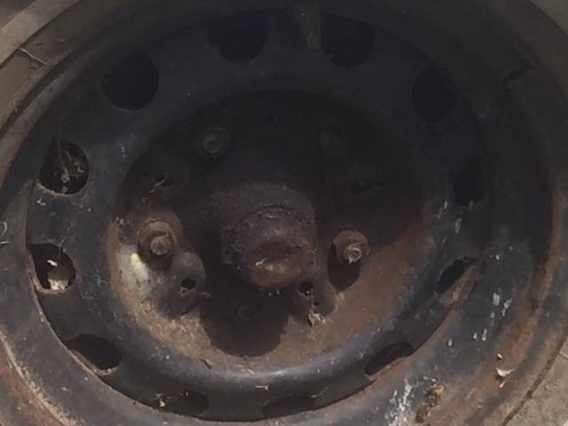

I'll take a look shortly - broke the bush hog so I have to weld some parts back, and i'll be next to the car doing that. I don't recall what wheels are on it visually speaking. If they look like those factory ones I'll press to just pay the real owner for them. Easiest is best for me right now...lol.
