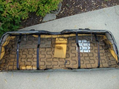

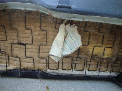

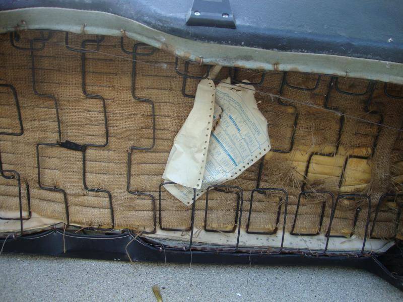

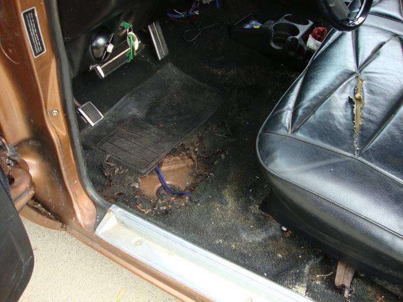

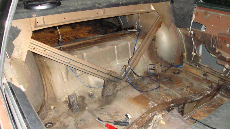

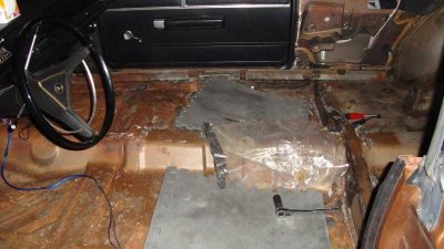

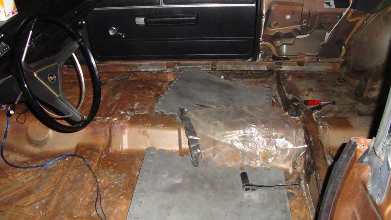

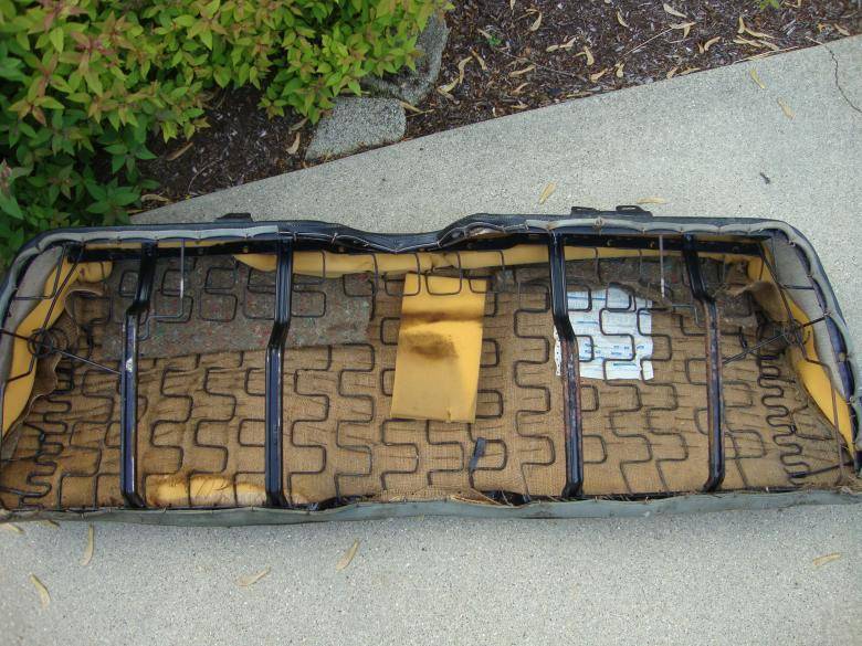

sooooo....big day today! my g-friend and I stripped almost the whole interior out.

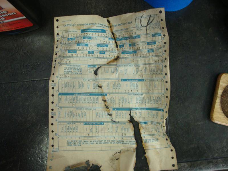

and guess what I found...not one, but two broadcast sheets!!! i just about sh*t! I've never actually found one un-disturbed before, much less two!! :yaayy:
took the one out of the bottom of the front seat and left the one in the bottom of the backseat in. I think I would destroy it if I took it out. checked em both out, and they are both for my Newport!!
pics...
going to give the windshield and cowl a good soaking tomorrow to see where the leak is coming from.

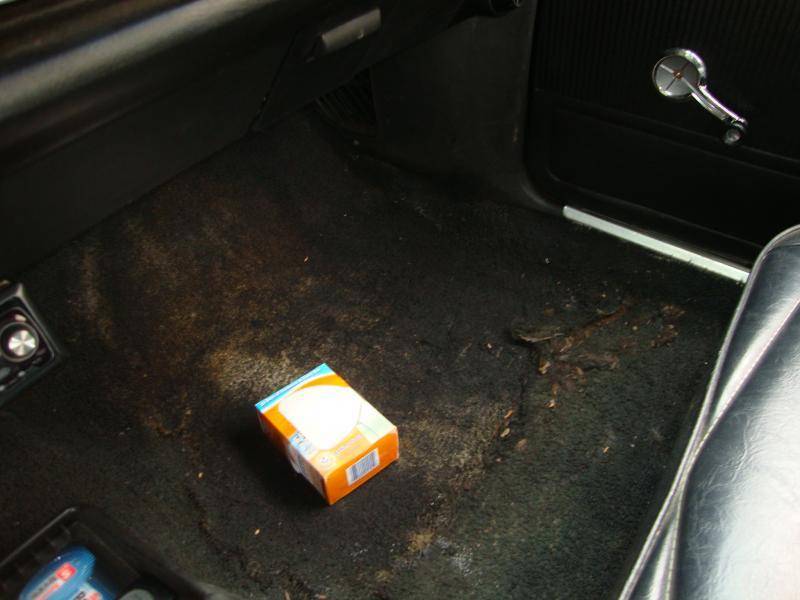

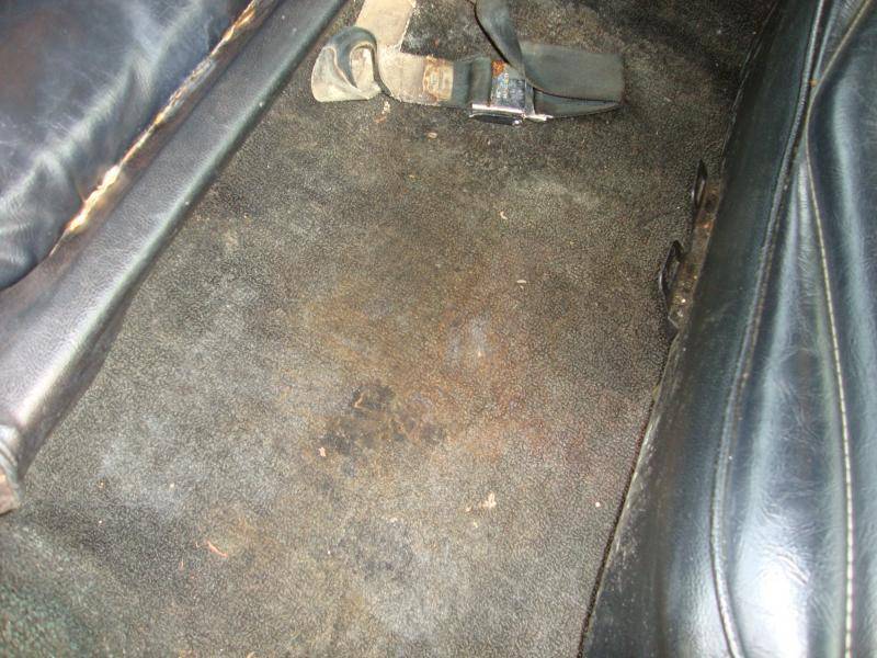

no no, it's something more conspicuous...THE MOLDY STENCH!!! oof.

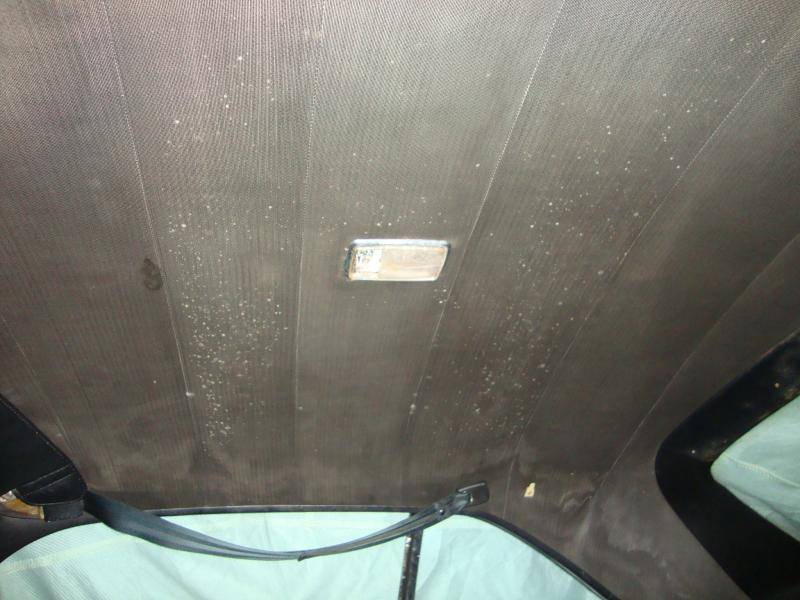

and for the record, the headliner is nice and taught. but unfortunately, that's probably going to have to come out too.
going to give the 50/50 water and rubbing alcohol trick a shot first and see if it helps
I sprayed the bottom of the backseat with the 50/50 mix last night and it seemed to take some of the stench away. so I resprayed it earlier today hoping it will all come out.

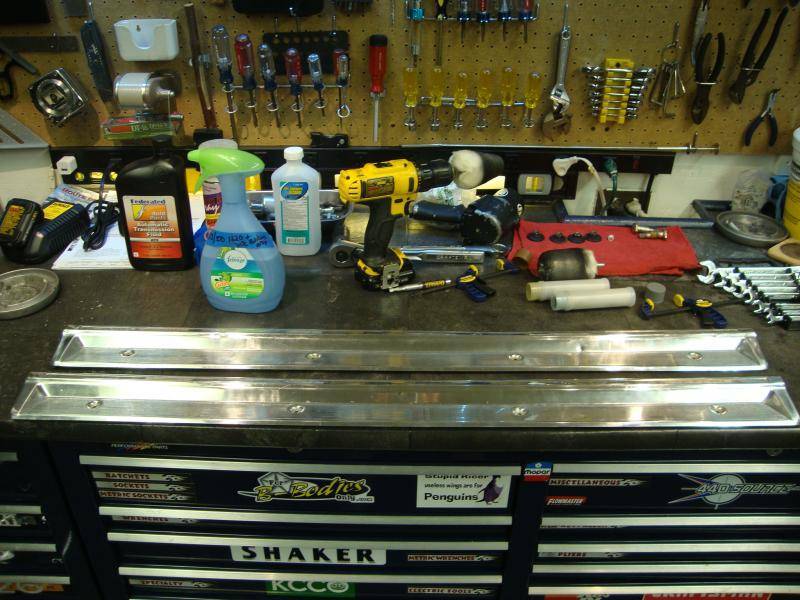

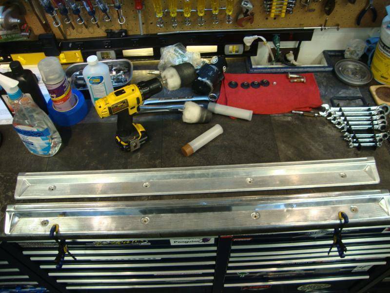

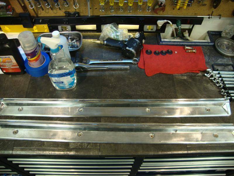

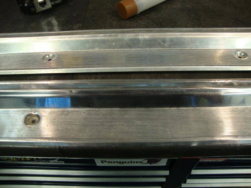

also, I buffed out the door sill trim...not perfect, but a helluva lot better!

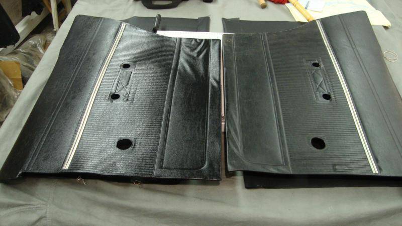

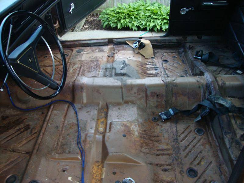

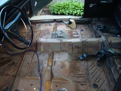

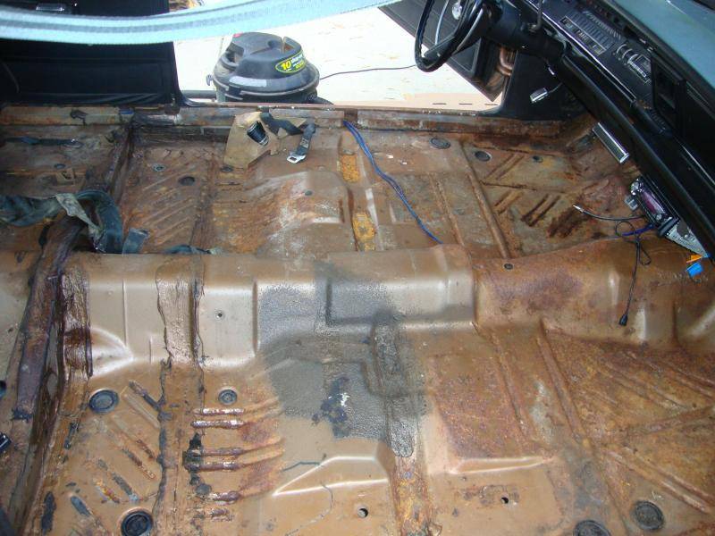

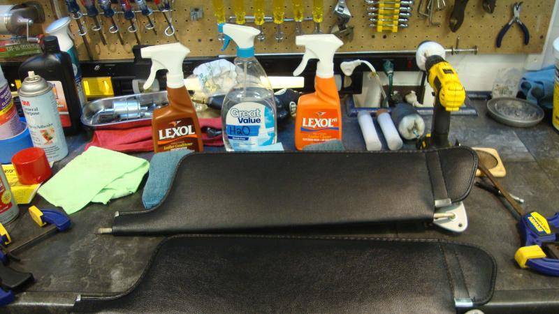

took out the rest of the interior today...
Cleaned it up...
soon, she will be mold-free...
