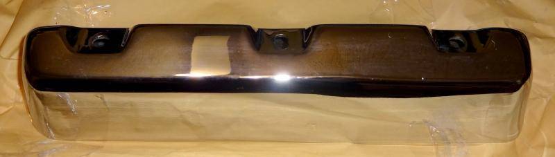

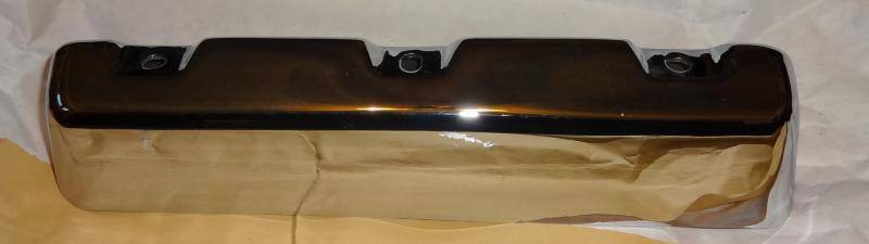

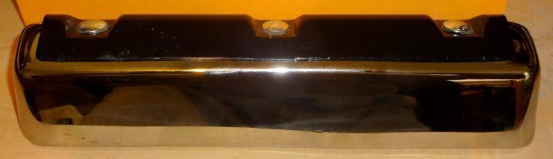

I got the Admirals rear bumper step brackets back from Tri City Plating . They look great. Now I need to figure out what to make the rubber step pads out of.

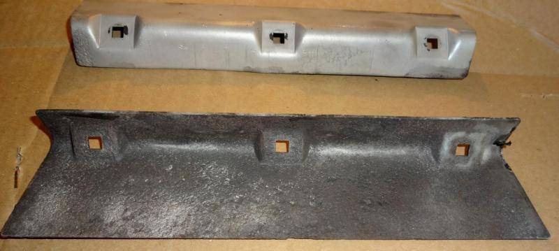

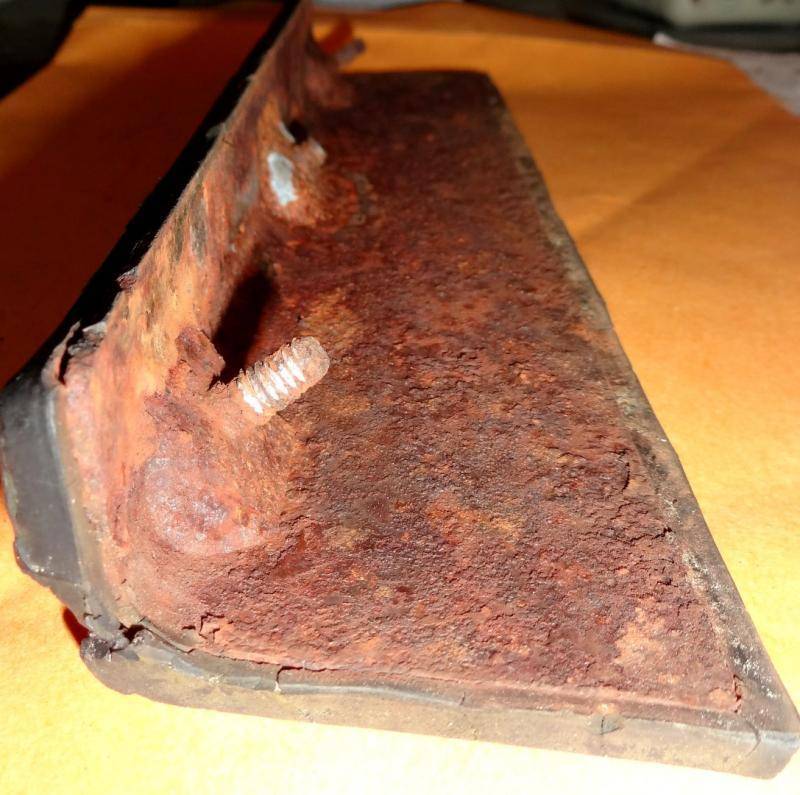

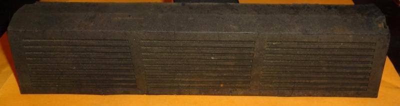

These are the original rubber pads that were on the brackets when I got them from Tom. The rubber is vulcanized onto a steel bracket and attached with three studs and nuts.
I should be able to remove the old rubber and restore the brackets by sandblast and new hardware. Just need to locate some heavy rubber with some kind of texture to form new pads from.

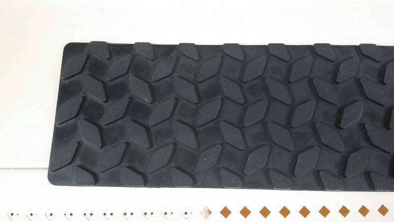

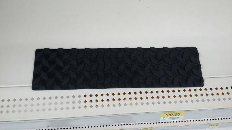

Will, I was at my local walmart yesterday in the towing section. I saw some non slip step pads there. They're made by Reese towing company, they have a 3m adhesive backing and are 4"x15" in diameter. They sell in a 2 pack. I think they would work for your step grip...
These are a great option. Thanks for thinking of me. The rubber on my steps measures 11 1/2" x 4", so these might work, look good too.
I ordered a section of ribbed rubber used for vintage car running boards off of ebay. Now I have choices.....

The admirals rear bumper step project update........
attachment.php
attachment.php
Waiting for the rubber I have ordered to arrive before making the final decision on what to use.

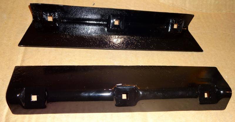

A little gas in a metal pan worked great to soften and remove the old rubber from the brackets.
