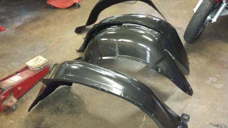

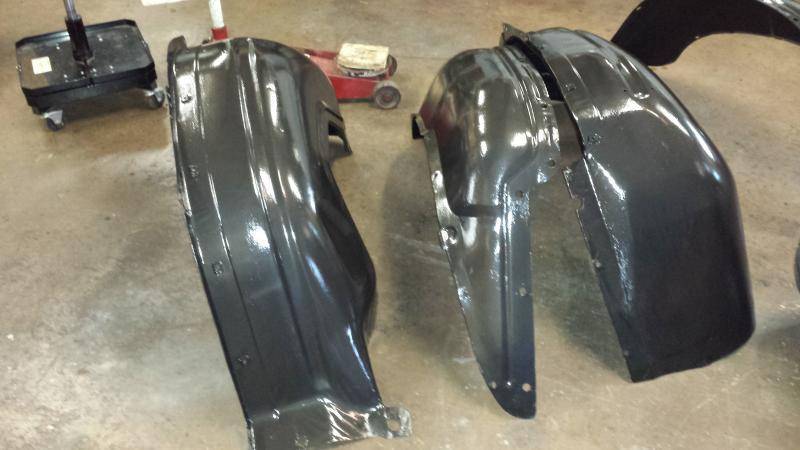

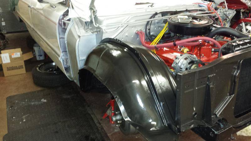

I painted the inner fenders and they are now ready for installation although I will wait until I get the P/S leak and brakes bled so i don't have to reach over the fenders too much!
Please don't beat on me for not going with body colours. If the day ever comes to me painting this car, I will body colour them then :)
I chose a charcoal metallic black to offset the black stub frame and metallic silver firewall.
The underside has been satin black stone guarded as well after a base coat of Rust Bullet.
I had these shipped from California from a member that was unfortunately given the boot from the FCBO forums this past winter.
I scored these inners for less than $200 shipped all the way from Sanoma, CA to Buffalo, NY by way of GreyHound bus co.

They look great. Can't wait to see the car all together and rolling down the street. Hmmm, maybe a nice smokey burnout video too..!!!
Can you come to Maryland and paint my NYB? LOL!
Great job!
re the rust bullet...are you using it as a base prep for everything your painting short of exterior? or just using it for undercarriage and heavy wear areas like underside of inner fenders?
used rustbullet extencively on my 91 gm project however was only able to use a brush due to noise limitations where l live and wondering how it sprays and holds a topcoat other than the black topcoat...found the black topcoat little to shiney for me although it works great

I think you've painted the inner fenders (more or less) the correct colour. I don't believe they were body colour. If the inner fenders were integral to the unibody, then yes, they'd be body colour, but when they're bolt on, they're black.
Phew that's a relief! But they are body colour normally at least in all the C-bodies I've seen for this year and model.
Anythng I do is 100x better than what is started out as. :D
The Rust Bullet? I brushed on everything I stripped or media blasted for this project.
I agree that the gloss black and white are too glossy but they did the job
I would have preferred a satin black myself
The gloss black didnt shrink in as nicely as the silver base but again I didn't use any reducer in the paint.. just a brush and a roller
I have heard very good things about rust bullet and it is more user friendly than other products on the market

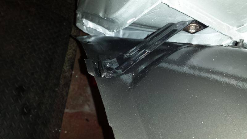

I loosely installed the right side inner fender as well
I just have to figure out how to properly attach that inner fender support bracket. it was screwed in with a #2 wood screw when I tore it apart..

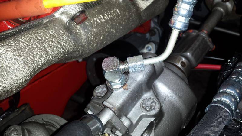

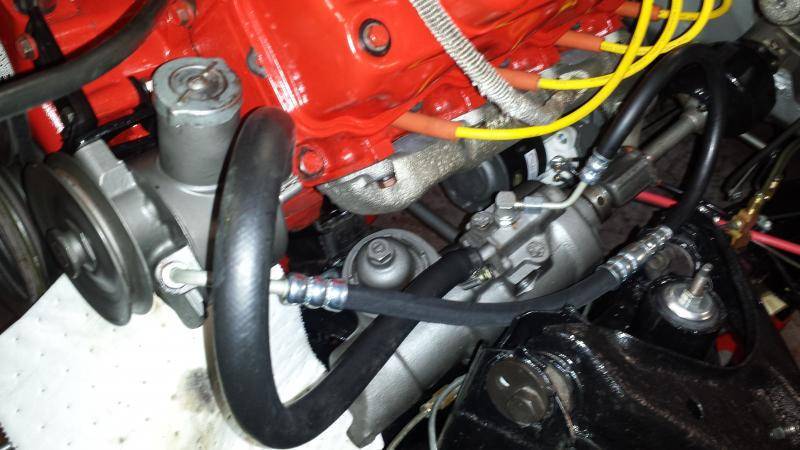

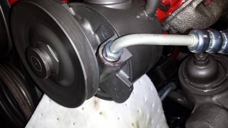

Well I think I finally cured my leaky PS pump with a new hose and a fancy 90'adapter..
Here's the P/S hose and adapter
CLEAN! Where did you get the adaptor?
It is a typical hydraulic 90 swivel adapter I picked up locally.
AN6 3/8"straight NPT
The nice thing about it is that I could postion it in any direction then tighten the swivel nut to seal the adapter.
Guess I need to get out more. I don't recall ever seeing them body colour, again because they're not part of the unibody. I'm still going to hold out until someone has photos of an unrestored car.
To me, having them black sets off the engine itself as well as the engine compartment and all of the wiring and small ancilliaries that you attach to them are going to stand out very nicely.
I'm thinking you're doing a bang up job and doing it right both cosmetically and mechanically. Plus you seem to be getting all of this done in record time, which is a whole 'nother giant thumbs up all by itself.
In about two weeks, I'm going to actually have some time to look for some seriously good technical info on your car, and I'm hoping it will answer some of these questions.
For the time being, can you get back into the website where you find the subframe info in that online parts catalog? Sheetmetal parts are normally listed as "Paint as required" to match the body colour - fenders, doors etc., but if there's no notation like that for the inner fenders, then I'm going to call them as being provided in chassis black.
