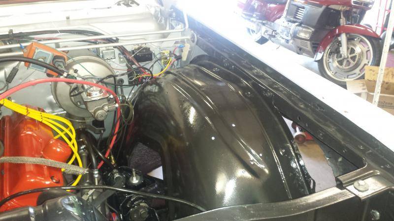

I think you've painted the inner fenders (more or less) the correct colour. I don't believe they were body colour. If the inner fenders were integral to the unibody, then yes, they'd be body colour, but when they're bolt on, they're black.
On the C-Body they were body color up to 68? then matte black.

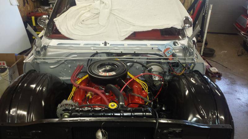

Mounted the driver's side inner fender.

Well after a bit of struggling, the inner fender halves that connect to the fender don't fit.
I had bought them knowing that they fit a 65 Polara.
The inner inner fenders work but the out inner's don't.
i quickly patched my old ones up with masking tape and rubberized stone guard.
They are easy enough to swap out from underneath the fenders. No major surgery required..

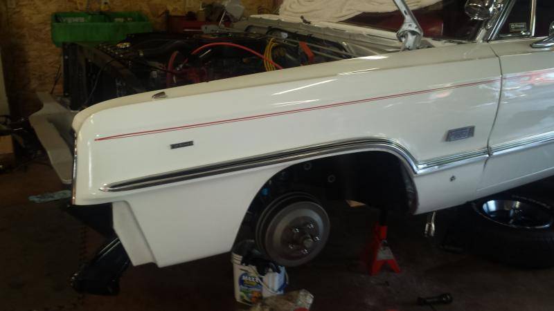

I see a fender in place. Looking good. The red pin stripe looks nice on your car. Sorry your inner fenders didn't fit. I have a little rust issue on one of mine but not doing it now. They are so easy to remove I mess with it later. I shot some undercoating on it and will bolt it into place.

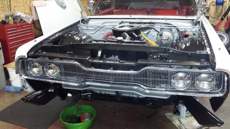

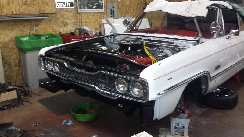

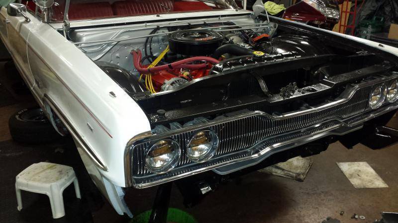

Here is the latest after tonight's work.
All the tin less the hood is on now!
Best of all, there's no parts left over!!!
