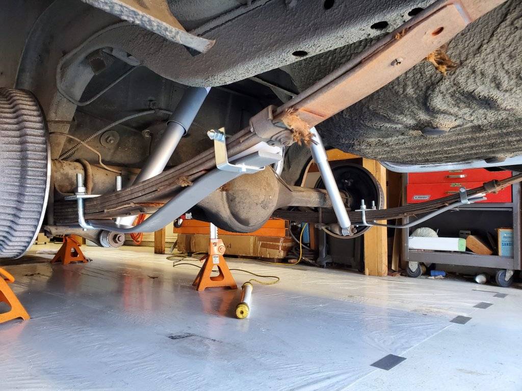

After many failed attempts to compress and tie the front KYB shocks for installation, I wimped and finally outsourced the job. I found a local guy with 25 years experience at his own shop who had sold it and downsized to a small shop working ONLY on older cars. Took it in today and it was done in a couple of hours with no drama and a reasonable price. It turned out that one of the Monroes I had installed when I first got the car was completely blown out and the upper bushing on the other one had self destructed, no wonder it was bottoming out! Went the long way home over some poor roads and the difference is amazing. I may still fiddle with the back shocks later but the brake job will come next.
I did ask this guy how he compressed the shocks. He said he tried to do it manually without success and finally took it back to his old shop and used the hydraulic press! Money well spent.
There ya go. . .
