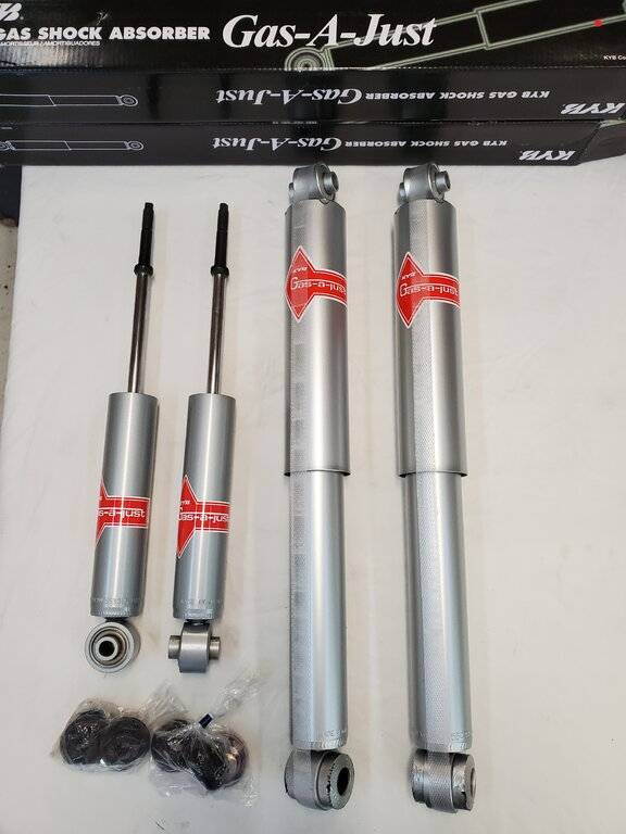

I just bought a full set of KYB's - the fronts were fully extended but the rears were compressed with a big plastic strap. It does seem it should be the other way around.

To those who used the KYB front shocks, did you have any problems getting them installed and what is the best way to do it?
