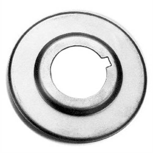

Did you put this back in?
First, you need to determine where the oil is coming from. If the oil is coming out of the corners of where the timing cover meets the pan, you will probably have to pull the cover back off to fix the leak properly. If the oil is coming out of the hub seal, the seal is most likely damaged and will have to be replaced. Either way, it is going to have to come back apart. Do not drill or otherwise alter the timing cover as it is designed to be self centering. When you pull it back apart, check the oil slinger sleeve, (above) it can be installed backwards which might be the cause of your leak. The sleeve should be installed so that the channel in the sleeve faces the hub seal.

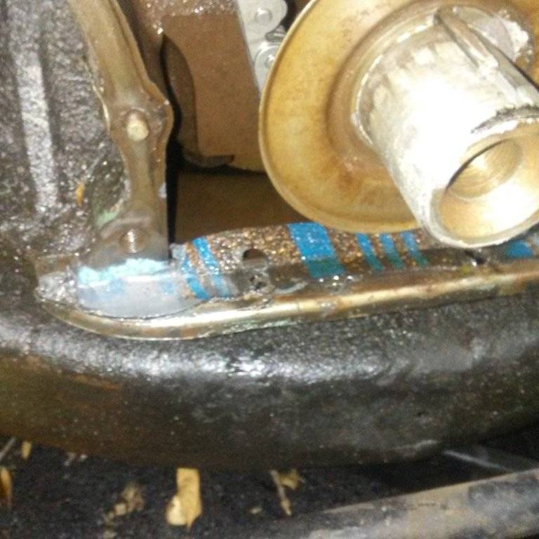

Finally got around to taking things apart, i like it when life is not making busy with other lifely things and the weather cooperates
I give you my source of my oil leak
Tomorrow i will try to put it back together, hope i don't fudge it up again
