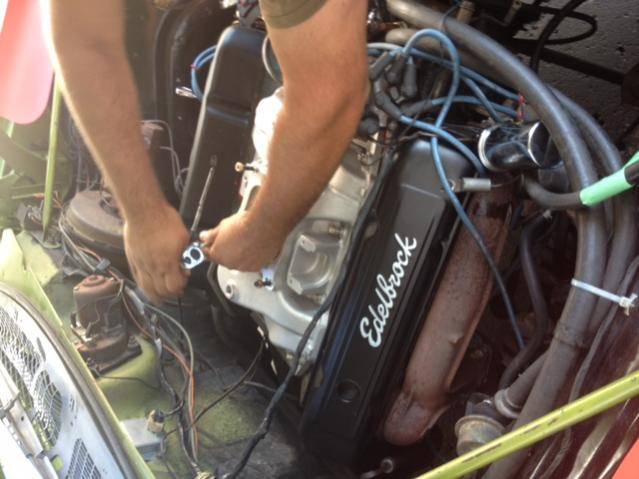

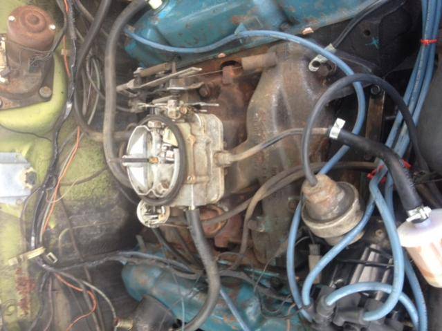

the beginning..

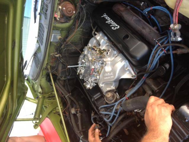

forgot to take one with the new valley pan in but here is the next step

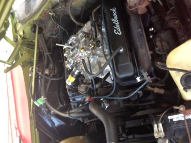

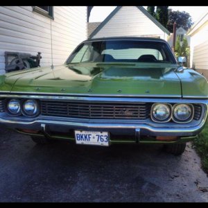

pretty much done. for hoses to replace and wirin to clean up but on my way !:] very happy thanks for those who gave great advice. !:]
started up and ran perfect right outta the box. had to adjust the kickdown abit and run a seperate wire for the elecric choke. rebuilt alternator also very clean :]

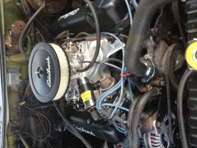

Nice job. Love those valve covers....does it still have the same 2bbl cam in it?? You'll see a very nice difference if you swap that out as well.
yea still the same cam, my brother in law who helped me wants to do the cam and heads now. haha its gonna have to wait. next is the dual exhaust and headers. thanks for the positive replys .
