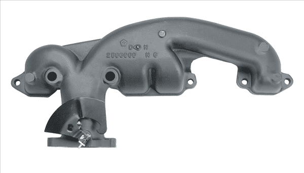

If I were you - and with what you've said your performance goals are when you're finished this build, I would stay with stock manifolds - perhaps upgrade to the HP manifolds that were available on the Chryslers from 68 and up that were factory HP motors (I may have the nomenclature wrong, but others will fix me up).
In my opinion, the factory HP manifolds are super sexy too!
Driver's side (C body only)
The bonus is that the passenger side is being reproduced (with heat riser assembly) since it also was used on B bodies. You can get it from Year One.
Even if you didn't do the upgrade to HP manifolds, a nicely dressed set of Chrysler exhaust manifolds are very nice, and in my opinion will provide you with all the performance you need with your nice dual exhaust system you're planning on.

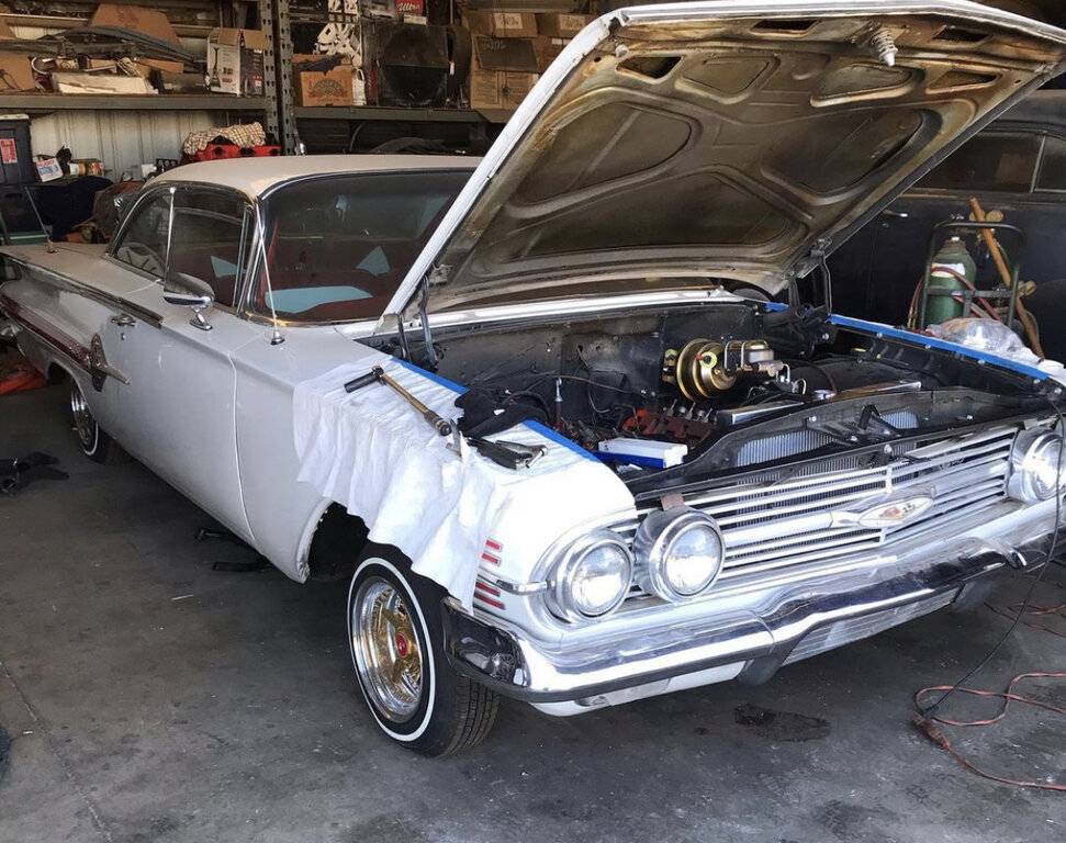

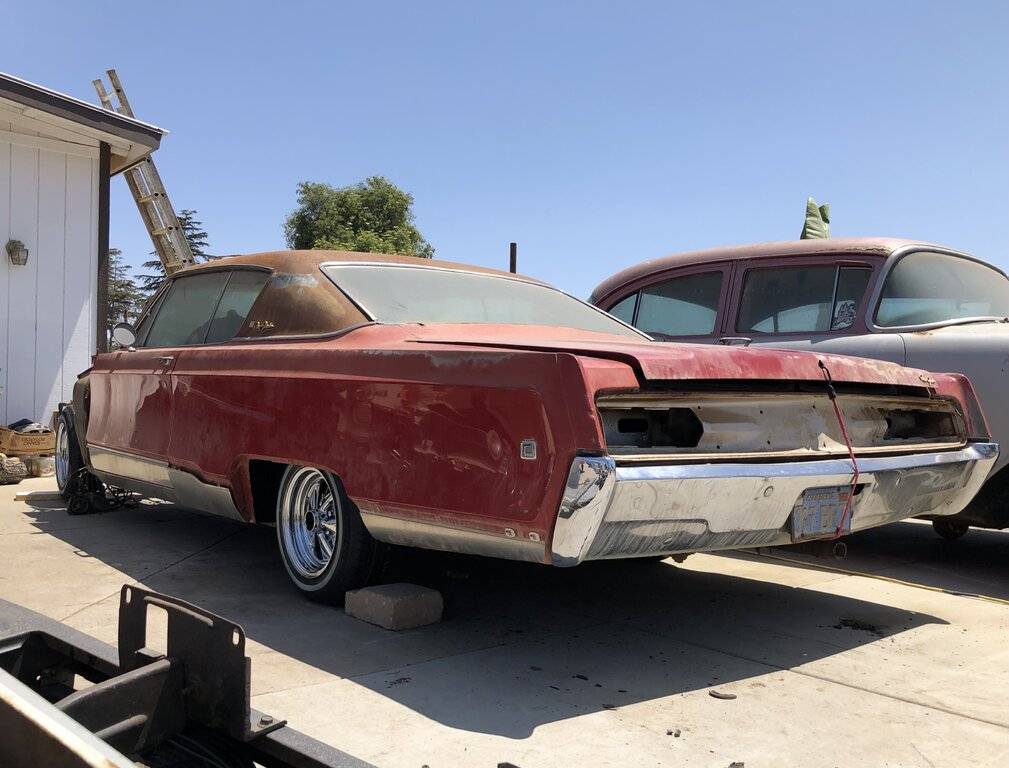

For many, the correct answer is Manifolds. But I'm not here to be a troll. How bout some pics of that 60? Chevrolet in the Back Ground. Please.
FYI, Schumacher has been purchased by another company and they are manufacturing Schumacher Tri-Y headers again. I am very happy with mine. Easy install when used with a mini starter and compatible with the angled plugs on Edelbrock heads.
I saw that too!!
She’s a beauty!!! She belongs to one of the lowrider car clubs here in my city. I don’t know who it belongs to exactly, but I remember at the time it wasn’t running. 59-60 Impala is one of my dream cars as well!!! I have a soft spot for the Fastback 67-68 body style as well. Other dream cars for me are a 63-65 Buick Riviera, or a 71-72 Pontiac Grand Prix!

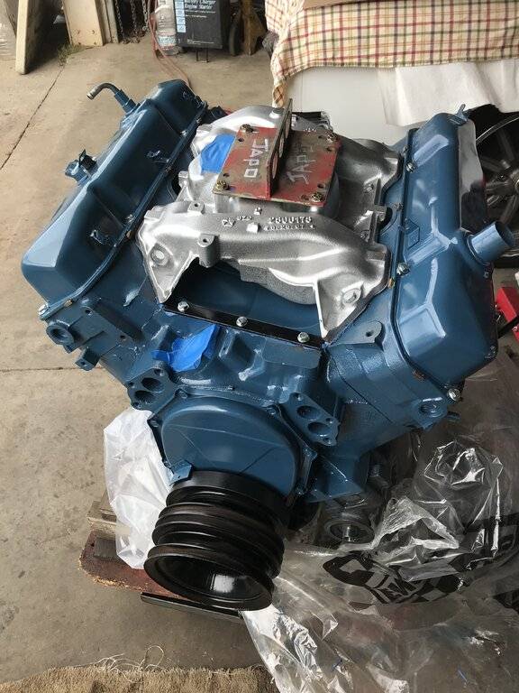

The shop I took my engine to specializes in engines, and a lot of folks building their rides have their engines rebuilt and installed here. I just brought John (owner, whose also known as ‘Japo’) the stripped down 440 so it could be sent out to be machined and boiled out. Then he re-assembled everything and it was back in my possession in a good amount of time!
That definitely a W engine (348/409), most likely a 348. I hate that she's been lowrider'd, but it's still a good looking car.
Yeah it’s different for sure! This is more of a modern style build (90s +) I myself am not a big fan of 13 inch wheels and 100 spoke Dayton’s etc. I love the OLD late 1960s / 70s lowriding when a lot of cars were just dropped statically and had cool Rocket Wheels, Cragars or other cool wheels with other custom touches. I myself am going with a static lowered cruiser to have fun and turn heads at the cruises! I actually really love the height it sits at now, and I think it’s how I’m going to keep the car:)

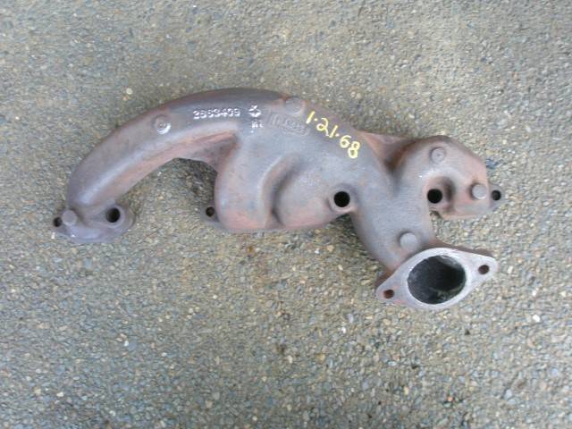

My two cents. I had a set HP manifolds sitting around so I put them on my 68 NYer. I cannot count how many times I've said in hind sight that I should've stuck the LP log manifold back on it. The passenger side is fine, but the driver side is a bit of nightmare if you don't have the correct "C" body manifold. I had to change exhaust flange gaskets. It took my son and I forever to do the driver side because it's just difficult to get to the second bolt. For what so it looks sexy, as Trace said above, I don't open my hood except to check or fix something.

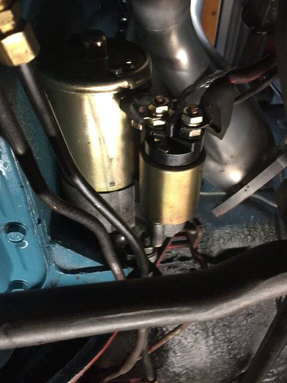

I have installed the TTI Shorties in a couple of cars, shorties require a special starter from Robb MC (more cost), also will have to grind the block for starter to sit square. If you are not constantly 1/4 mileing your car Manifolds are good enough.
