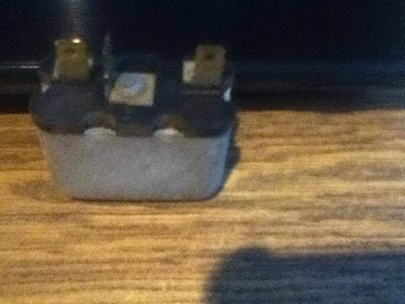

From what I understand the four-ways (hazards) and turn signals are controlled by two different flashers. This is the turn signal flasher. I think my died, the lights energize when the turn signal stalk is actuated, they just won't flash on and off, they stay on during a turn when the signal stalk is pushed down or up when making turns....and the stalk will return to off position once the steering wheel returns to straight and lights turn off as they normally do.

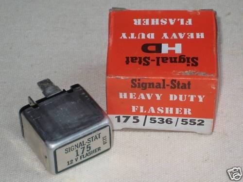

I think the proper name for this part is a "Signal-Stat 175 turn signal flasher". Here's a NOS example.

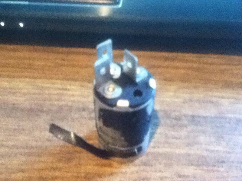

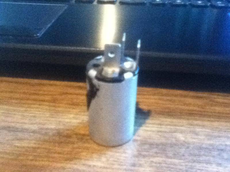

This is the kind I usually grab...They have either a 2 or 3 prong set-up....depending on your wiring.
Yeah, those are the hazard flashers. I just replaced mine before Carlisle as it seem to be getting somewhat weak when flashing. I'm still trying to locate the square ones which plug directly into the fuse block itself. All the usual sources only had the hazard flashers. Also looks like (from what Im seeing on Ebay) these things work in other cars as well (corvettes, fords, etc).

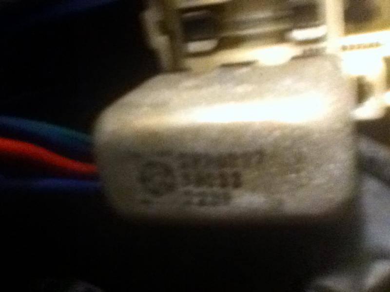

Yes, it's my 70' Newport. Perseverance pays off. I found...it, and yeah it was clipped exactly where you said it would be...looked untouched all this time. I had it confused for the hazard flasher. Sucks having to replace it.

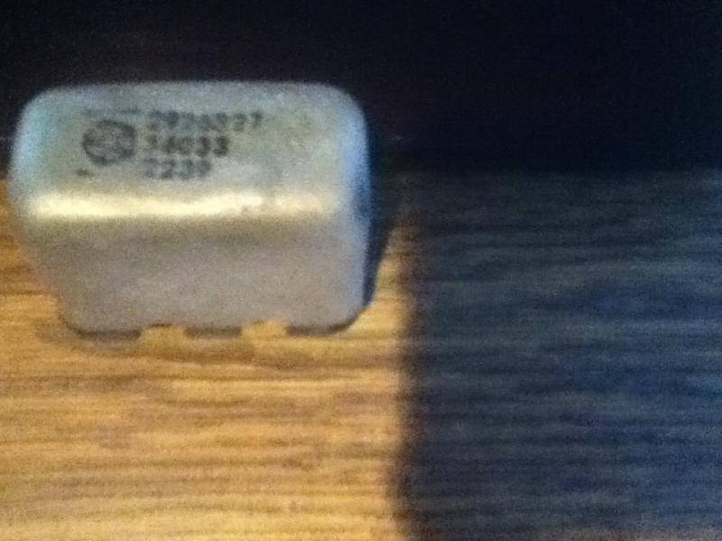

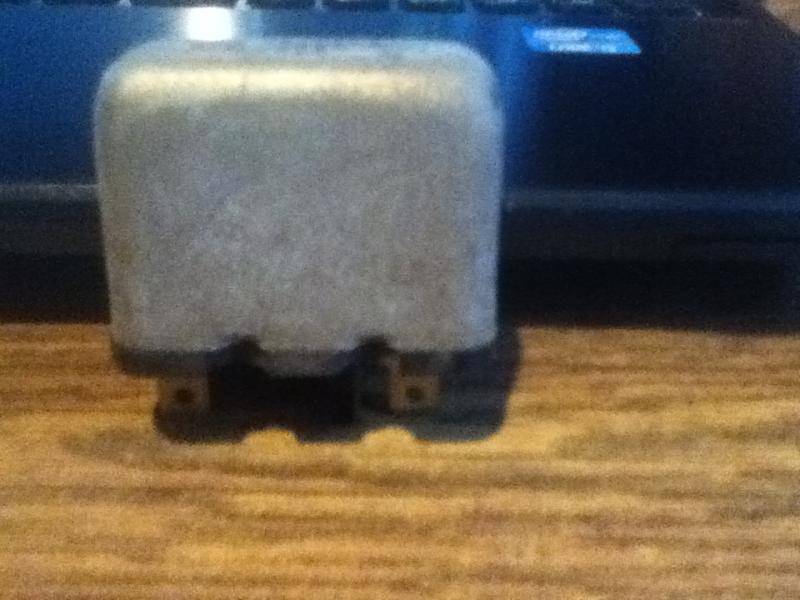

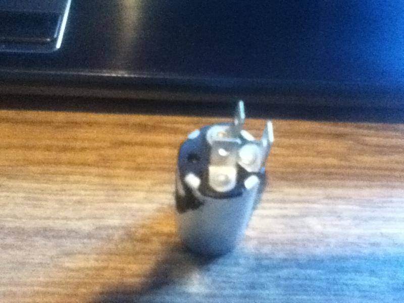

Looking for this guy. Prong configuration/spacing seems to be unique from what I'm finding on the i-net so far. Found a two prong flasher unit that supposed to be a direct replacement (modern/upgraded version?)
That there is not your flasher relay. That is the interior light time delay unit. This is what power the steering column light, that comes on when you open the door. You then have light to see the ignition.
Thanks for the guess, but it can't be impossible. I don't have time delay on the interior lights. Close the doors and the go out immediately. Nor do I have a steering column light. The only lights that come on when the door is open is the ceiling light, and the dash reading lights. They are all controlled by a rheostat when the doors are closed (if you need to turn them on). I kind of wish I did have all that stuff....but this a lowly Newport, not a LeBaron,lol.
Back to square one. It is really becoming difficult to find this bugger. This has to be the turn signal flasher (it is not the hazards). I've seen these all over ebay for Fords, Corvettes and other mopars (pre-65). Someone has got to be re-pro'ing these. Last resort: pack a lunch, head down to WV and try to scavenge what I can find from some of the fuselage cars in the woods.
