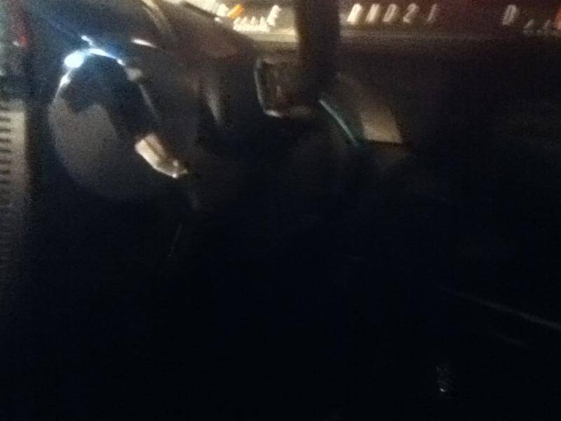

Take the lower cover off the dash by the steering column. See the red wire coming out of the harness connector from the steering column? Follow that wire to the flasher. It should be on the left of the steering column.

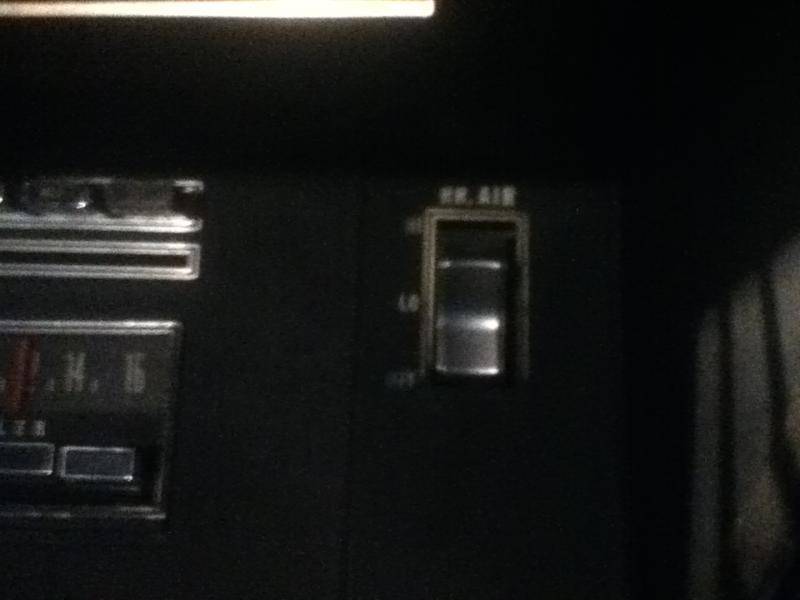

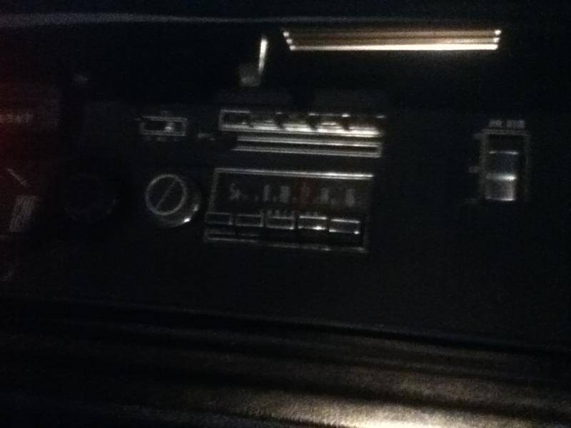

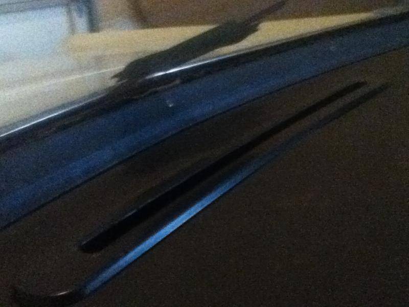

Thanks Bob, I see what your saying. However, I don't have electric filament in the rear window as a defroster. There is a motorized blower underneath the package tray with a wide vent located just at the bottom of the window. The switch for it is located on the dashboard next to the A/C controls. It blows (off/lo/hi) warm air enough to melt a good amount of snow clean off the glass surface, adequate enough to see everything behind me. There is no time delay on it. When the switch is flipped off it is disconnected immediately in all scenarios. Also I've yet to find an ignition key courtesy light, there isn't any. So, if this is a delay device, what is it delaying?

That time delay is for the ignition light. The light is underneath the steering wheel, so it may be burnt out and you just never knew it was there!
That would definitely be cool if there is one there. I'll check it out later. None of that stuff is in the sales receipt/description either. But if not, I have a mystery on my hands I guess.
It is a black looking nub just below, and behind the bottom of the ignition cylinder. Pretty much every mopar after 1968 had this as standard fair. Sometimes this time delay also controls a "Fasten seat belt" light....but that was generally mid to late 70's.
If so its been inoperative all this time (wow), which gives me a reason to get under there and fix it. Thanks.
