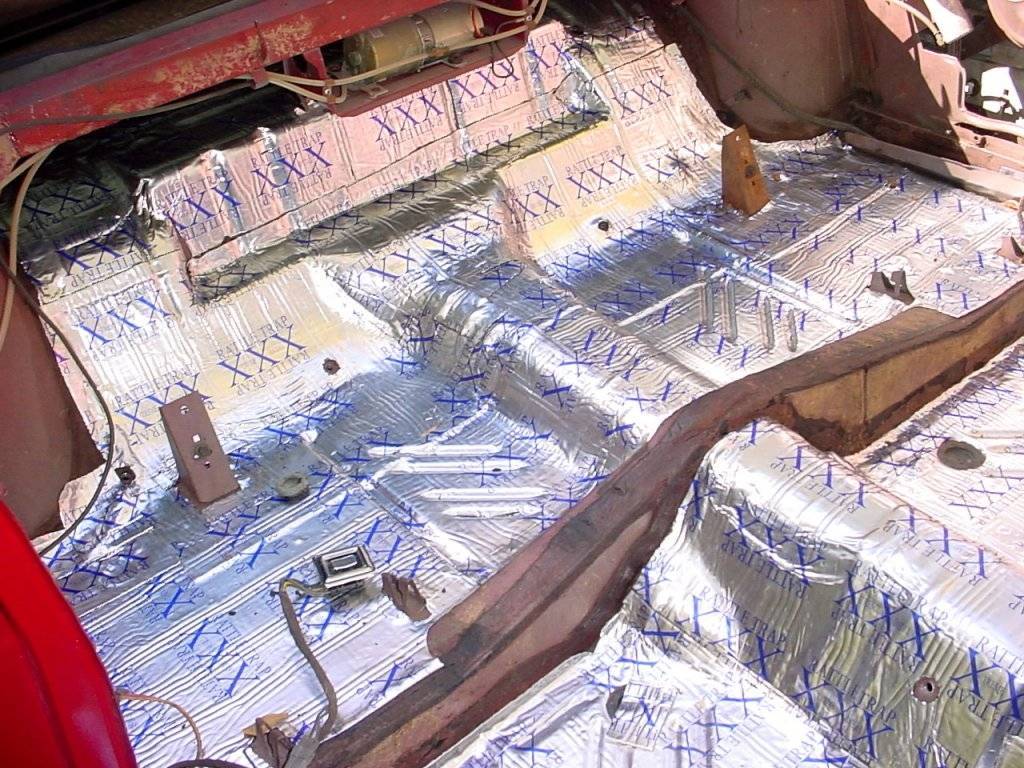

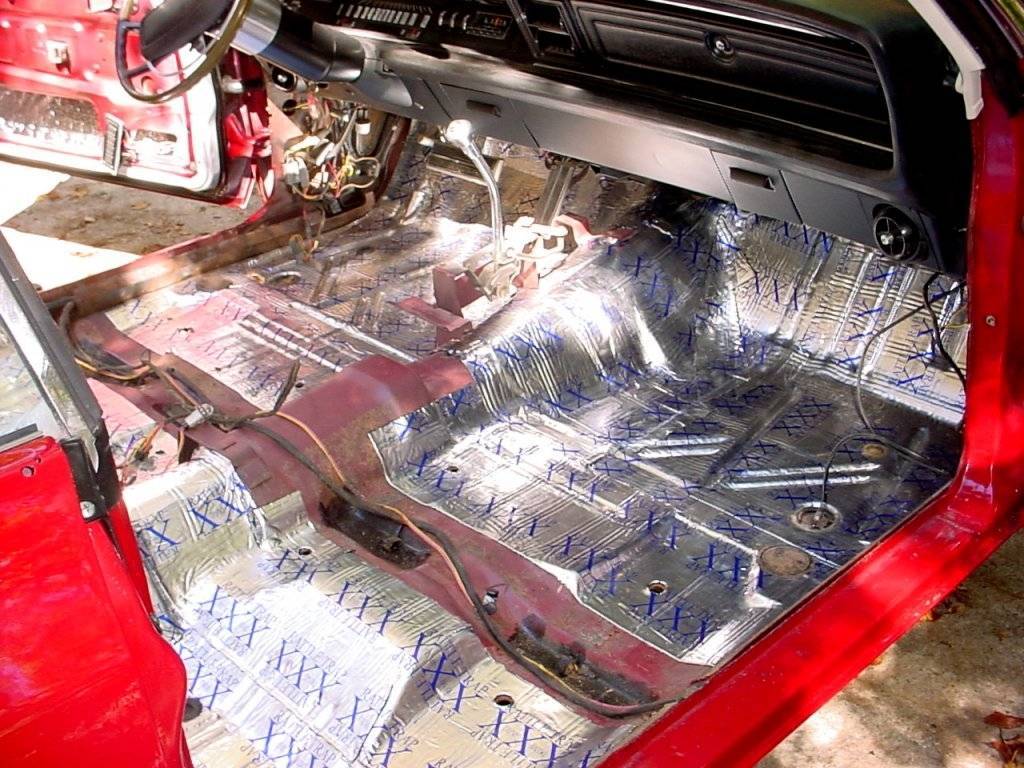

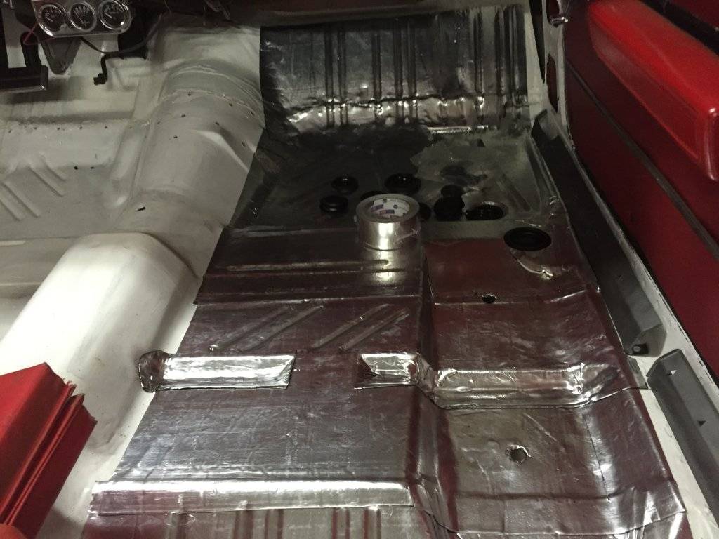

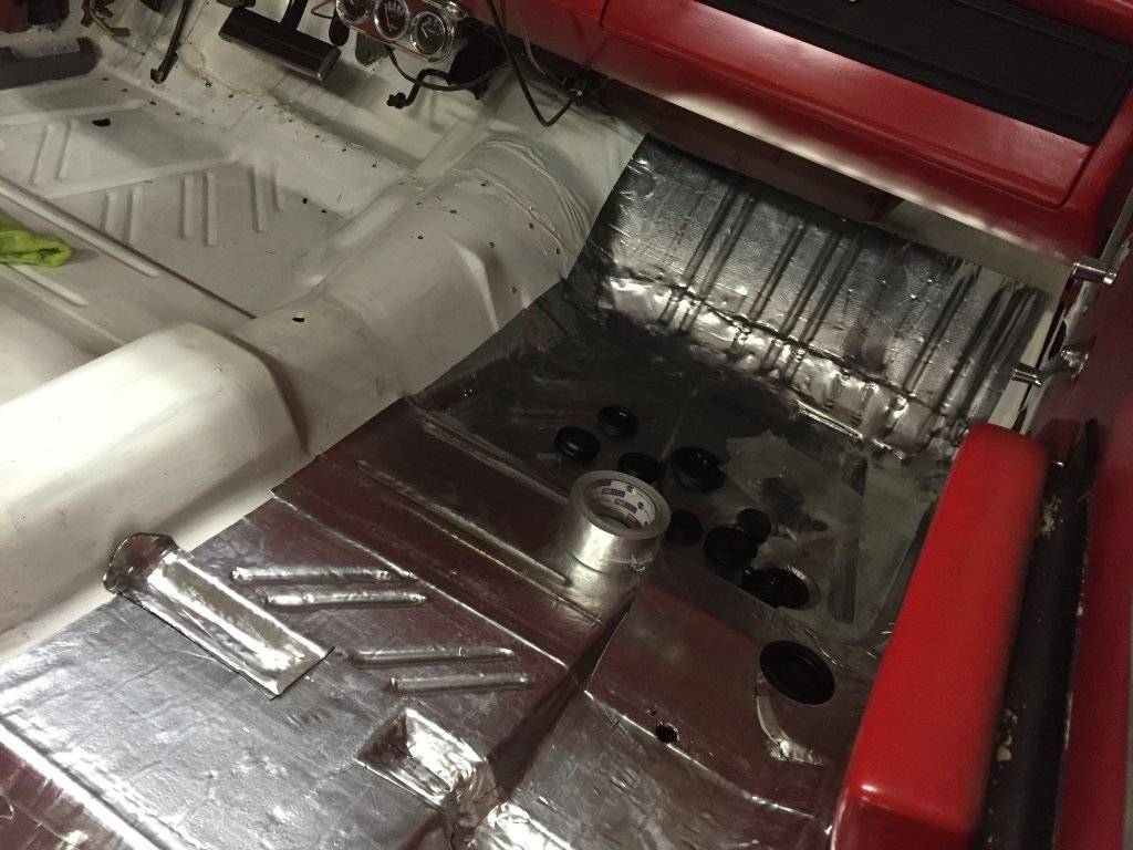

    I installed sound deadner in both my 69 300 convertible and 69 Fury wagon. It was very effective in both applications. I think the heat transfer through the floor pans is the best advantage. Noise transfer is improved noticeably. I used "Fat Mat". It's identical to Dynamat but half the cost. You can find it on ebay.
    I would figure on about 50 sq ft.

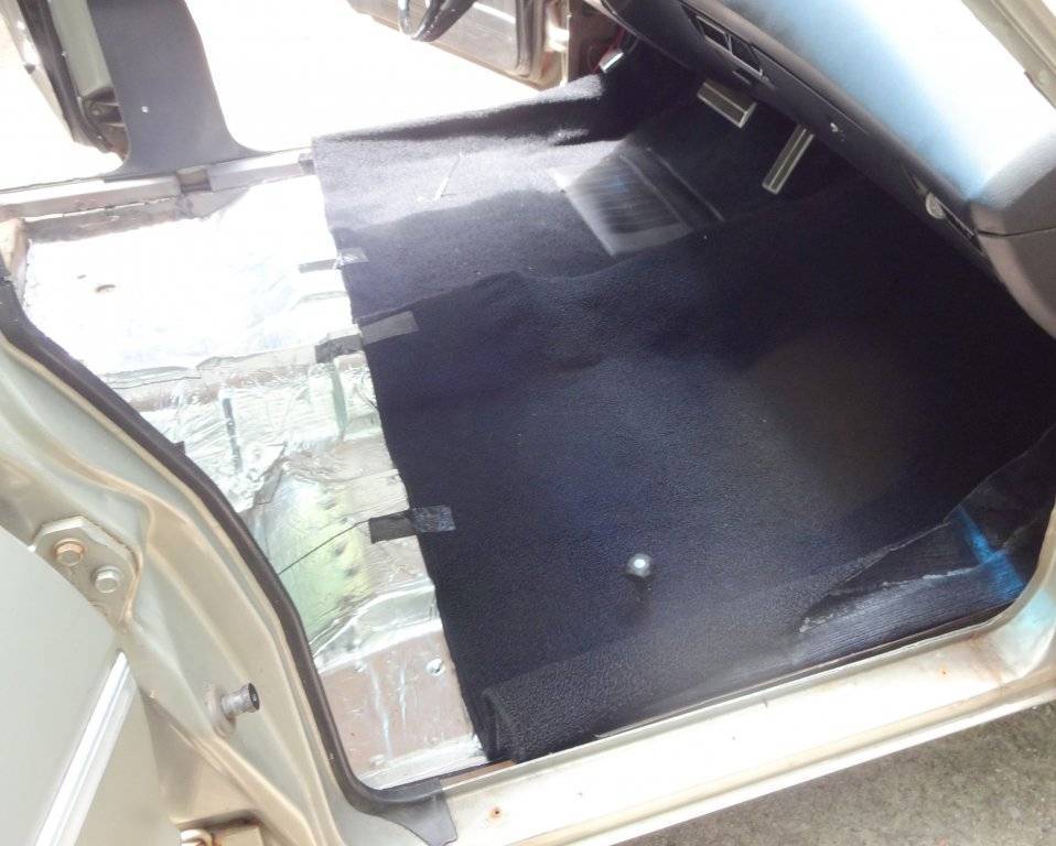

    I used Rammat and their Ensolite product. Helped tremendously with road noise and door rattle.
    Rammat.
    [​IMG]
    [​IMG]
    Ensolite.
    [​IMG]
    [​IMG]
    Doors. I also put a strip of Rammat on the interior of the door skin.

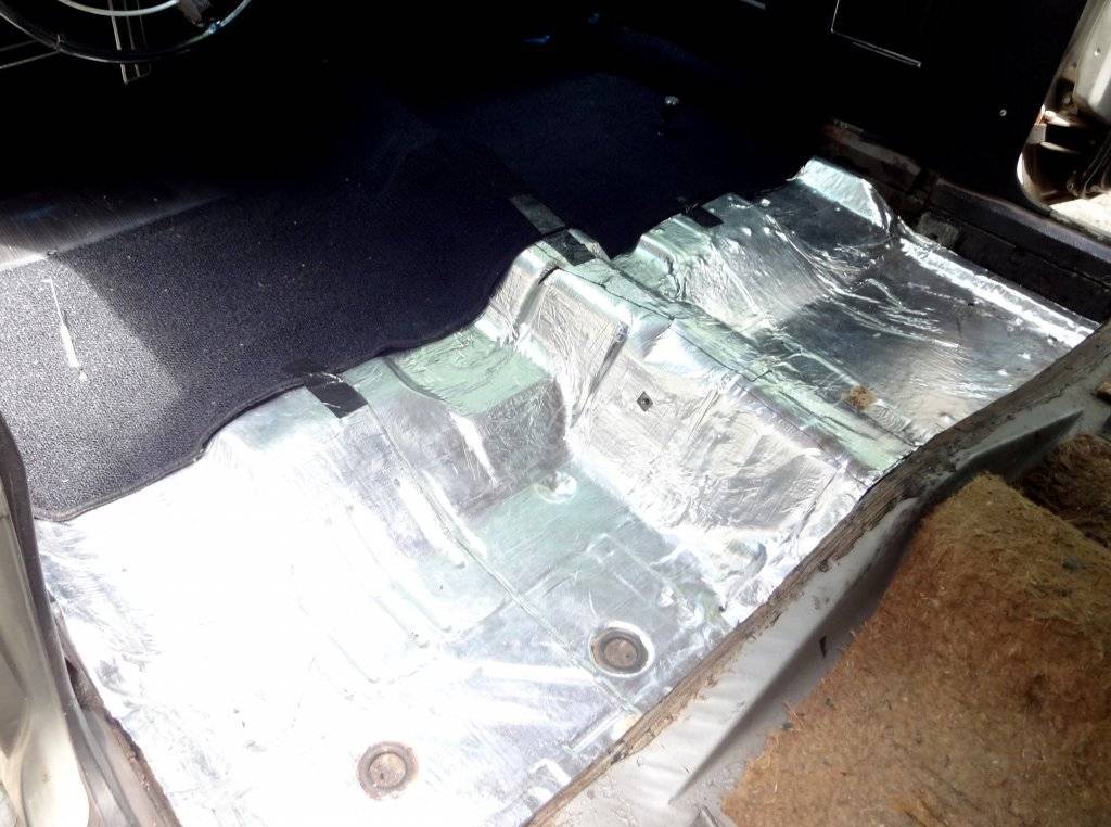

    For my 70 300 vert, I used FatMat and topped it with Ensolite. I also used FatMat in the doors.
    Overall, it was a night and day difference.
    I also did the trunk floor with FatMat later on, but I really didn't notice any improvement.

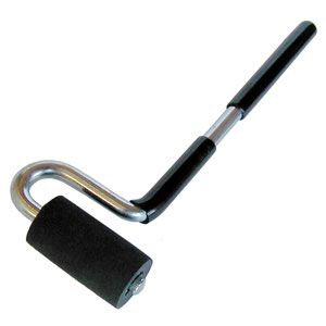

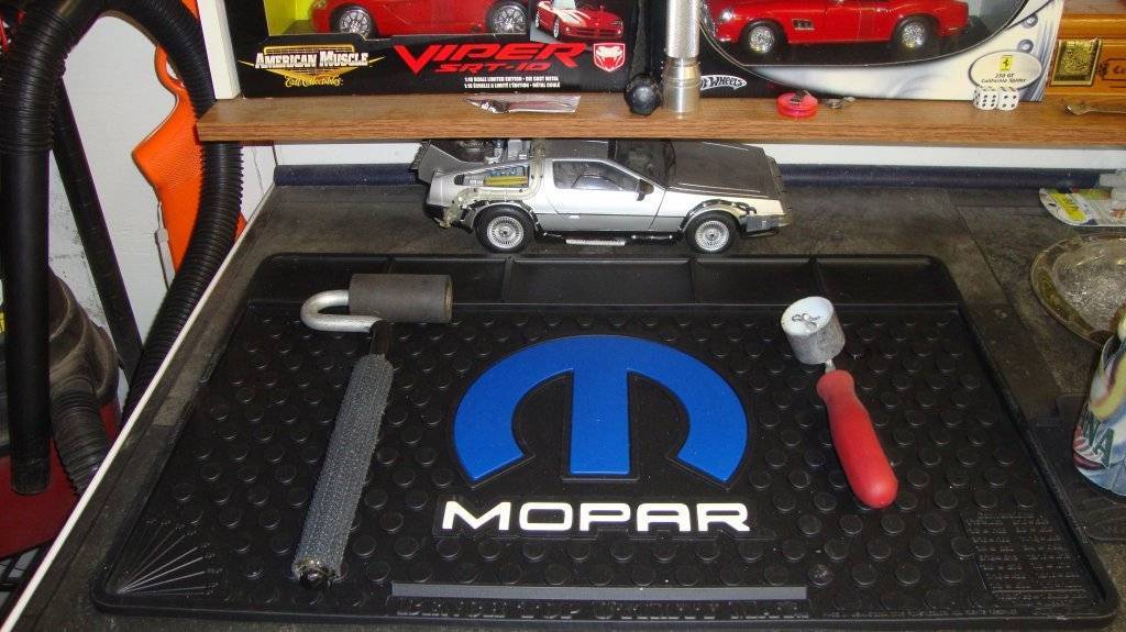

    If you buy the FatMat, the roller that comes with it is just about useless. Get a J-Roller that is used for laminate counter tops. It's about a million times easier to use and the end of the handle is the perfect size for pushing the mat down into the grooves.

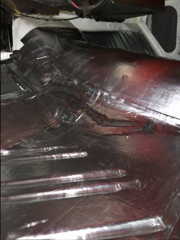

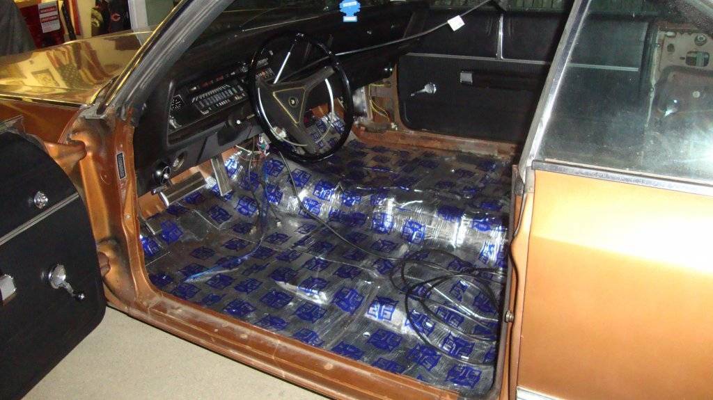

    Used it in my 66 Polara Convertible. it really help control any body sounds
    I used GT Mat.
    No more warm feet either

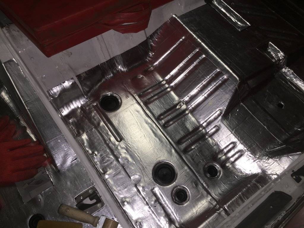

    x2 for fat mat and a j-roller...
    pic comparing the crappy roller Big John eluded to vs the j-roller...

    Why did you do the cross supports behind the rear seat?

    figured it would help with noise reduction/vibrations coming from the trunk
