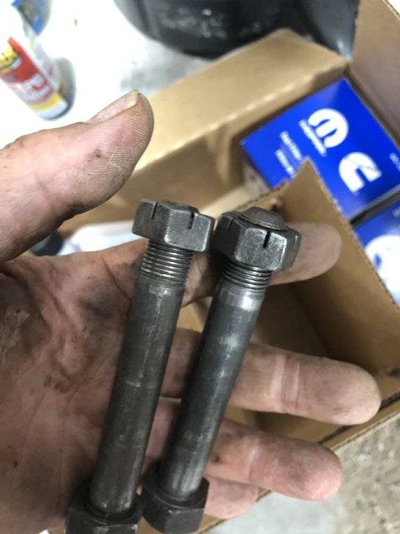

I cleaned up the front spring eye bolts and peened the corners to make the threads lock again. It’s medium strength thread locker time too. I won’t tighten them until the weight of the vehicle is on the suspension. In fact, they’ll not be “tight.” The springs and bushings on a drag race car need to travel freely or you’re asking for trouble at the starting line.
- dad
Specifically, I mean a leaf spring suspension should not bind. Shocks and Caltracs are used to properly and safely control suspension travel. The pivot points must be free to pivot, but not wobble around.

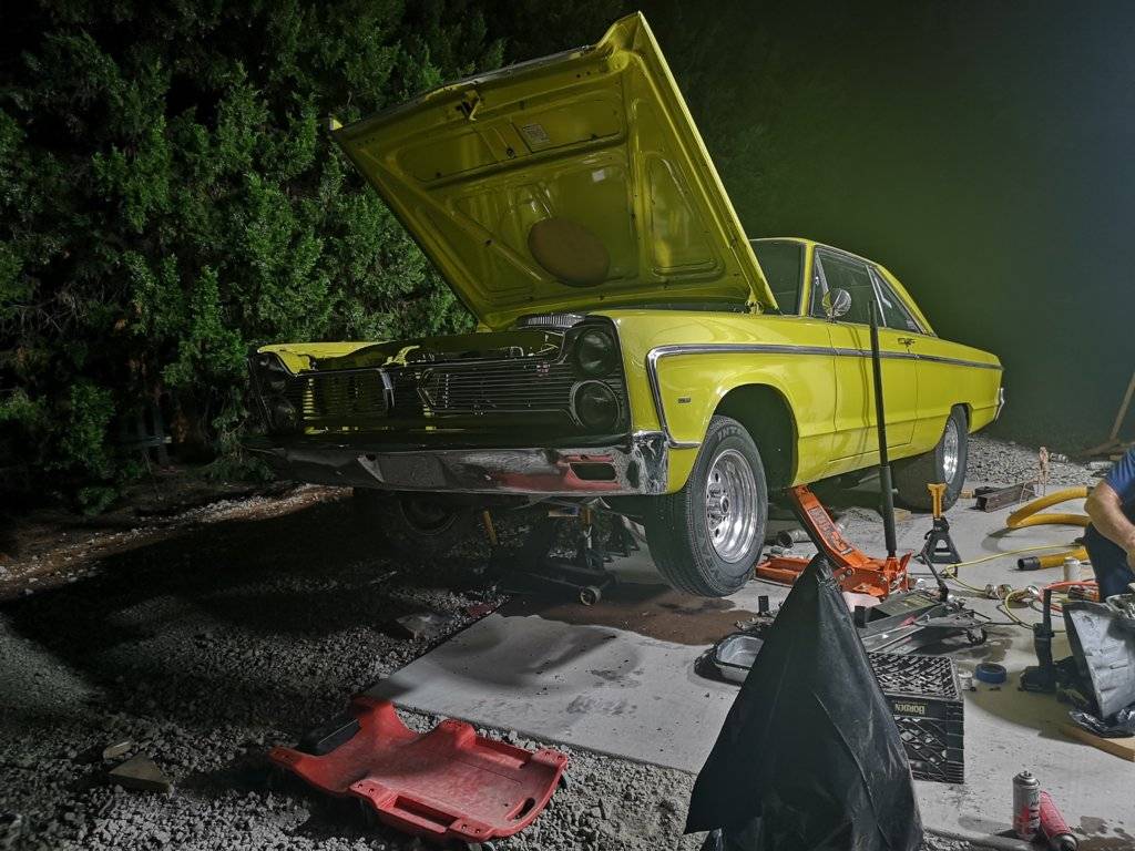

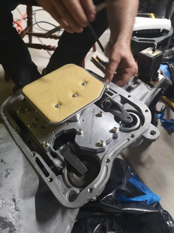

Hey folks! Dad and I have been working on Rush every day for the last two weeks. We are working on swapping transmissions and eventually getting a measurement for a new driveshaft. Good news is the old tranny is out! Bad news is the new tranny has issues... Sort of. The trans is aluminum cast thus the threads for the pan all need to be helicoiled. Lots of prep work tonight to get it ready to go in. More updates will follow soon!
Also, for those who care, I am starting school in Ohio again this coming February. I've realized that working on cars is my passion and there's nothing I'd rather do with my life than that. I also got a new dog named "Hemi". He's a blast!

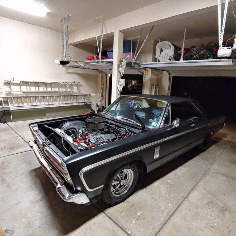

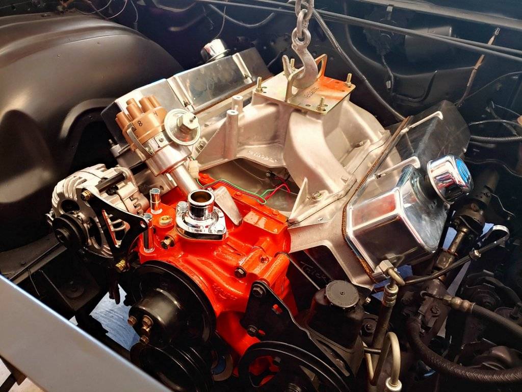

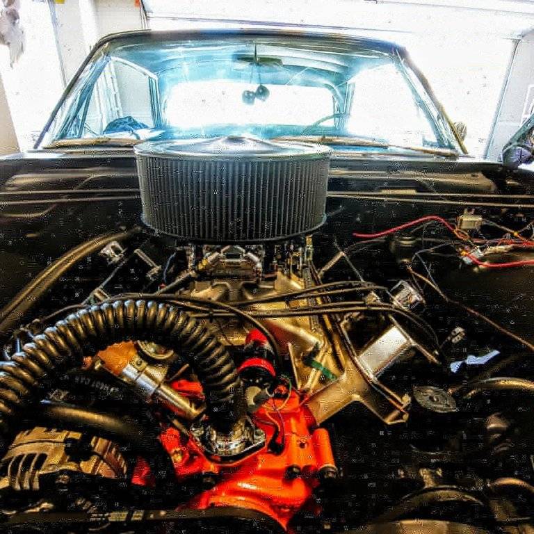

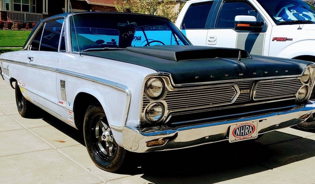

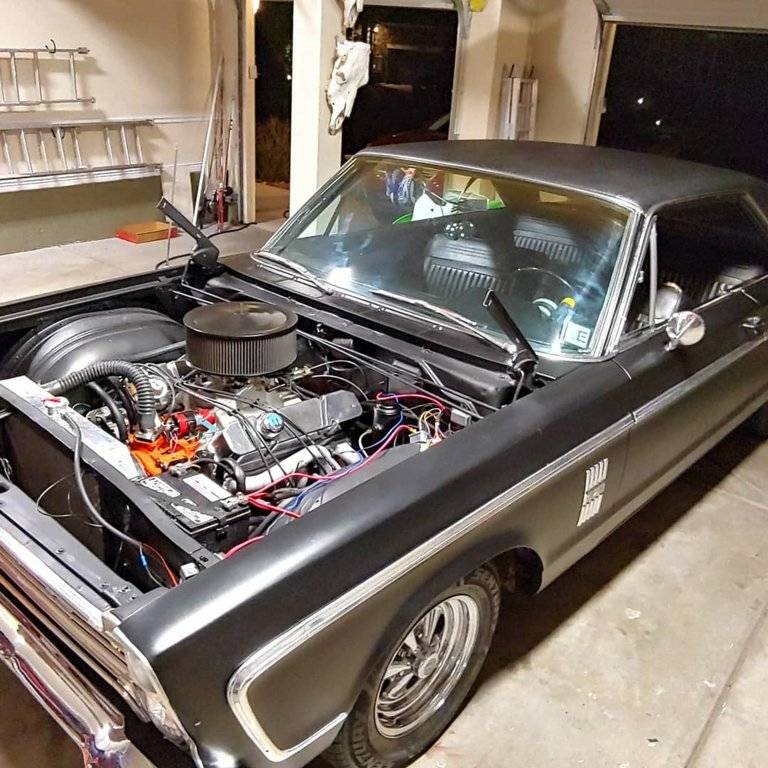

Horvaths, almost got mine finished as well. Still have plans for fuel cell, electric pump and 11050/1200 cfm carb and brake upgrade but that's next yr;) Your car is coming around very nicely! Here's mine so far, 505 stroker
Well no dyno numbers bc I don't want to waste the cash till the upgraded fuel system goes on. I'm in Co so I loose a bit but sea level was aiming for mid 6-700 at the wheels. I can tell you it pulls the driver side front right up and it just roast the tires sides just about,
Looks great man! Any engine pics? Power numbers?
so with some slicks should pull even harder;)
Powernation Magic 512 build is what I model it by;)

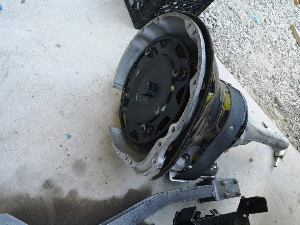

Transmission is in! Still need to put the upper bolts in and mount the torque converter to the flex plate, but I'm pleased with our progress for the night.

We are too! We got it bolted up and almost ready for fluids. We’re going to need to get a few odds and ends done, like flexplate to torque converter bolts, cooling lines, and such. Then we can let it down and take measurements. The only catch to that is the fact that the rear suspension isn’t fully tightened up and the shocks haven’t been relocated yet. It’s all good, we will get it close enough for government work.
