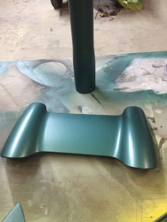

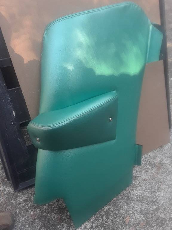

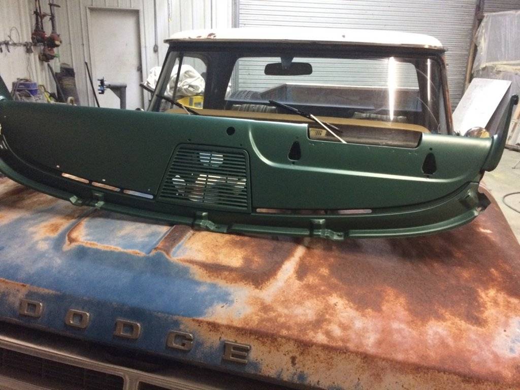

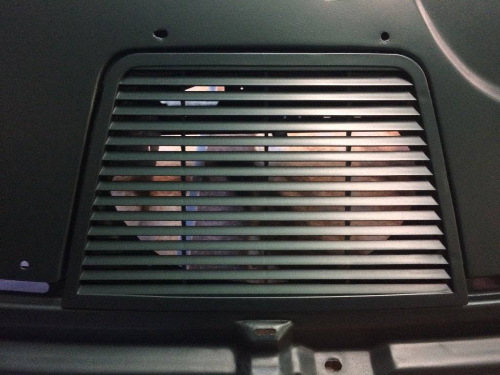

My body guy sent some pictures of the freshly painted dash and kick panels. Looks like a dead on match.

I visited Virgil this afternoon. Coming along nicely but a long ways to go yet. I brought the newly painted dash parts home to reassemble once i return home from Gulf Shores.

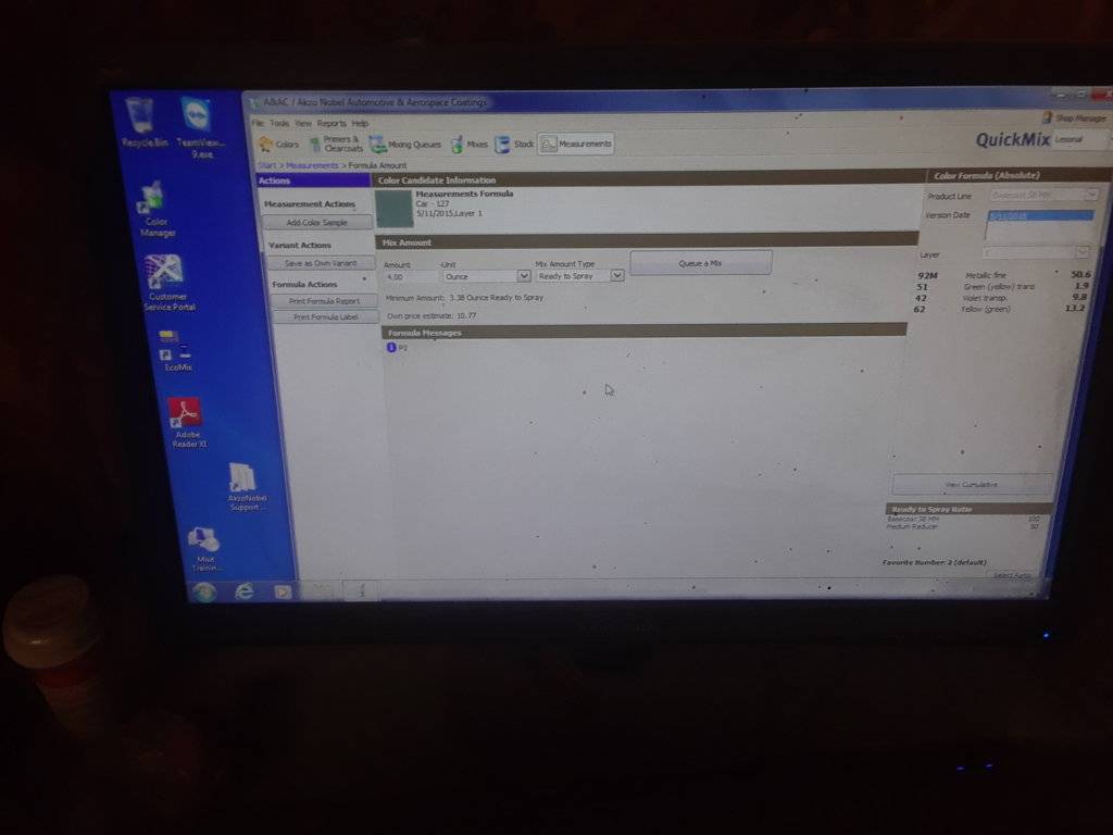

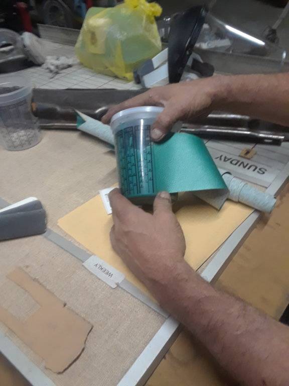

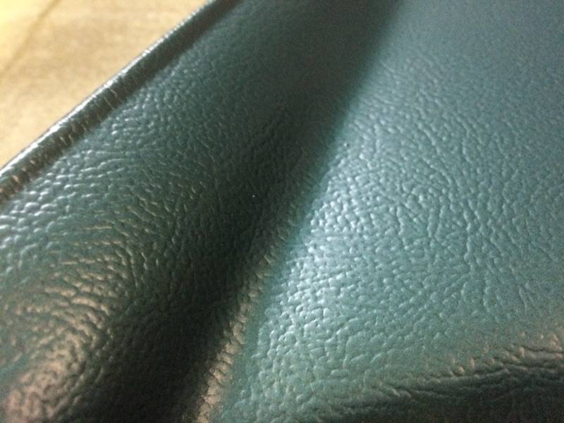

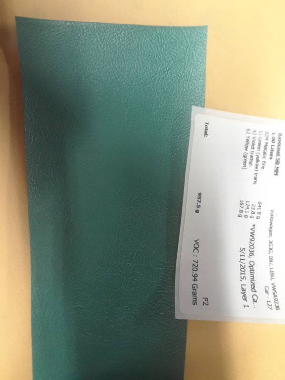

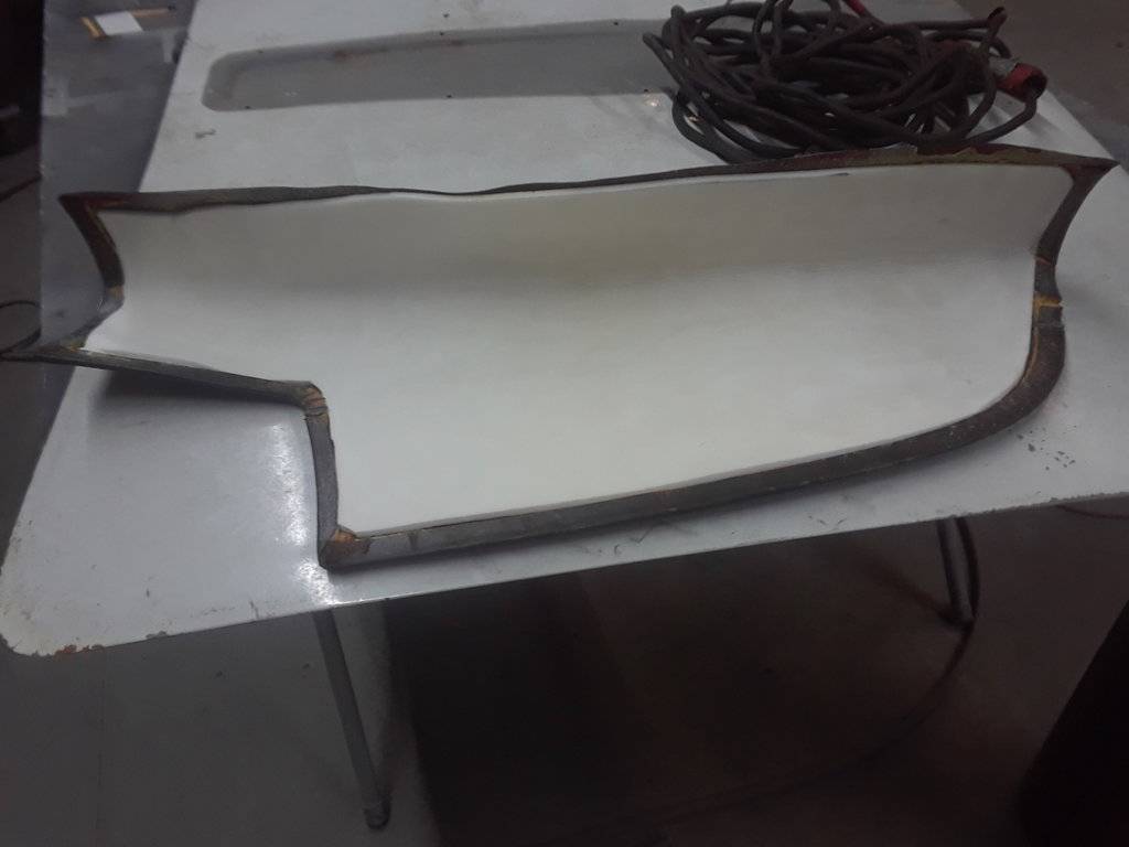

I also replaced the padding under the dash pad. Used a section of vinyl top padding my trimmer had laying around. Worked perfect. Using a piece of scrap interior vinyl, my painter was able to obtain a exact color match on his state of the art, computerized Gucchi color scanner equipment. Once the formula is converted to mar hide he can paint the dash pad to match the interior panels.
