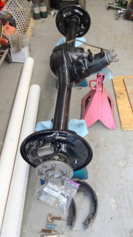

Virgil's rear axle going back together.

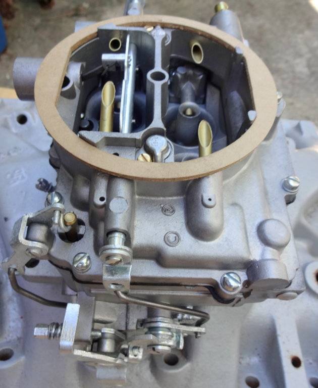

Hey bluefury361, I have a favor to ask.
I am using the same Carter 3103S carb on my Slant 6 Valiant project (it came with the engine) and I don't understand how the throttle cable or linkage attach to the carb as there is no hole or stud on the upper end of the throttle lever.
The only thing that makes sense to me is that it must push forward on the lower end of the throttle lever.
Do you have any pics you could post ? Thanks

You would be correct in assuming that. Up through 61 the linkage "pushed" the throttle open from below the pivot. 62 and later used a cable and pulled the throttle open.

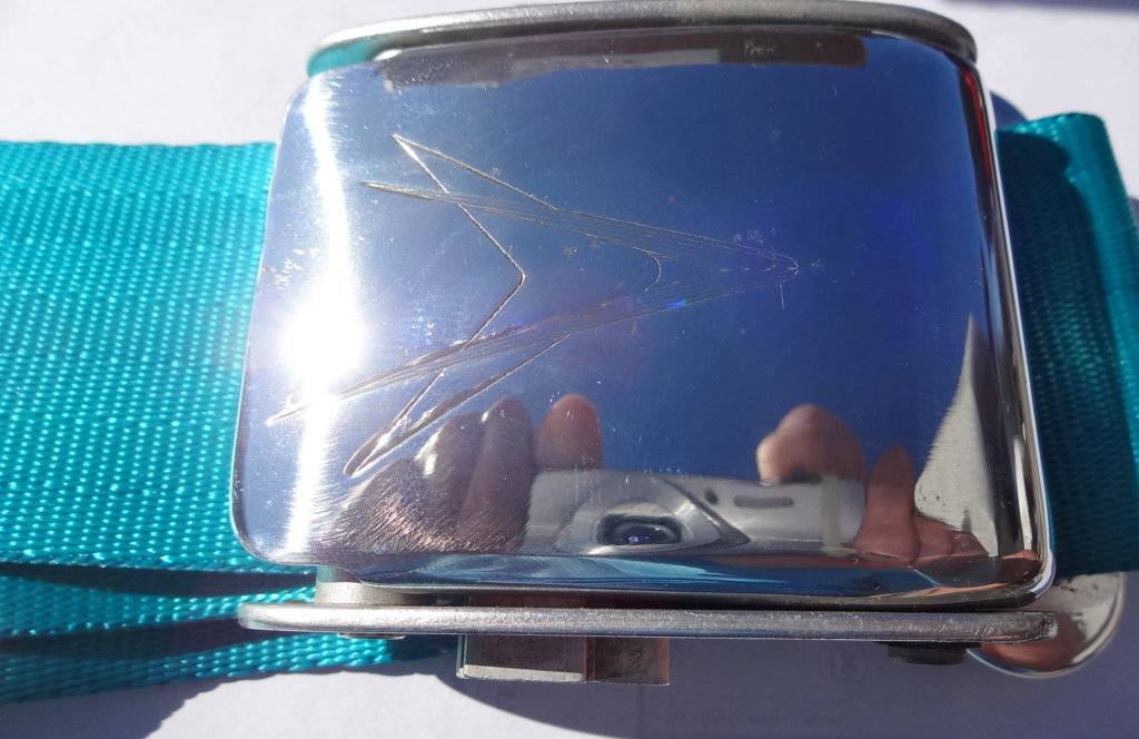

Just a small step..... Virgil's seat belts, ready to install. New webbing and very rare polished "forward look" buckles.
Thanks to the chief Bozo's partial government shut down Virgil's restoration is on hold for awhile.
