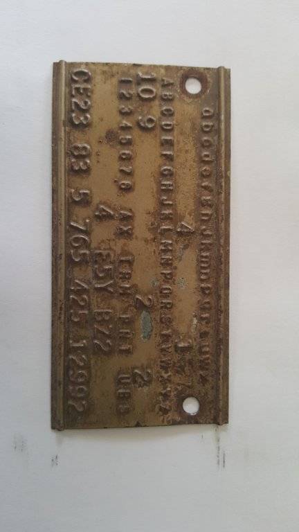

In a '66 Chrysler, a 'J' code is a 440. . . A code '82' under the 'AB' position on the fender tag indicates the engine is a TNT 440.

I have a 67' Newport here also with the 440 TNT engine. The car is a bare bones Newport, manual steering, and power disc brakes, no A/C, and Gold with painted black Top.
CE23L77xxxxxx

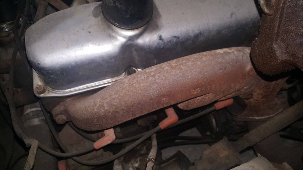

here is a picture for the drivers side 440 TNT c body. It differs slightly from the 68-69
2863409 driver side. The correct Number would be 2843247. You can see it doesn't wrap under the column as much. Fender tag as well.
