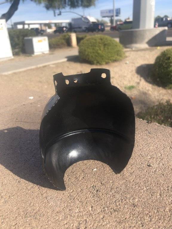

This is a part from a 65 SF. Steering Column?
I just happened to have the '65 Parts book open and on illustration 19-15, you'll see that it looks like the shield around the coupler on a tilt wheel column.

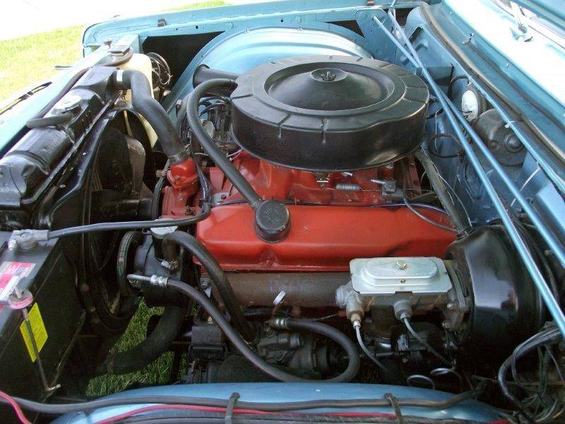

As @Big_John said it is the heat shield, but for non tilt as well. You can see it just below the MC as installed on my 300.View attachment 573319
Yea, I didn't look at the applications, but only saw it illustrated on the parts diagram for the tilt column.
So... I had to look and yep, it looks like across the board for the C-bodies. Section 19-15-111
Just a FYI . . . there are actually two versions of this shield. The earlier (I believe) version was solid, and retained on the steering column by a clamp. The later version (as seen above) was attached by three very short screws. I think the change was made around 65-66 model year. So, if you're looking for that last 0.01 point at the Concours . . .

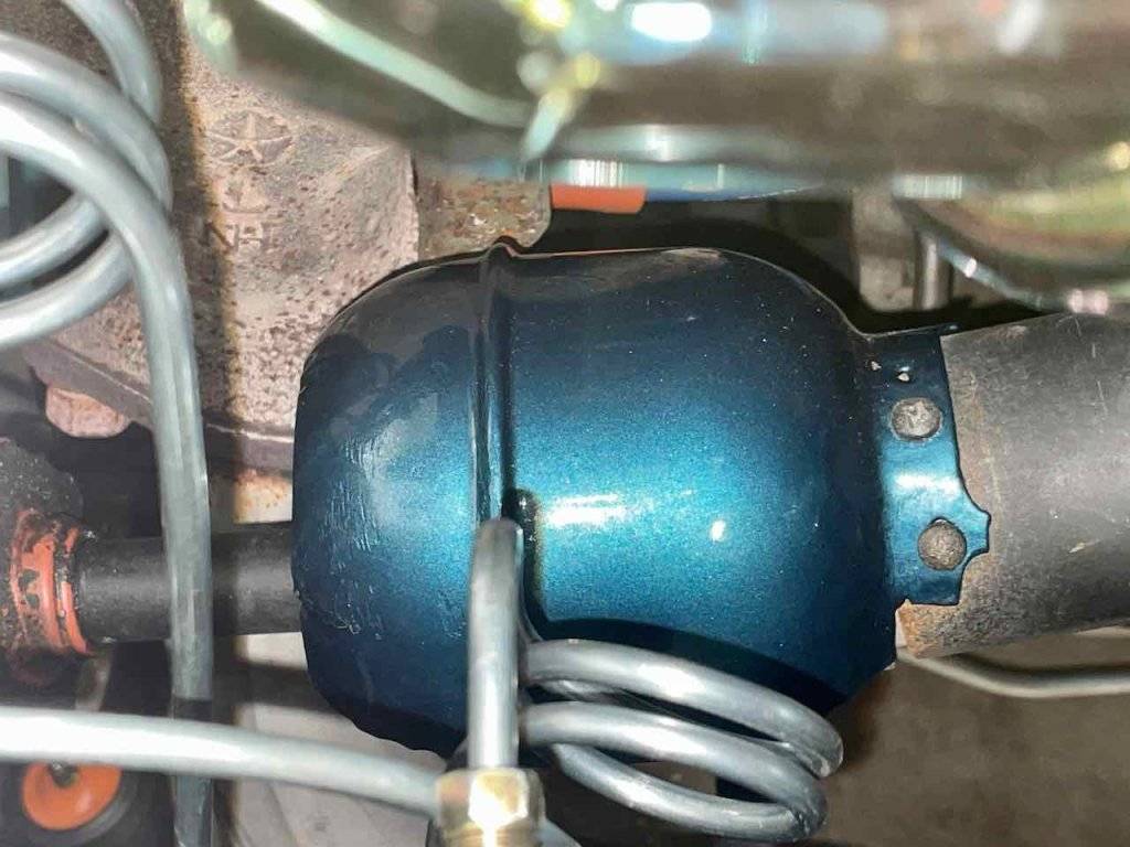

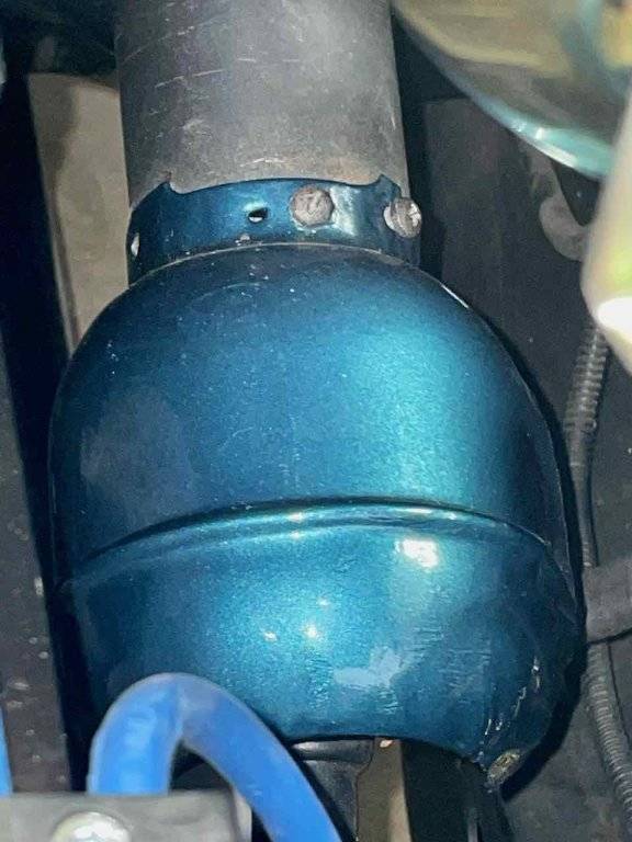

My 66 has the same thing, hope these close up pics help a bit. Only have 2 screw holes on mine for some reason though

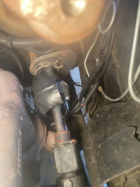

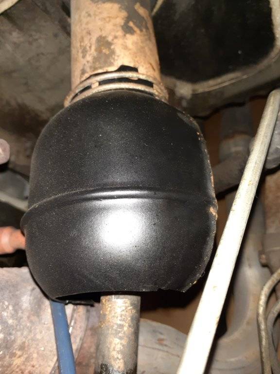

I had to replace my shield - found out that the PO had simply pushed it on tight on the column - I hadn't noticed, and it fell off, and I ran over it! Sourced a used one, and I wanted the Corbin appearance, as it was an early 65 build. Found that one of those wire-type hose clamps looked pretty close, if you tuck the tightening screw down under the column. I don't believe that my early column had any holes which would permit using the screws to attach . . .
Finally got down to take a picture. This is with the large wire-style hose clamp, since I wasn't about to pull the column just to place a Corbin clamp . . .
That looks fine! Who the heck is going to know except the handful of C ody arseholes like us... and if any of us crab about it, you can tell us to f off!
:lol:
Nicely done!
