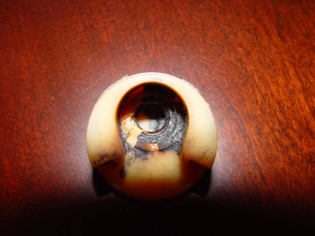

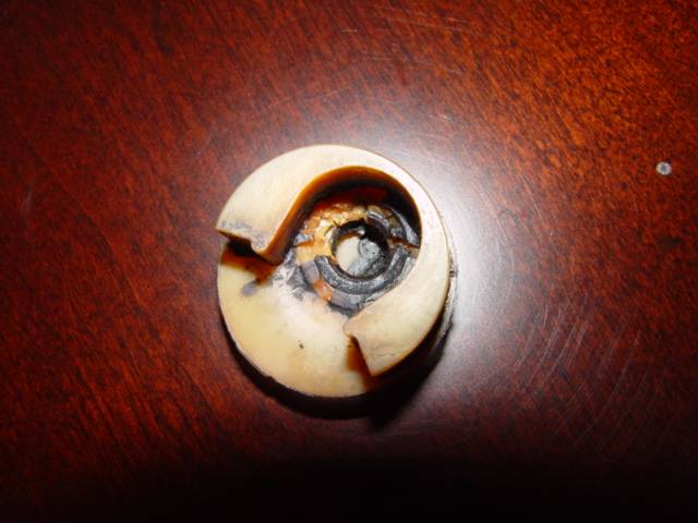

The tool & diemaker curiosity in me just perked up... What does this bushing look like?
Interesting.... I wanted to see if it would be easier/better to machine one from UHMW or Delrin.
If I were to cast a copy, I would think about a steel insert to reinforce the plastic... maybe even use some sort of fiber strands to reinforce... But I'm just thinking out loud.
So I understand is the outer plastic the only thing that falls? If so does it snap into place around the rest of the piece? Is there multiple plastic moving parts?
Nope, it's the inner piece that fails. It will have to be made of plastic. Any kind of metal construction won't work. It has to be able to expand and contract when going over the nipple plus the heat generated when spinning around will just self destruct if constructed out of anything but plastic.

That's only a third of it... there's all kinds of weird **** going on inside of it....
