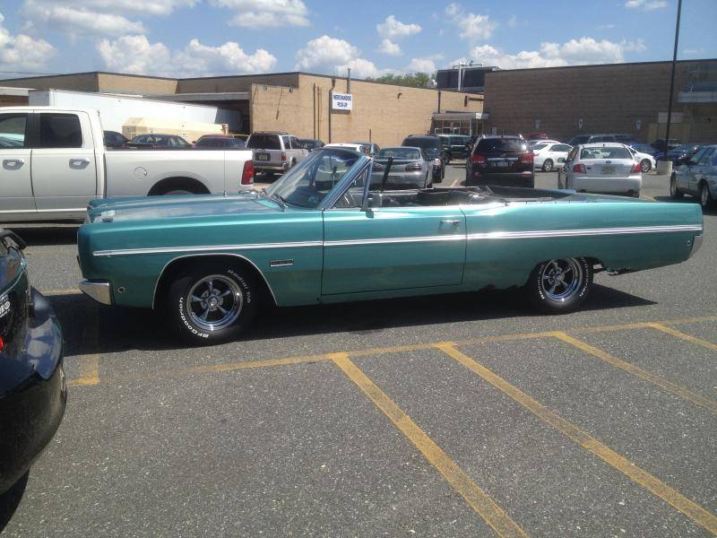

    Thanks for all the advice on my wobble, I finally got new wheels and tires. I went with 15" in preparing to upgrade to front disc brakes. No more wobble wobble! After looking more closely, the old front passenger tire had a visible bubble.
    I think it looks great. I was looking for something similar to what the factory had on the '68 Sport Fury.

  14. BIGBARNEYCARS
    BIGBARNEYCARS Senior Member FCBO Gold Member
    Messages:
    3,994
    Likes Received:
    2625
    Joined:
    Dec 10, 2012
    Location:
    SHADOW OF MOTHER'S PROVING GROUNDZ
    UH-RAH, No more Russian Roulette. Good on you, We're all happy for yeah now. Doesn't mean there might not be ah few other issues. to check at your convenience tho'. It's called preventive Maintenance or P.M. for short and it never stopz. Enjoy your Drop Top these summer monthz, It'z lookin' good. Jer

  15. tallhair
    tallhair Rufus "Mod Hair" Firefly Staff Member
    Messages:
    9,226
    Likes Received:
    2530
    Joined:
    May 12, 2013
    Location:
    Mascoutah, Illinois
    Looks fabulous and the wheels and tires look great
    what brand and model wheels?
    • Like Like x 1
  16. mgm1986
    mgm1986 Active Member
    Messages:
    236
    Likes Received:
    34
    Joined:
    Jan 22, 2014
    Location:
    Pittsgrove, NJ
    Thanks! They are Torque thrust II wheels I think, PVD finish which is apparently the new chrome and supposed to be easier to maintain and last longer.
