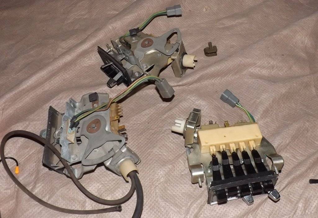

    So I did a bunch of tracing vacuum lines from the engine bay and all through under the dash as well. That is not fun job, I identified a failed vacuum can which I replaced and finally found my vacuum leak. It is in the valve with two hoses going into it on one side of the control switch. I dug out two others and found only one works, so that's the one going back into the car. That's another issue fixed. I still haven't dealt with the wipers yet though.
