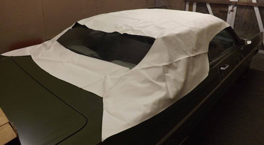

    So I finally pulled the trigger and bought a vinyl roof for the car. It looks good with nice quality vinyl, heat sealed seams and proper proportions. I paid about $180 for it so the price is good too. Made in Virginia by Newstalgia Parts. I won't be putting it on until next year when the weather is warmer. I'm not looking forward to having to pull the front and rear windshields and side chrome again. Blah.

    I had not heard of them till now. How does the grain look?

    Remove glass to install the vinyl?
    Maybe Formals are different.....the glass didn't come out on my 78 NYB to replace the vinyl.

    I don't think you need to replace the glass, per se. Just the trim. However, it'll be difficult making sure you have enough glue on those ends and applying enough pressure to get it tucked in the channel.

    I had a choice between Levant and Elk, the original vinyl was Levant so I went with that. It looks the same as the original samples I have.

    Yeah when I removed the original vinyl off the car it was glued in place under the trim clips and the trim clips screw in before you can put the glass in. Some of the 71 model clips are the type that push on though but not all.

    That's right. The trim clips do get put in on top of the vinyl. You would think I'd know that seeing as I just installed mine a few months ago. How soon we (I) forget. haha.

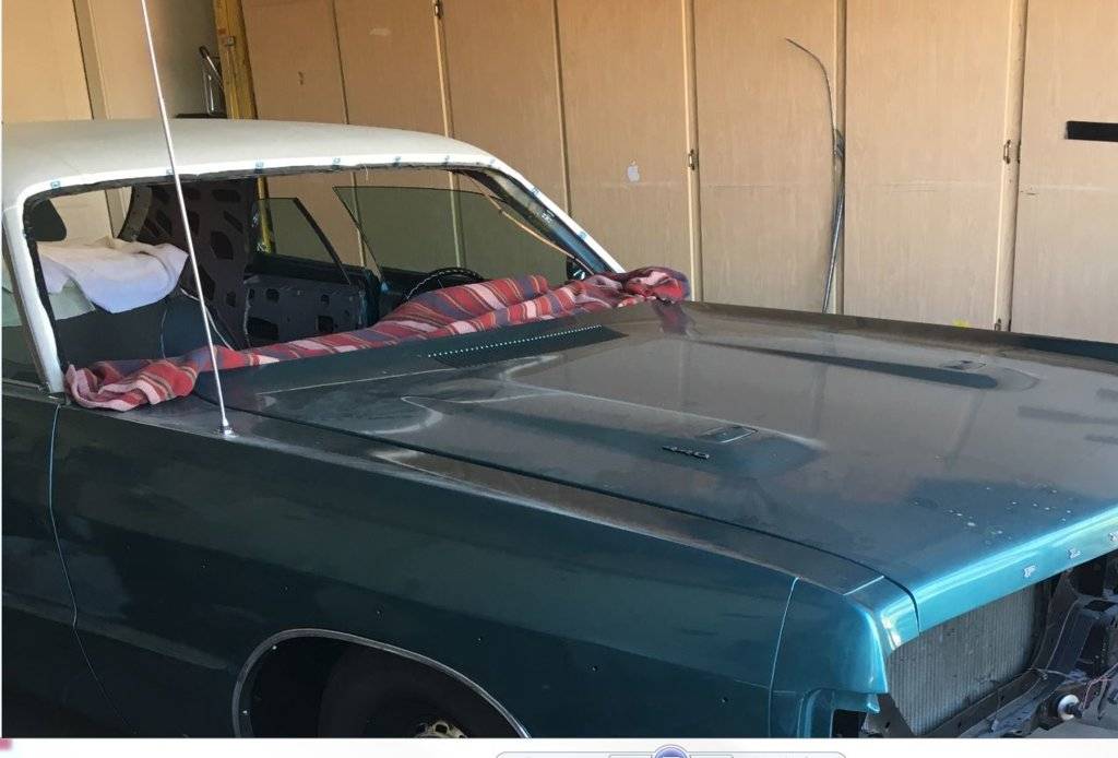

  20. 70Tom
    70Tom Senior Member
    Messages:
    1,259
    Likes Received:
    377
    Joined:
    Feb 13, 2014
    Location:
    Phoenix, AZ
    Think you can see em here.... Light blue clips in the front, brown clips for the back. For '70 at least.
