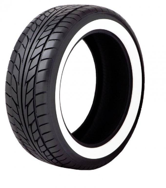

If it's any help I run the 15x7 wheels with the voluptuous 255-70 15's basically the same circumference as the 235-75-15's but with more girth and rubber on the ground, with no sharp turn issues what so ever and my car is a 66 NewPort.
Will never work. Need another 4-5"

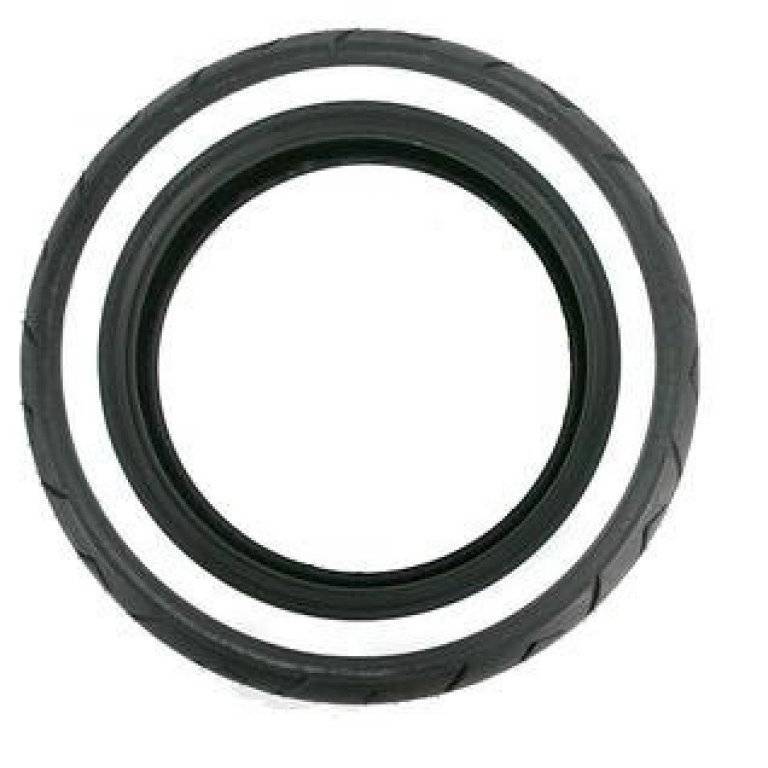

i was just looking cuz thought you'd photoshop a 17" road wheel/tire combo and put it on a C.
i never thought a 28" diameter WW for a 17" wheel existed :). very little demand for such a tire to justify a mold.

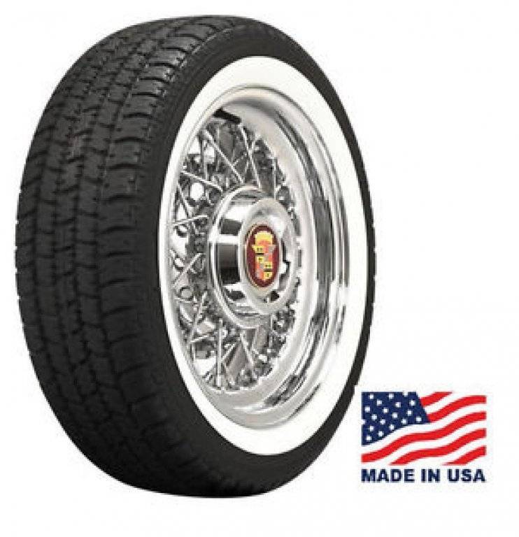

They vulcanize the whitewall on the sidewall of an existing tire.
ah ... that makes perfect sense then. way less involved (time and money) than tooling up a tire mold et. al. to make them the regular way.
