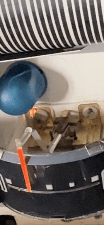

Hey Thanks, it's been a few days since i've had power, it would just come on randomly, i could start the car, when i shut it off, and tried again, nothing, i'm thinking the ammeter is toast, i am going to be working on it again tomorrowand hopefully i find something, does the power run through the ammeter and then to the ignition switch like i think it does ?, Thanks for the compliment on the car, i can't wait to cruze it to the shows next summer.

Nice Car! I had the same problem with my 64 Crown Coupe-turns out it was loose connections at the ammeter gauge. Unless you are a contortionist you will need to take apart the dash to get to it. In that regard, you will want to lower the steering column before you start in order to remove the instrument panel bezel N O T E: Before you lower the steering column reach up and disconnect the cable that goes to the transmission indicator or you will break it when the column comes down. Also, as long as you've got everything apart, this is a good time to replace the headlight switch and replace all the bulbs (yes, I know they say you don't have to but it is MUCH easier to do that job with the instrument panel removed). Good luck! PS I had that car's twin (a Shriner)!

I just loosen the two bolts that hold the collar that holds the column in place. You're just looking for a little more clearance to get the bezel out without scratching the top of the column where the bezel has to come over when you take it out. Some cars are easier than others. For instance my 64 Crown Coupe does not require lowering the column while my 66 convertible does.

Here is a picture of my Ammeter arcing, causing loss of power to the ignition switch, I’m not sure there is a safe way to repair it even with soldering it, I hate to lose the gauge but it looks like there is a bypass going to be done for safeties sake , better to lose a gauge that an entire car.

When my 64 ammeter gauge overheated and drooped I used a propane torch to "melt it" back in to place. I think I did a post on it, either here or on the IML. If you are careful and put pressure (strong clips) between the plate inside the gauge that has lifted away from the floor of the gauge and the floor of the gauge, you can heat the back of the gauge until it becomes just soft enough for the clips to push back in to place. Then, after it cools, when you put the gauge back in the car run a 15 inch or so length of #10 wire from one terminal to the other, then re-connect it. That wire will serve as a shunt to take some of the power away from the gauge and not let it heat up like that again. I did it with my 64 and it is fine now.
