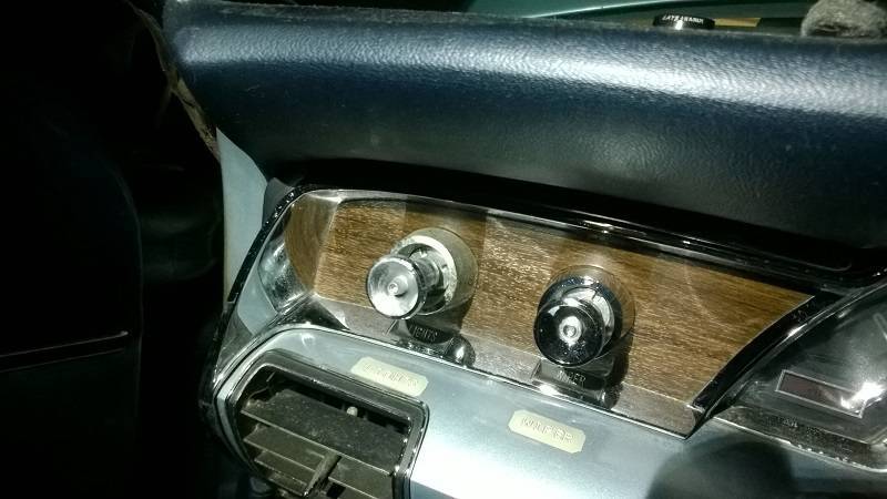

First, clean-up of all the interior chrome trim, and removal of old residue from a previous unsuccessful try (date unknown). During that operation, I found some paperwork in the glovebox tray that I had missed before. There, I found the owner's manual with the delivery date, dealership name and location, etc. Sold new in Clifford, PA.
Regarding the chrome, very very minimal pitting, almost invisible, except one spot at the right front vent window, like a crater.

Below, a pic "before and after". I think you will guess what knob had gone through the cleanup process, and which one hadn't :).

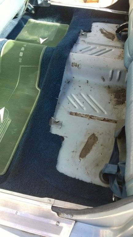

Today, I started the carpet cleanup process, together with the front bench seat that I found to be too dirty compared to the rest. Parked the car in front of a friend's home that is nicely equipped with the necessary cleaning devices.

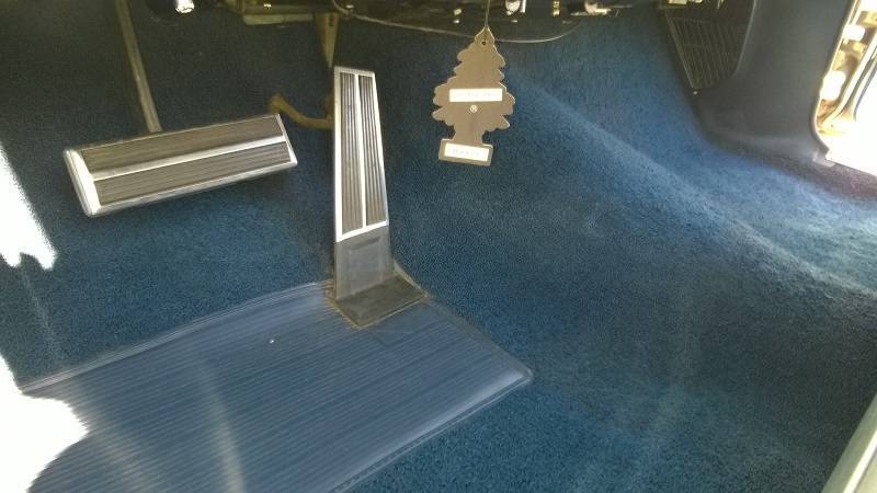

The carpet, despite a bit dirty in some places (not that visible), is in an unbelievably nice condition. This makes me think that the floor mats are original to the cars, and were there since day one. The pic below tells me that it never saw any shoe...
All doors open for the job.

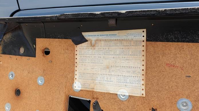

On the back, I removed the bench seat, and found the production order, already fully decoded. Sheet metal seems in perfect condition.
I also understand now those weird green floor mats. Discoloration! The underside that never saw any sun rays is... turquoise !!! I'm now planning to give them their original color. You notice also the zones of the carpets where I couldn't bring back the deep blue color.
Regarding the production order sheet, what I can see on the car matches the options. Nothing is missing. It got also a factory undercoating, which explains a lot the rust absence: zero rust. Nothing. Nowhere. Last week, I was able to put the car on lifts, and rust is nowhere. Even the wheel wells, fender skirt area, trunk, no rust, nothing. The mechanic who was with me was just speechless for a 51 year old car.

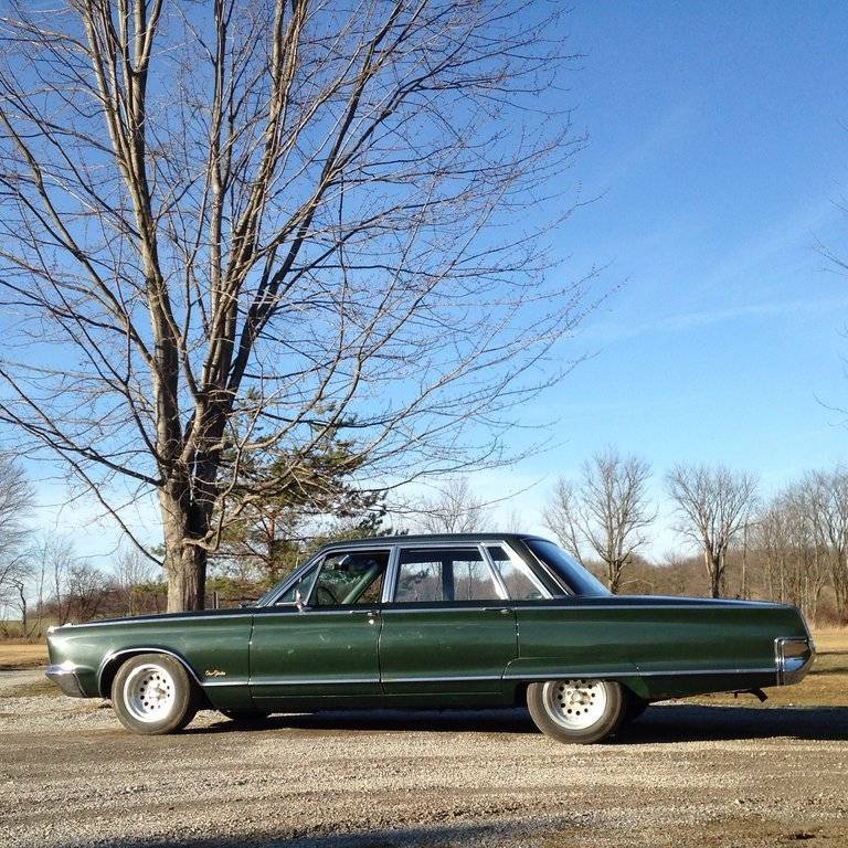

Really nice looking New Yorker! As for that original tire size. When those cars were around, in earlier times, that was a common tire size for many vehicles other than Chryslers per se. The last OEM application, I believe, was a 1974 Ford Torino wagon. The P225/75R-14 is the correct radial size, dimension-wise. I found some BFG Advantage TAs in P245/70R-14 that are an exact size/dimension match, too. But like the others, they aren't around anymore, either.
In about 2004, I found a '66 Newport at Mopar Nationals that had some Cooper TrendsetterSE P225/75R-14 whitewalls on it. They were correct in all ways, including the narrow tread width. But that was then an this is now, unfortunately.
There might still be some sources on P225/75R-14 whitewall radials, but you won't find any in the normal name brands at "normal" prices, BUT don't forget about the Korean/Asian brands. In order to move the '66 around, I got some P215/75R-14 radial whitewalls in a Korean brand. That's the 8.25x14 equivalent that was on the base Chrysler Newport without factory a/c.
I happened upon a '66 Chrysler wagon in the salvage yard years ago. Being a wagon, it had the 14x6.5" wheels on it. I put them with the P245/70R-14s on my '67 Newport CE23. Those thicker sidewalls (from back then) make washing the whitewalls on the rear wheels very tight, but they clear the leaf springs on the inside, although with less clearance. To me, those wheels were "a find" back then!
The main tires I've seen in the 8.55x14 equivalent have all been "repro" tires that cost around $200 USD each (whether radials or otherwise). Many have used the W23 road wheels (15x6) on that era Chrysler. That then uses the P225/75R-15 tire size, which looks pretty good on those cars AND is a factory Chrysler wheel. The '76 Charger Rallye Wheels (15x6.5) look pretty good on my '70 Monaco, too, but I believe 15x6s are available in repro.
On the front, the main clearance point is the outer tie rod end "boot" (seems to have been '66 only?). At one time, we had some Golden Sonic H78-14 whitewalls on the '66. A private brand made by UniRoyal, which were bias plies. They actually measured out to be right at a 70 series tire. Those, plus the later BFG Silvertown Belted H78-14s inner "rub strip" did make occasional contact with that boot, leaving a clean spot on the inner side wall. The '67 had no boots on it. Gobs of room between the tie rod end and the sidewall.

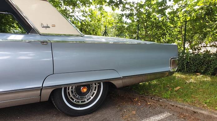

Thank you CBODY67 for the tire information. Highly appreciated. I do have indeed one hubcap that rotates in the wheel (rear right, easy to notice, the valve stem is acting as the "travel limiter" as you say), and I've noticed that depending on how I insert the hubcaps, they "click" when the car is in motion. Now I found a position where they don't click.

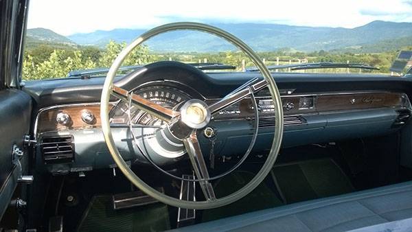

Will post nicer pictures once the car gets its new French license plates.
Gorgeous car, love that color!

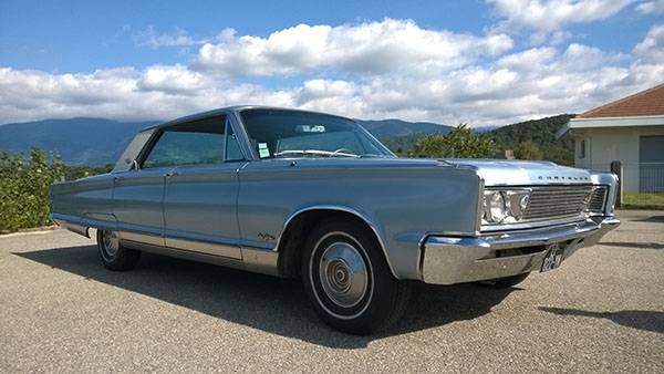

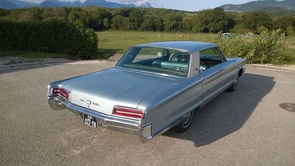

Time flies... But here are some better pics taken today.
Since last post, the car passed successfully the technical inspection and is now licensed/registered as a collector car (therefore the black plates, instead of white). I have removed the trailer hitch, as it would be useless.

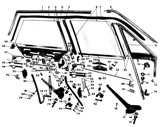

A few updates since 2017... I have since fixed the driver's door cylinder lock that wouldn't lock or unlock. Power door locks worked, but the key wouldn't do anything. After removing the door panel, it appears that a link was simply disconnected (part 38 in the below diagram).
When removing the door panel, I found the second broadcast sheet!

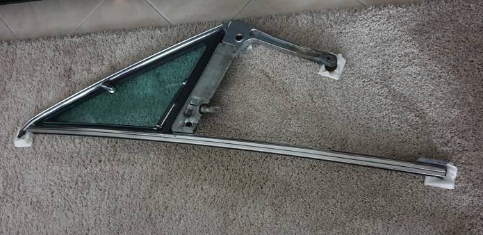

I also changed the vent window frame on the passenger's door, since the original one had a poor weatherstripping (one small section was destroyed) and the chrome wasn't that good. Now I have a perfect rubber and a much better chrome (not show though, but that's fine).

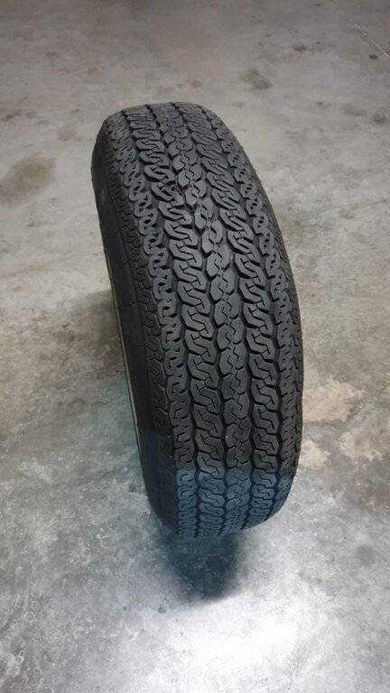

Finally, after an issue with an old tire on the highway, the car has now new shoes, rims and hubcaps. The hubcaps were found thanks to this forum! I will post later on some pictures comparing 225/75R15 (now), 225/75R14 (before) and 855x14 (original spare tire).
And here, a pic of the tire. What you see is the actual S shape after it suffered the failure (it became also oval). Apparently, the tread and/or belt failed and "disconnected" from the carcass.
