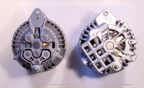

voltage regulator is probably stuck and is full fielding the alternator. here's a nice picture that i found showing the difference between single and dual field. single on the left which is what yours should be.

voltage regulator is probably stuck and is full fielding the alternator. here's a nice picture that i found showing the difference between single and dual field. single on the left which is what yours should be.View attachment 602347
Yes, the one on the right will always be a "dual field" or more correctly "isolated field" alternator. It's also known as the square back and desirable because it's easy to change the diode bridge.
I have to disagree on the one on the left as it can be had in both single and dual. In 1970 and 71, the dual field alternators had a "round back" case and 1972 up had the "square back".
That's OEM and not aftermarket... The aftermarket versions seem to be round back (FWIW).

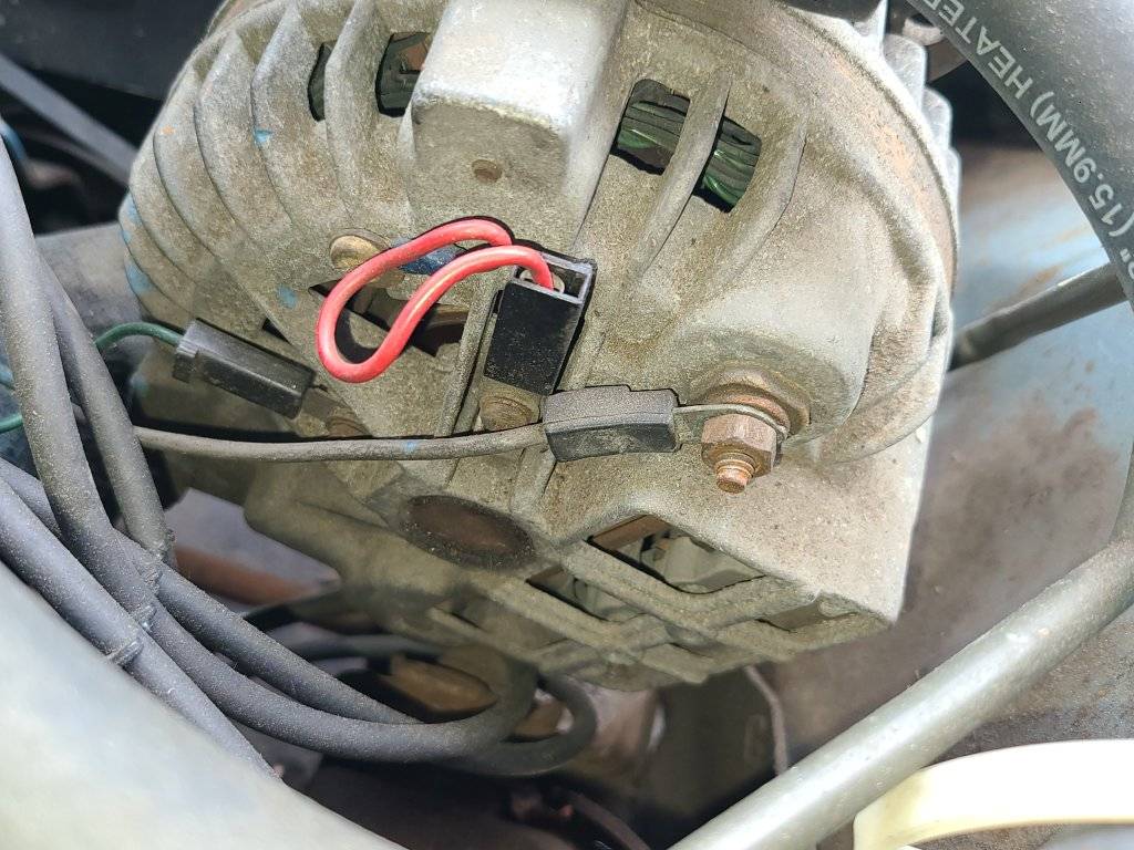

Yes, that is a "dual field" or isolated field alternator.
Note the red wire grounding out the second field connection. In a "single field" alternator, that end of the field is grounded internally.
