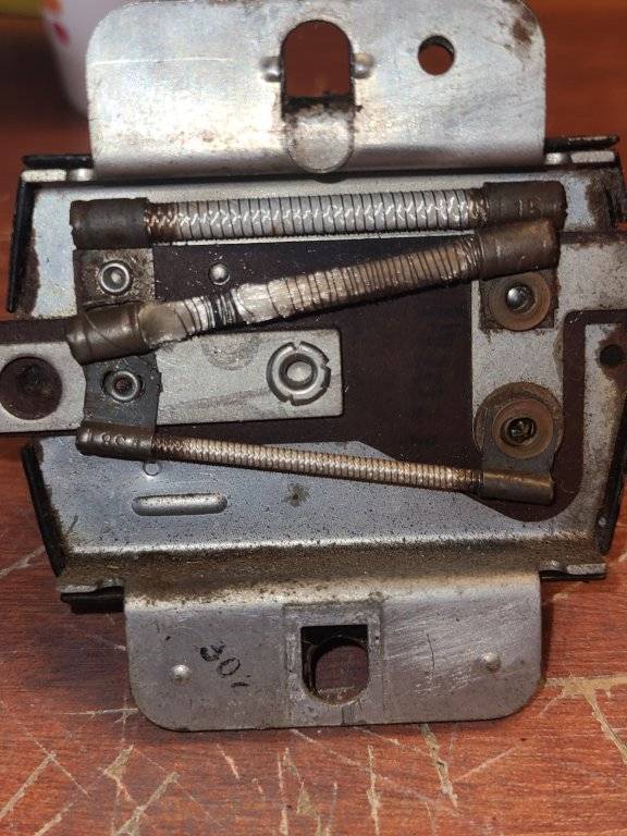

Just swapped out voltage regulator from FURYGT, perfect 14.3 charging. Here's the original one. Looks burned up? Thanks to all
And oh yeah, the ammeter did meltdown already last year, took the gas gauge and power supply out. Had to re-wire and add aftermarket gauges.
