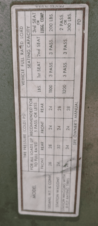

On the '66 Newport, the base tire pressure was 24psi, cold. At that inflation pressure, the car's weight should not overpower the tires' capacity. For normal 'round town driving, 24psi worked fine for many.
Further reading the owner's manual, if highway speeds would be encountered, then "+4 psi" to the base 24psi, for a total of 28psi. That resulted in a "loaded" tire pressure recommendation of 28psi frt/30psi rr.

And then, on the '66 C-body wagons, they went with a 22psi/32psi f/r pressure recommendation (for full rated load). More pressure in the back for heavier loads, less in the front so you wouldn't try to "road race", I suspect.
