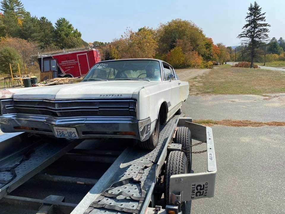

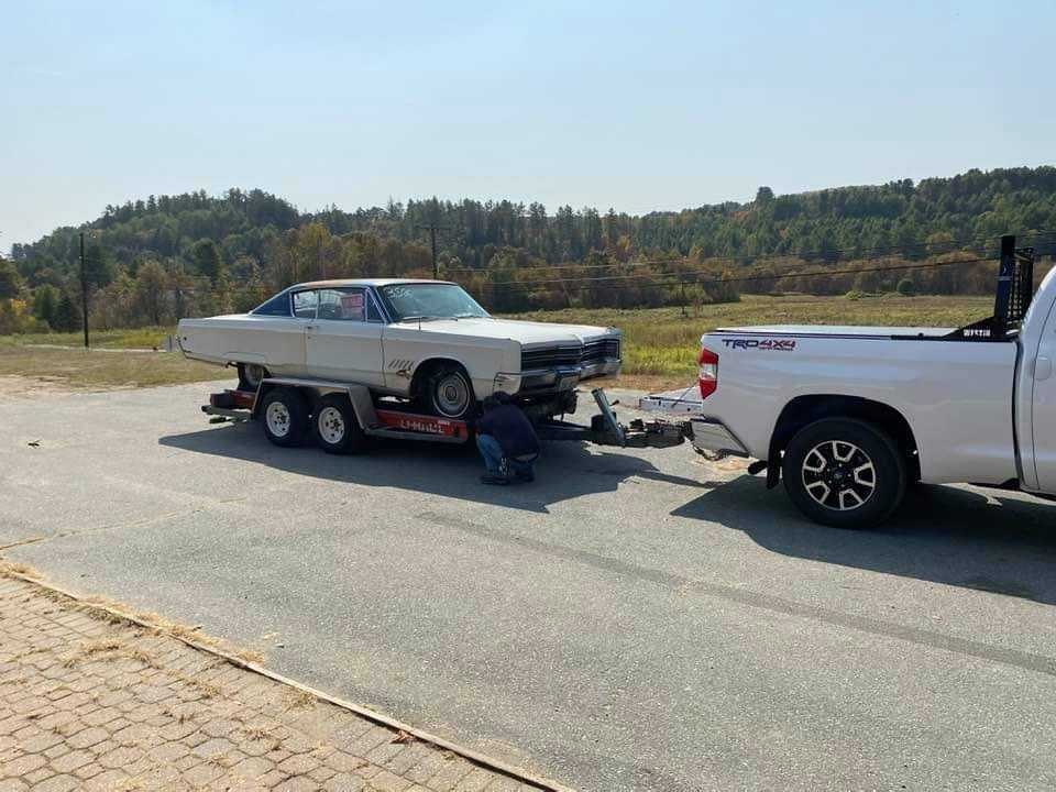

    I'm looking to sell one in the US that matches that description:

    I don't yet. I'm waiting until the snow melts to post it. It's stuck in the snow behind my garage. I bought it for the front end because it's pretty solid. The only rot is in the trunk. Runs, drives, stops. The only thing stopping it from being a driver is it needs a windshield, a brake check, an accelerator pump, an interior, and some tinkering with the headlight door motor.
