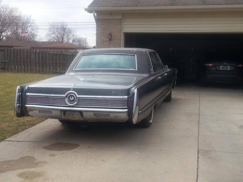

She has been moved, I drove her out of the warehouse yesterday. Drives great. Stalls at idle if let to idle too long. A valve adjustment and a complete tune-up will take care of that. Unfortunately I did discover a rather major problem though. On the way home I filled her up with a fresh tank of fuel. The tank leaks like a seive. Does anyone know of a good source for a replacement tank?
Don't count on needing a new tank. If you truly "filled up", you're relying on 45 year old rubber gaskets at both the sending unit (unlikely because usually not disturbed) and the gas cap (likely). You'd be surprised what can slosh out on acceleration. My car came with a gas cap from a Pinto or something, and the gasket was long gone.
I don't think you'll find a replacement tank for the Imp, at least not an exact match. I can't remember if and what the difference is between a tank for a C body or if they even reproduce a C body tank? You can have the original cleaned out and lined but it ain't cheap. I've got a leaky sending unit gasket and I've had a hard time getting it sealed since putting a new sending unit in it. I need to mess with it before the season starts. It's driving me crazy that we haven't gotten any rain in weeks and the roads are still caked with now powdered salt.
I'm guessing since nowhere on that site does it say that there tanks are made in the USA that they are not so I'd invest that money in your original and have it lined. You should be running something in your fuel to counteract the ethanol anyway but having a liner installed in your tank will also be another line of defense against it.
You can always call them....
They are always at Carlisle and offer a 10% discount at the show.
That was my first thought a well. until I lost about 17 gallons out of the 24 gallon tank. But I am going to pull it either way and find thew culprit.

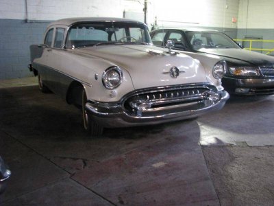

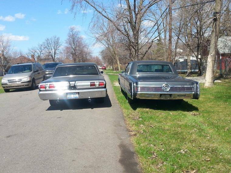

It has been tough finding time to get o the fuel leak. But we did get her out a bit along with her "little" sister 66 fury to make room in the driveway to replace a fuel pump on the 56 Olds 88.zzz.jpg

I couldnt agree more. Leak or not, still drove her. She just feels right. I was doing 45 down Pelham and it felt like I was going 25 because it was so smooth and Pelham Rd is a mess. GREAT car.
