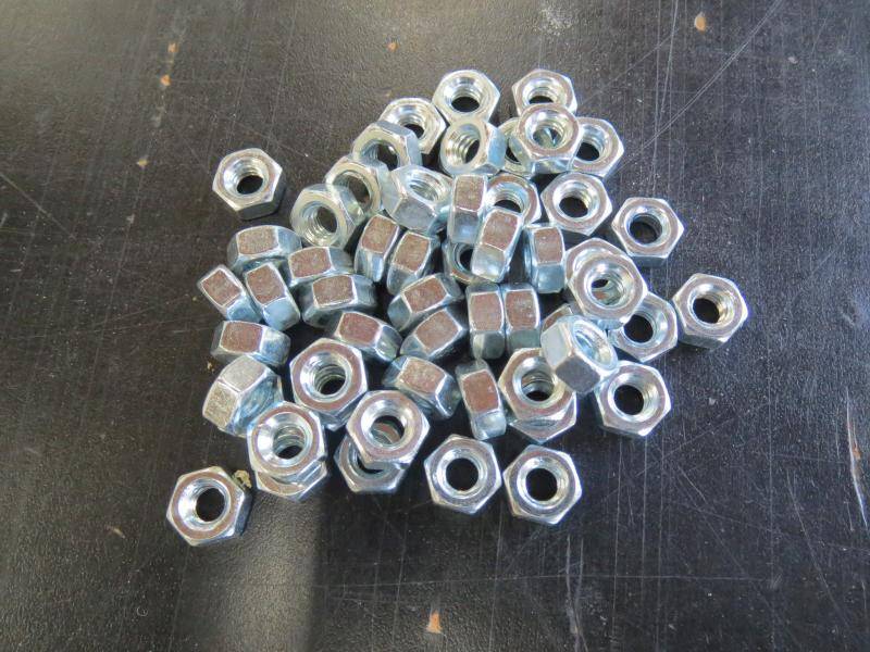

The drive gear is mounted to a rubber puck that acts as a shock absorber when the glass hits the full up or down position. This puck deteriorates over time and eventually crumbles apart. It's fixable though so if your glass doesn't move but you can still hear the motor working it's an easy repair.
Does this drive gear repair improve the long-term reliability? (fixable by either replacing with 3 nuts OR the fuel lines wrapped in fuel hose trick listed elsewhere on this site)
What goes wrong with the motors? Brushes? Electric motors typically do not fail.
I think most issues with the electric motors themselves would be corrosion that might be consistent with moisture and lack of use. The nuts are a permanent fix for the drive gear and I haven't seen the tube/hose combo before.
