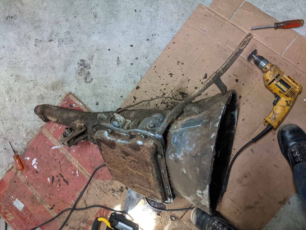

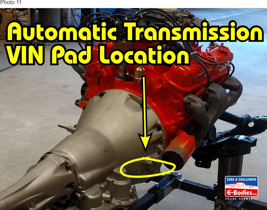

I have a 1971 727 BB trans. I can read all the left side oil rail numbers. I think the VIN last 8 digits is supposed to be right side near the oil fill tube. Does anyone have a picture for where it is located. Having trouble finding it. Should be same for 1969 thru 1971 maybe later too.

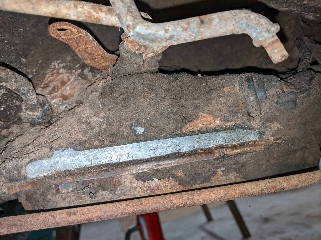

Left side
· Trans Marking Left side oil pan rail, PK 3515847 3259 4911. PK Kokomo? 3515847 part # correct for Plymouth 440 4BBL 335hp. 3259= June 20, 1970. 4911 unit built that day at Kokomo
