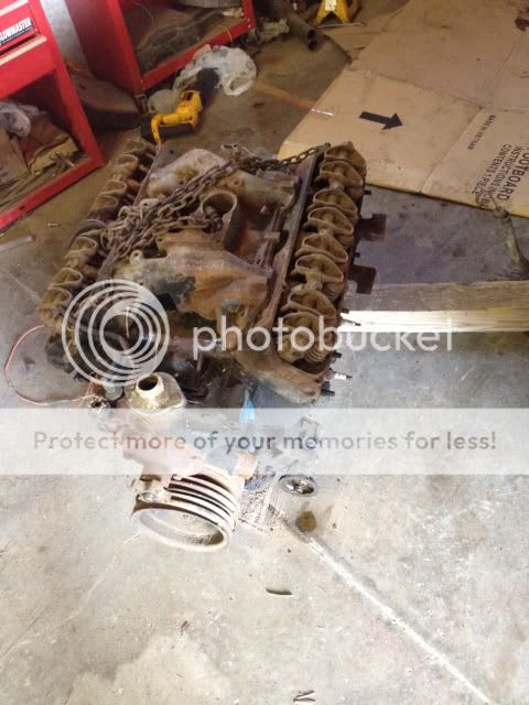

In lieu of replacing the engine, It was rebuilt. It had been pulled apart for whatever reason when the car was parked in 1978, and was rusted together like you wouldn't believe. It looked like this when I pulled it:

Looks good Zed...glad you've finally been able to get some work done. SO what did they end up doing to the motor during the rebuild?
Well like I said - for whatever reason, the car was parked in 1978; two years after the state sold it at auction.
The intake manifold, valley pan and valve covers were all loose on the engine. The car sat outside from 1978 until about 2008.
As you can imagine, the elements were not nice.
The block and everything inside was about ten hellish levels of seized rusty awefulness.
The machine shop was finally able to tear it apart after sitting in a hot tank for three weeks. Everything was replaced to as close to stock specs as possible.
The block, intake manifold, oil pan and valve covers were saved. Everything else was replaced with its oem equivalent.
It is a numbers matching 400 High Performance engine, which I was very close to just replacing. But, upon discovering the transmission was original to the car as well (and had been rebuilt just prior to the car being parked) I decided to rebuild the engine.

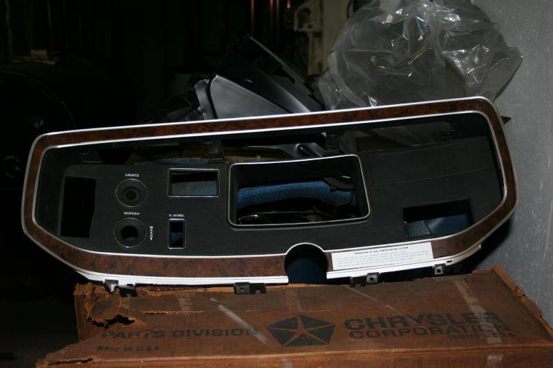

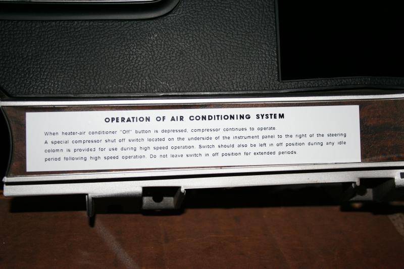

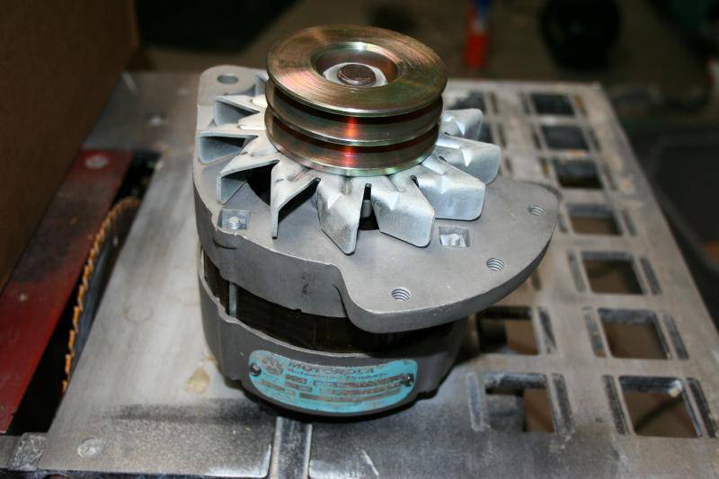

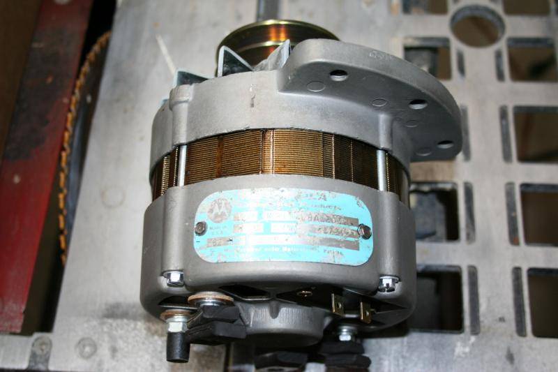

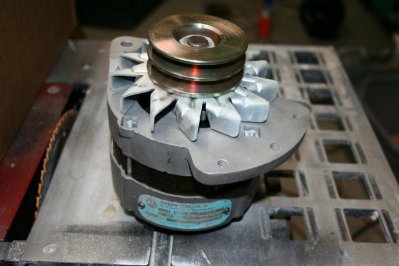

Thanks for posting the updates, I'm very interested in this project. I think you could pry the Titanic off the ocean floor with that alternator bracket, I'm missing the one I need for my car. Is there an A/C shut off instruction decal anywhere on the dash? Good luck and keep posting photo's.
I don't get the toggle? doesn't the regular AC switch turn off the AC?
CHP just printed the switch panel with instructions/warnings for the AC

Really cool resto! Do you have any part numbers on the alternator? Polarus & Alan my car has a ac shut of toggle switch on the dash, and operating instructions (no decal on dash) on when to kick it off, printed from the Colorado State Police.
Joey
Polarus: no instructions for the AC Shutoff. The few interior pictures I've seen dont show any either.
72fury: 2642411 is the mopar part number for the alternator w/ a/c & w/ 400 or 440. I'd have to check the tag for the leece neville number
Alan: I really don't get the point behind the AC Shutoff switch either, other than maybe it was faster to just flip that switch to kill the compressor, but keep the blower running than it would have been to slide the control where you needed it.

2642411 should be a Leece Neville 7020AA (that I need). I would say any special instructions for the AC would have been done by the agency and would be unique to them.

Here are some photo's, I had a sign shop recreate the A/C decal that was on the original dash bezel. Alternator is the original from my parts car, 62 amp. Motorola. Mopar offered a lot of options considering these were fleet cars.cbody 001.jpgcbody 003.jpgcbody 004.jpgcbody 005.jpg

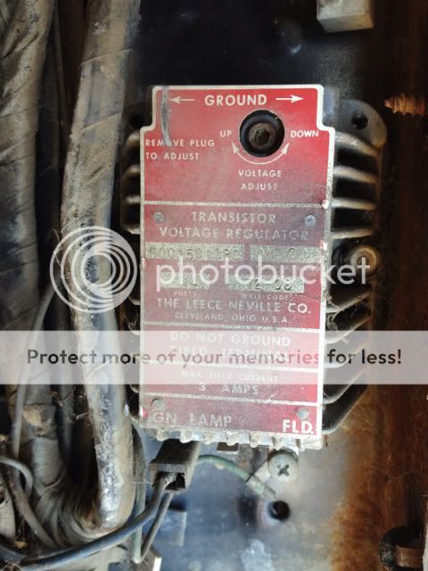

Nice bezel - very neat sticker! I might make one up for mine now that I've seen that. Was it factory or an agency sticker? That Motorola alt can't be easy to find. Did it still use the separate leece neville 5013 voltage regulator?

Hi Zed, contact Bill and Rose Evans (814) 864-2622 or www.evanswiring.com. They can rebuild an old harness. I believe he decal was done by the agency, as the one's on the C.H.P. cars are different. My car does not have a separate voltage regulator, I'm not sure why, I guess it has to do with the smaller alternator, this also affects what size fusible link (from pos. battery to harness) the vehicle uses. Check your parts book, if you don't have one buy one they're invaluable.
