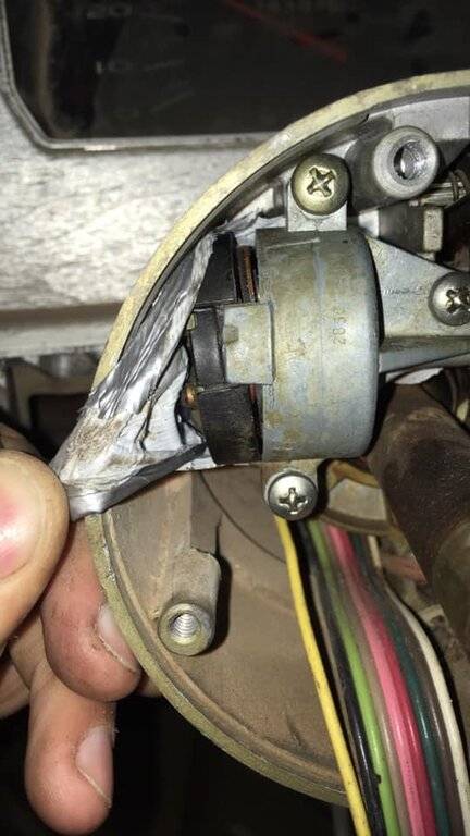

I am sorry for that......checked all wires and bridged just to get close to this bad broken boy.......fixed that by bendind a little the brackets inside.....holds properly now but gonna watch it closely and might replace anyways.
I am sorry again.
Yes, I see. The ignition switch needs work or needs to be replaced. Good work!

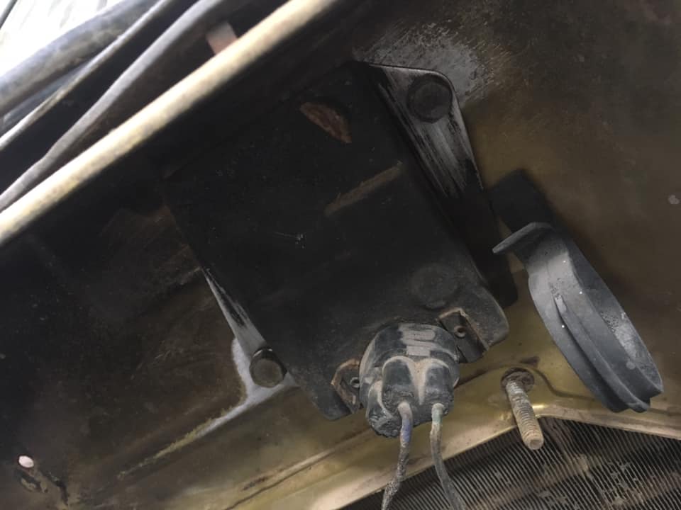

So i checked the wires today and it seems to be okay . Didn’t do the voltage reg test with bringing because of fear of destroying other things . I saw a new one is just 25$ and if all wires and alternator are fine it kinda must be a broken reg right ? So just replace it and see if it works would be my further guess :)
Alright just to make sure.......the voltage reg is grounded by the housing on the chassis right? Or through one of the two cables and through the integrated alternator ground? Kinda got the feeling theres just a ground issues going on...
That is correct. Grounded to through the housing to the metal underneath it.
Hey John I did the Test and found a good grounding I guess right on the chassis firewall blank metal . Checked the grounding properly . The colts of the battery didn’t change from 12,6volts. Switched the field wires even and tried again but nothing happened. The alternator is a brand new acdelco so For me it’s very tough to believe it came broken . Can I check the alternator in a different way somehow ? I still think the reg or the wiring is broken and wrong connected in between but I can’t really figure it out . It starts to get frustrating a tiny bit......
I don't know of a good way to test the alternator without taking it apart and doing some basic checks. Since it is a new one, I would really expect it to work. If you were in the states, most of the auto chain stores can do a test where they spin it and test output. I don't know if you have that type of thing where you are.
