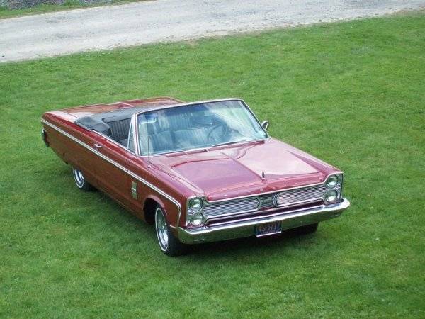

Hello - wondering if anybody knows where you can purchase replacement ball joint seals (both lower and upper) for a 66 Fury? I don't need to replace the entire ball joint, just the seals. Appreciate any suggestions, thanks.

With all you have to remove to replace the seal, I would replace the whole ball joint. Man that Fury is just to pretty to take a chance.
