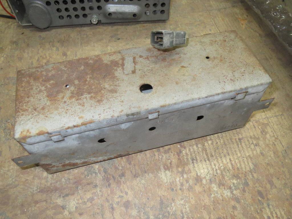

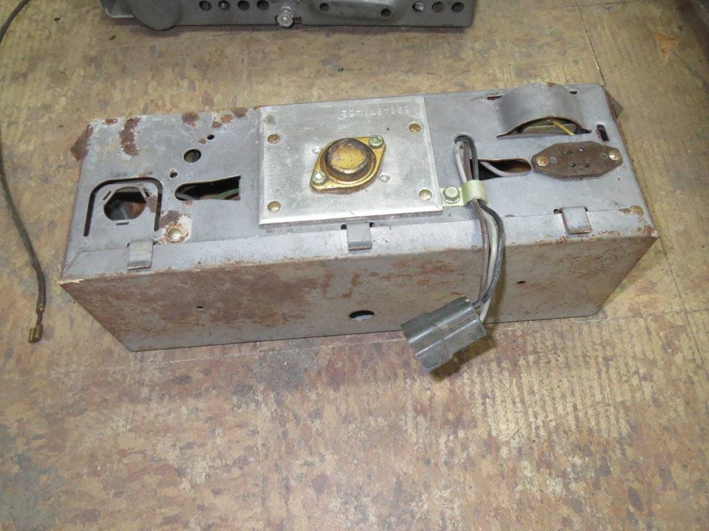

    And here’s what the unit that lives in the trunk looks like.
