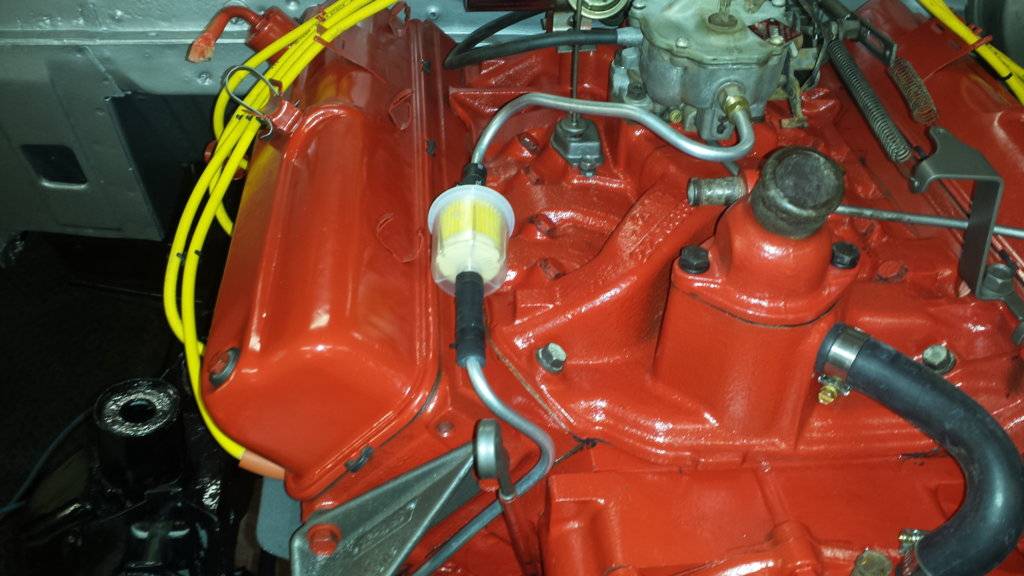

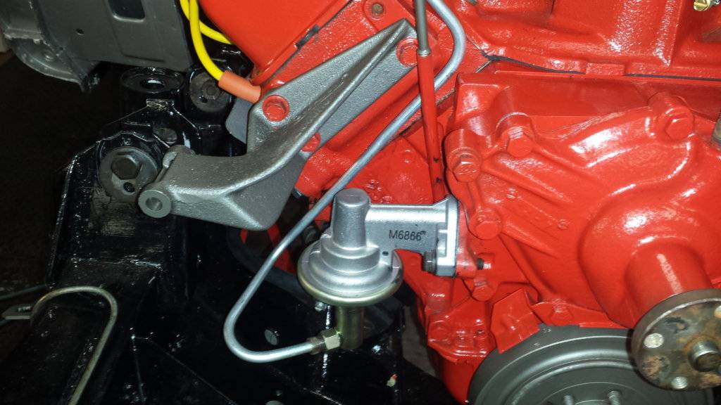

View attachment 243600 View attachment 243601
I must take back my malicious and erroneous attack about fuel filters "out of place above the engine". Clearly, mr. fix. it has schooled me regarding proper appearance on engines that I'm not familiar with. His pictures are friggin' OUTSTANDING.

Thanks for your compliments :p
CBODY67 is correct in his comments with the BB &RB engines on the fuel filter location.
Mine a Poly 318 and this is where the filter is located for my application which is much easier to change than the lower location IMHO.
Metal filters? yes they are likely superior in less chance of a fire. I used the clear type to make sure I had ample flow and ease of viewing the contents for debris.

I prefer the clear filter on top. When the fuel system is working correctly it's about 1/2 full of gas. When empty it's obvious why the car won't start. Either out of gas or pump issues. Very handy when you're sitting on the side of the road worrying about a trooper showing up to tow your car away.
