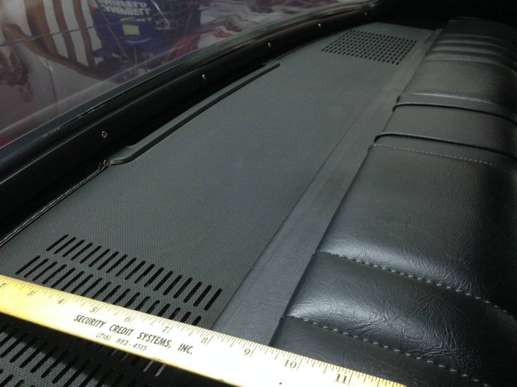

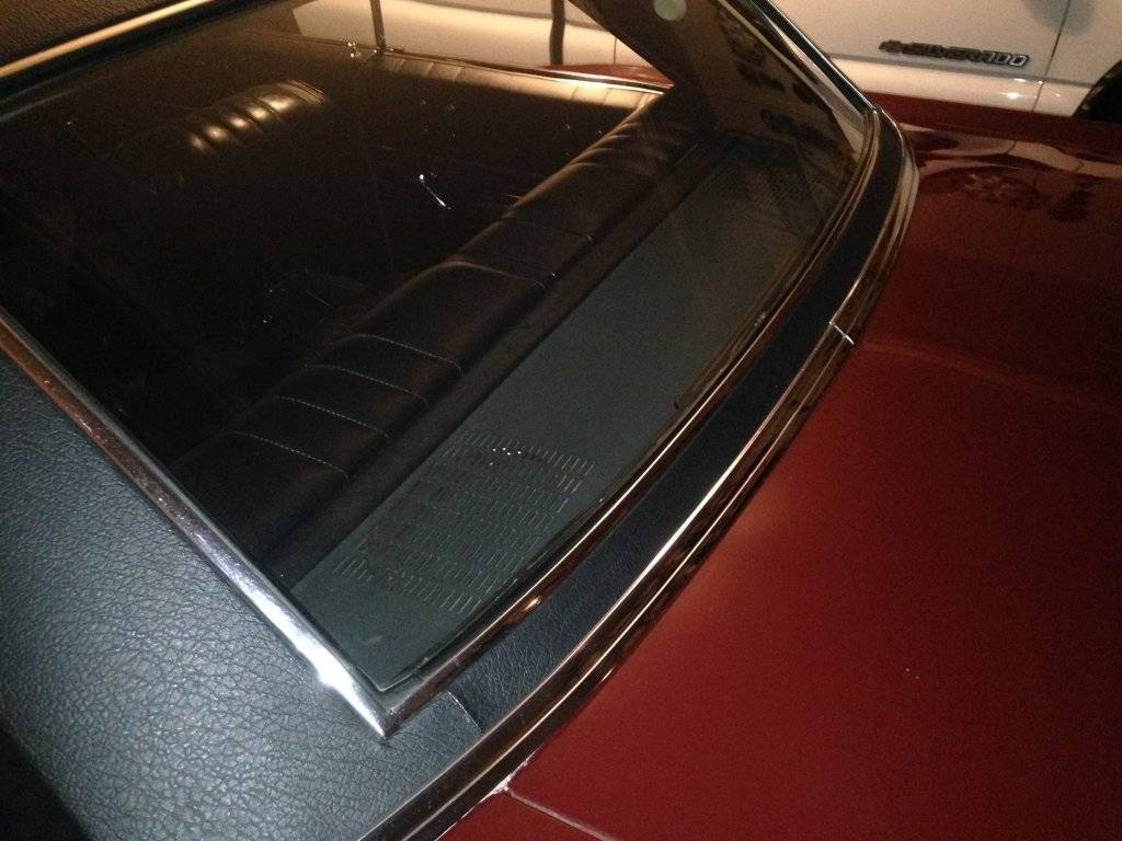

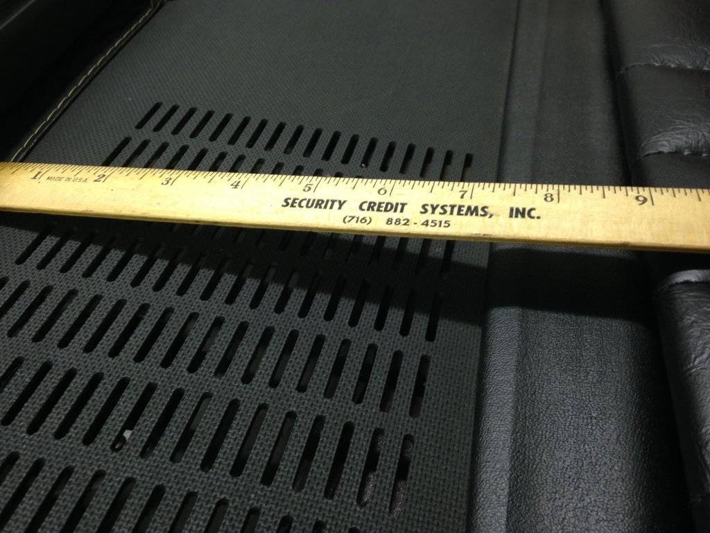

Yes, the 67-68 Fury III's had the fastback roof...many more were fastbacks in 68 if I remember correctly. I currently own a 68 Fury III hardtop (not the fastback), photos below. I use to own a 68 Monaco 500 but don't have any photos its package try...sorry.

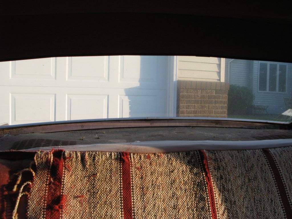

Meanwhile I did find a picture of my original before I tore it out. I took a lot of pics during dis-assembly, but it seems I can never find the right ones.

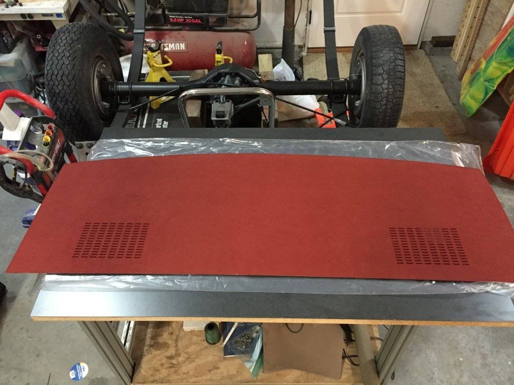

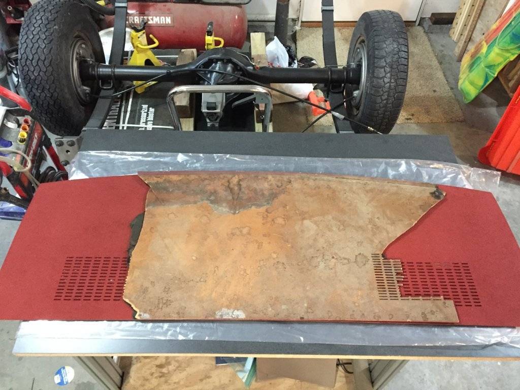

Received my package tray today, looks great. As someone commented earlier it is from REM. Depth looks perfect. Color? It perfectly matches the seat vinyl samples, but for some reason I seem to remember it being a darker maroon, ( must have been sun fading and a fading memory from over 30 years ago). The only thing I noticed is that the speaker cutouts are further away from the center on new one vs the old. Again I will blame it on being the first month of 68 build, so maybe my original package tray is from 67. Looking at pictures of my speaker cutouts, maybe speakers wouldn't have matched the cutouts in the original (The AM radio only had one speaker in the front). Also based on my tear down pictures, I believe there was a vinyl trim stitched on the edge. The edge was so deteriorated that only the vinyl remnants remained. And yes my plastic parts are dry rotted. (anyone have seat hinge covers for a split back front seat)
Here are pics.
